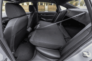

Can 3-seat rear bench from Civic hatchback be fitted to FL5?

Go to car-part.com and search for 2022+ Civic rear seat. It searches a database of parts recyclers. Find a good listing and be sure it distinguishes between sedan and hatchback - most do - and then contact/buy. My brother flips vehicles and has bought tons of crap on there. Usually prices are as good as you'll find online, basically equal to pick-n-pull. The only catch is shipping is usually way more expensive so you want to find something close enough to drive to.
It seems like Fenix Parts has been buying up pick-n-pulls everywhere, or otherwise partnering with them to get them onto this database. I placed the order then a guy called me to confirm, texted me a link to pay. Once they pulled the parts and verified their condition they charged me and told me to come pick up. They even transferred the parts from where the donor car was to the closest Fenix location to me. It would have been crazy smooth all-around had I driven out to pick up 1 day sooner...

Only if you won't need the center seat belt. Need the hatchback seat backs for that.
Not sure what the seatbelt difference is--does the hatchback have a built-in seatbelt? I figured any rear seat swap would require purchase of seatbelt parts from Honda.

Yes the hatchback has the center seat belt inside the 60% side seat back. In the sedan the belt comes out of the rear shelf, no way to carry that over to the hatch. It's tough because a vast majority of what's out there is for sedan of course.

I did the conversion tonight. An easy job, still not done because the rear passenger side buckle receptacles I bought off eBay must be for sedan and the center buckle doesn't latch in. Thankfully figured it out before installing the buckles. Will order new from dealer tomorrow.
This whole project was cursed. The belt buckle thing was the last kick in the dick.
First the fiasco getting the parts from the recycler. Almost 10 hours total driving between the two trips I made to them - nobody was there for the first since everyone went home due to IT issues. Then some random guy held my seats hostage when he mistakenly took them and didn't want to come back until they had his correct seats (I get it.) The trim piece where the belt comes out of the seatback was missing, $40. The seats were filthy but fortunately cleaned up like new pretty easy (steam vac thing) save for the air freshener smell. Turns out the previous owner was a big air freshener enthusiast, dear God I hope it wears off.

I'm actually doing this conversion. I just received all the parts from a donor 2022 CIvic Hatchback that was totaled. The local parts recycler gave me everything(bottom cushion, R&L seatbacks, all the buckles and anchors for $225 shipped!
The process looks pretty straightforward. I could care less about insurance. The car was built for 5 passengers, and 90% of the time, it would only be 4 passengers or less, so don't get your panties in a bunch! ?
I also bought the rear vent kit so my kids don't die from the heat on warm days! Yup, I'm a good parent!
