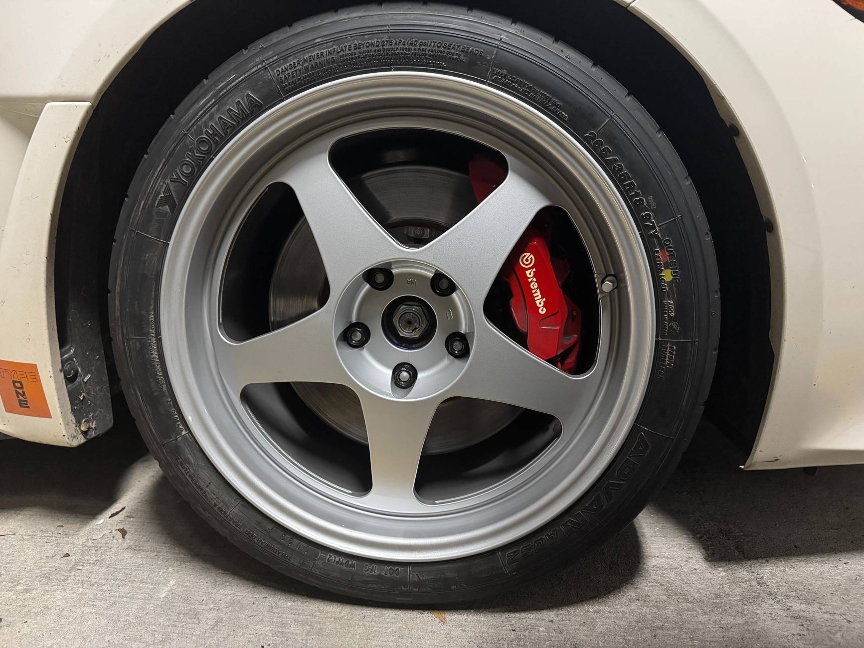

Last Track Days with the A052's
My last two track days went extremely well, caught up with old friends, and had a ton of seat team at my two local tracks. So much in fact that I corded the front tires on my last sessions at Homestead Miami Speedway, obviously no personal best lap times were achieved.
Since then I recently picked up a set of the Nankang CR-S tires in a 275 35 18. A lot of people have been saying good things about the tires so might as well give them a try.
Enjoy the following wheel pics and POV track vides!

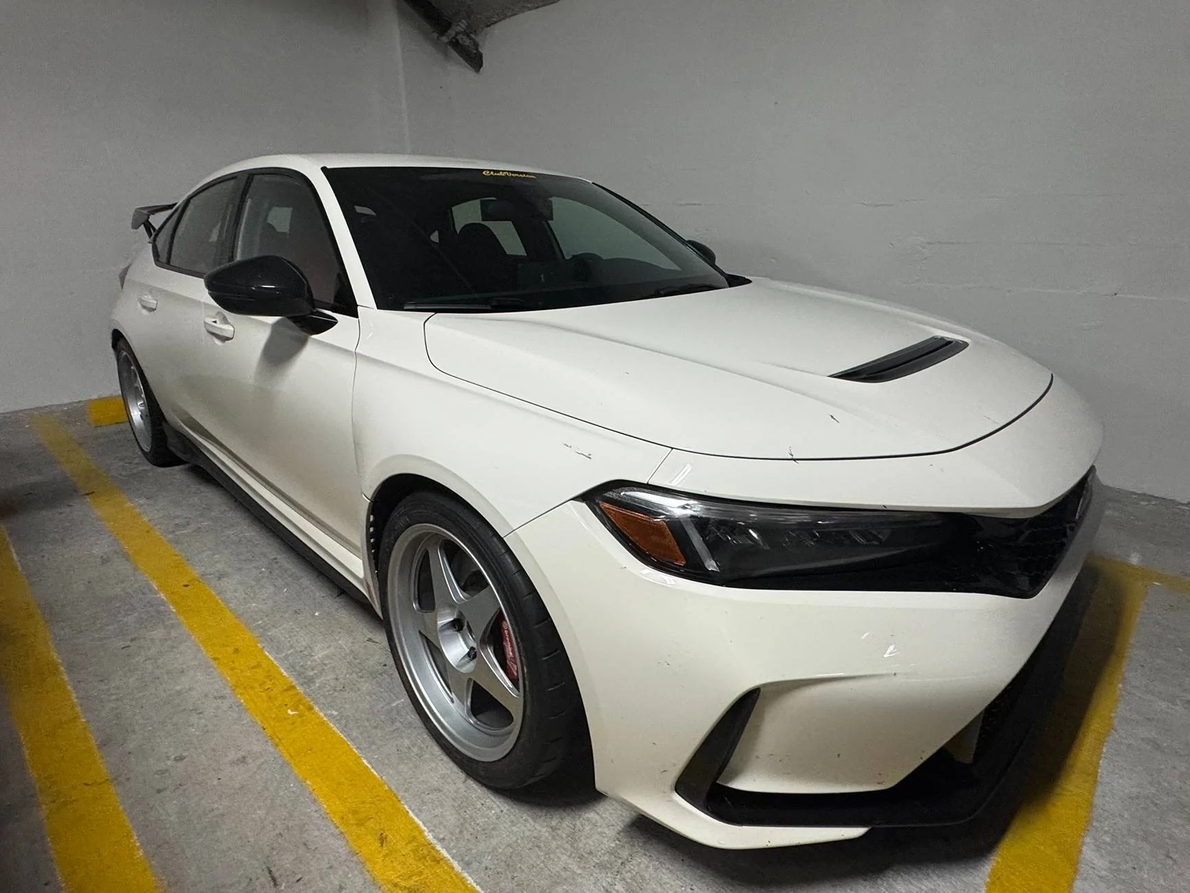

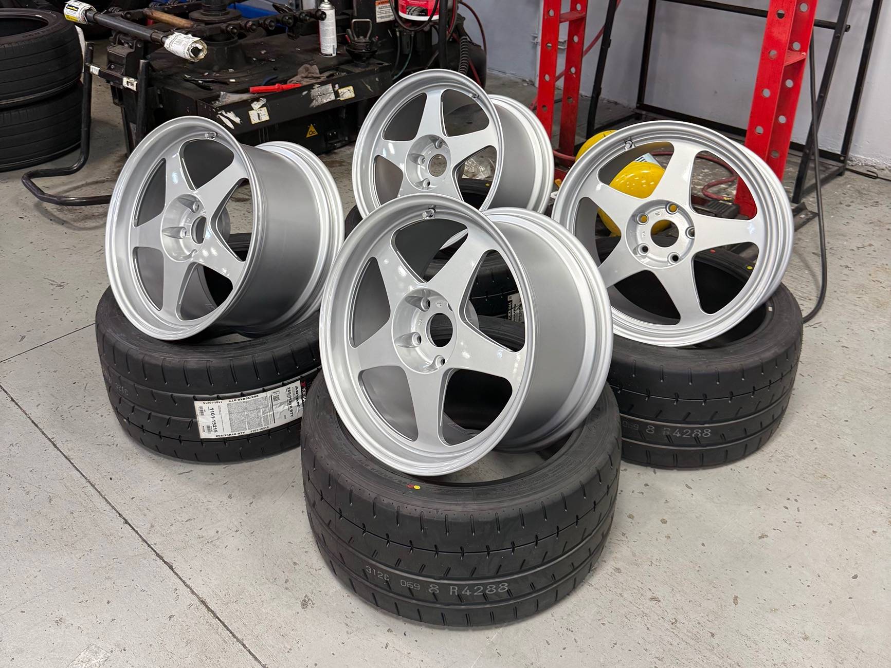

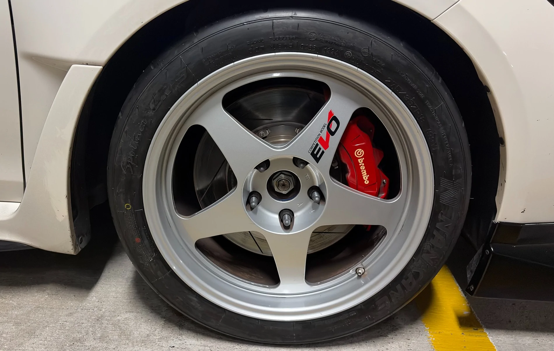

After about six-months of waiting I finally received my dream wheel setup from Matt at ICB. Ever since the re-release of the Regamaster EVO II came out for the FK8 I've always wanted a set. I ordered the lesser known size of 18x10 +50 so that the A052 265 35 R18 tires will have a tight fitment on the rim and provide the best possible turn-in feel.
After a few highway on-way ramp pulls (up to the speed limit of course) I can confidently say these wheels make a huge difference in overall feel. The car feels much more direct and responsive to my inputs and with the taller side wall it helps smooths out the small imperfections on the road. In addition, per my rough estimates the wheels are saving me about 40lbs of unsprung mass. Hopefully the weight savings and more direct feel will lead to lower lap-times once the temps are more favorable.
