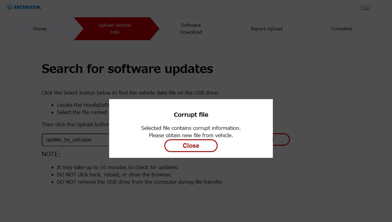

Mine is still showing that I have a corrupted json file? My car is a March 2025 build and the audio version is also 77CA-0068-121
donno if you wanna try to modify that file to see if that fixes it.. i have had 0 luck with that site, but mine is apparently up to date as of may 20th.
Heres what i found -
So i used a different drive and the corrupt file did not have my VIN after the deviceID. But i am getting the connection error with the proper one.. This was failing on a 256GB drive partitioned to only a 30GB Fat32 partition - the rest was empty (no volume made). A 16gb flash drive with no partitions only formatted to FAT32 looks to get the right data.
{"deviceData":{"deviceID": "VIN GOES HERE"
This was with the non-corrupt file
https://www.civicxi.com/forum/threads/spying-on-you.53757/page-12#post-1054616

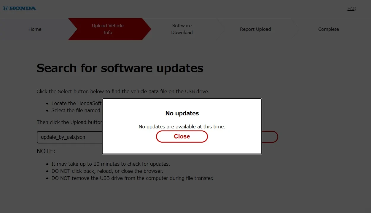

Filling in the VIN worked - Thanks for that! I'm getting an "No updates" message now.
Edit: I was using a 32GB drive formatted to FAT32 and the VIN data was missing. I'll try to find a 16GB drive next time to see if all the fields get filled in properly.

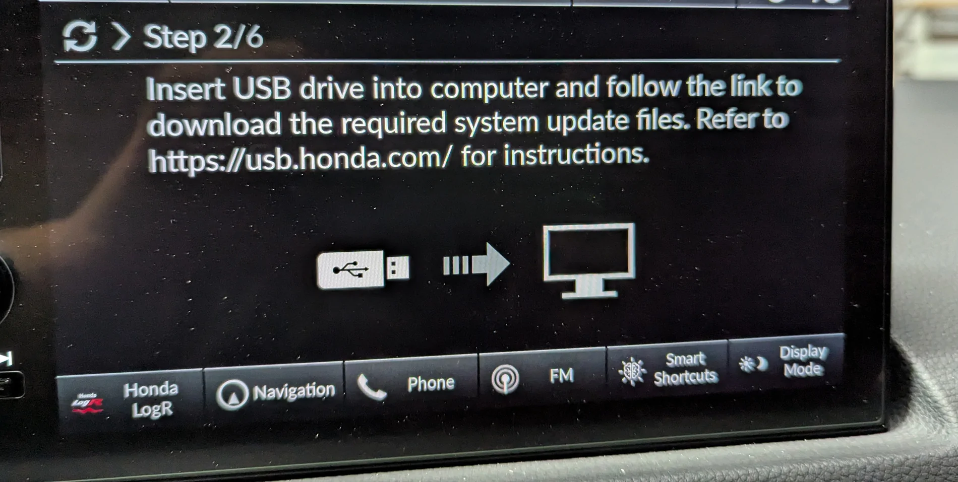

Well, I guess I'll try to check via the USB site again. How long is it supposed to take to download the vehicle info to the USB? I sat in the car for about 20 minutes and it never said it completed downloading. There was a file on the USB (which had the correct space and formatting), but I wasn't able to upload it. I tried with 2 different drives, same thing.
I did factory reset the infotainment, but that didn't bring the update back.
It should not take more than 30 seconds to get to step 2 as shown in the screen shot below.

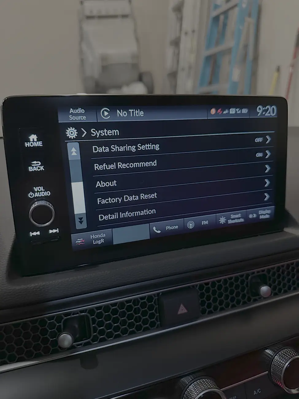

BTW, how did you do a factory reset the infotainment?
Yeah I never made it to step 2.
The factory reset is under system settings.

So I just tried the USB method again with a different drive and was able to download the file. The USB site said there's no updates. So I guess the version number doesn't actually correspond to the software version? Strange.
