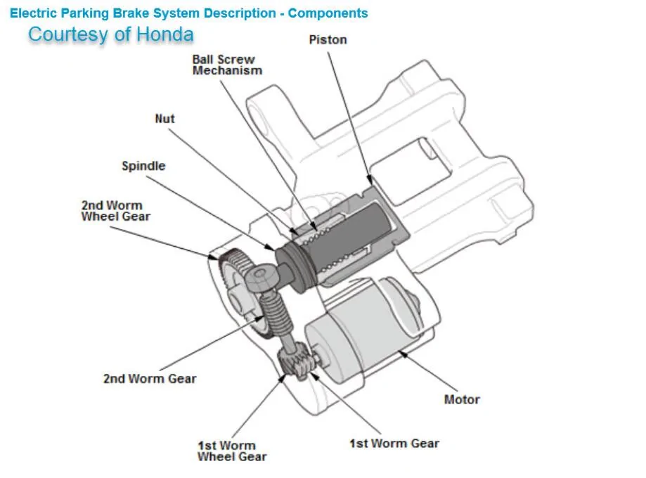

Why can't someone just turn the piston to retract it back into the caliper?

@svvitch it can break the worm gears or electric motor if you did that. You still have to turn the piston to retract it back into the caliper but you have to either remove or retract the electronic bits first.
This is not the best image but kind of shows you whats going on and the things you could break.
This is still not the best image but kind of shows you whats going on and the things you could break.
Thanks for the diagram. I don't normally set the ebrake when I do this I will need to check into the manual process 👍
