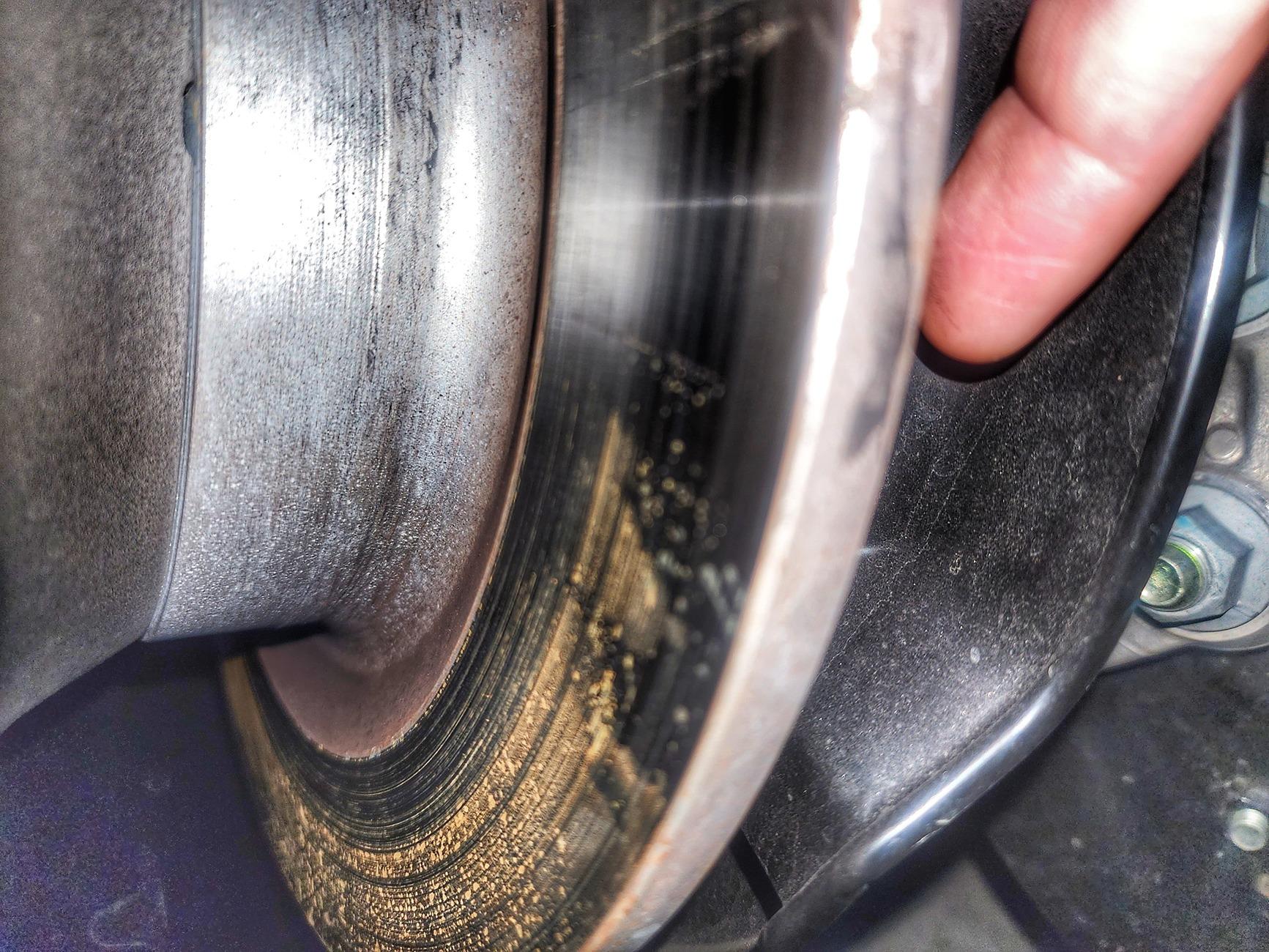

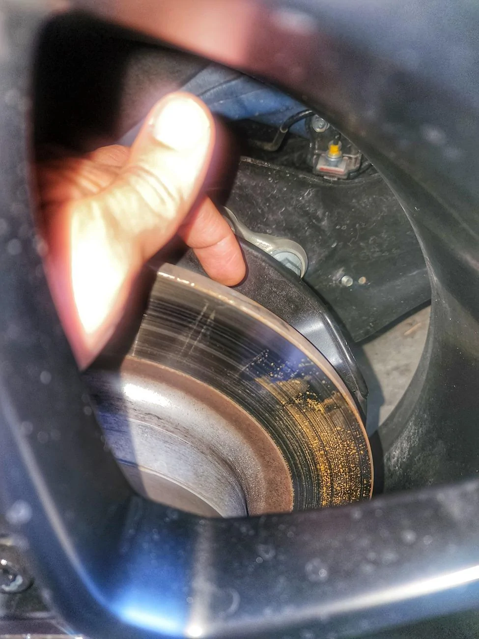

I sanded the pads, was too lazy to remove rotors and hone them but maybe I will have to do it if next day I get crazy shaking again.
You dont need to take out the rotors. Just turn it (rotate) and sand in to out one spot at a time. It worked for me.
what about the back? isnt the heat shield in the way?

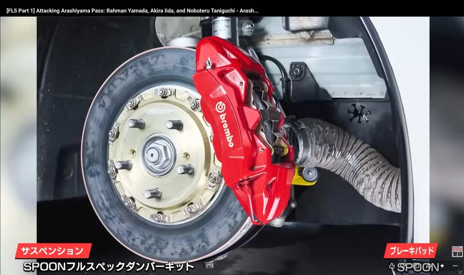

Anyone create a brake duct like spoon?
11th Gen Honda Civic Lets talk brake pads Screenshot 2026-07-04 at 7.56.33 PM

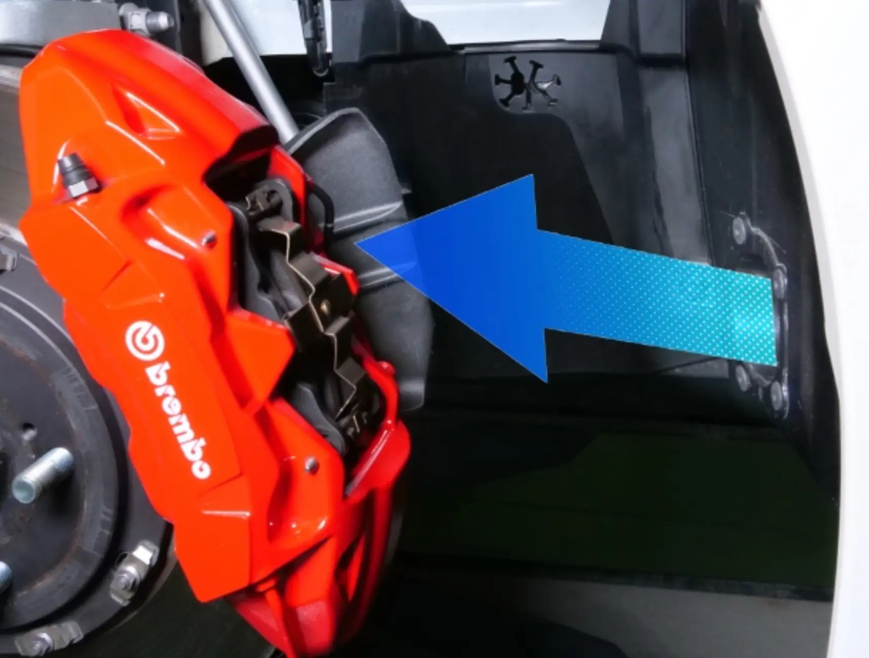

Anyone know the exact size of the factory brake duct? Is it 2.5 inches?
11th Gen Honda Civic Lets talk brake pads Screenshot 2026-07-04 at 8.29.48 PM

ID on the front hole on the wheel liner is 3". I did not install a duct but have been using the larger Cusco scoop in this thread where there was minor interference after initially installing. No issues since the part was "broken in."
