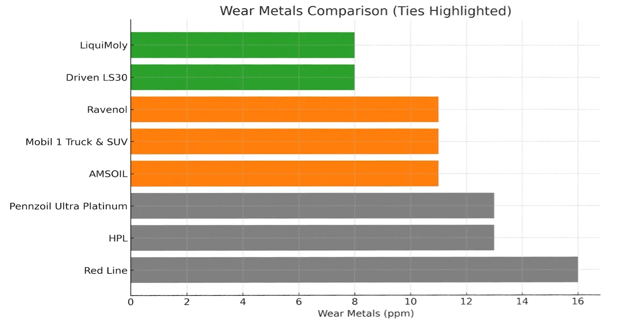

Given that they're able to have more ZDDP because they don't cave to Big Oil™, surely they did well on the wear metals at least? No. Lost out to an oil with ~20% less Zinc/Phosphorous (838/620 on Liqui Moly vs 1010/752 on Amsoil)

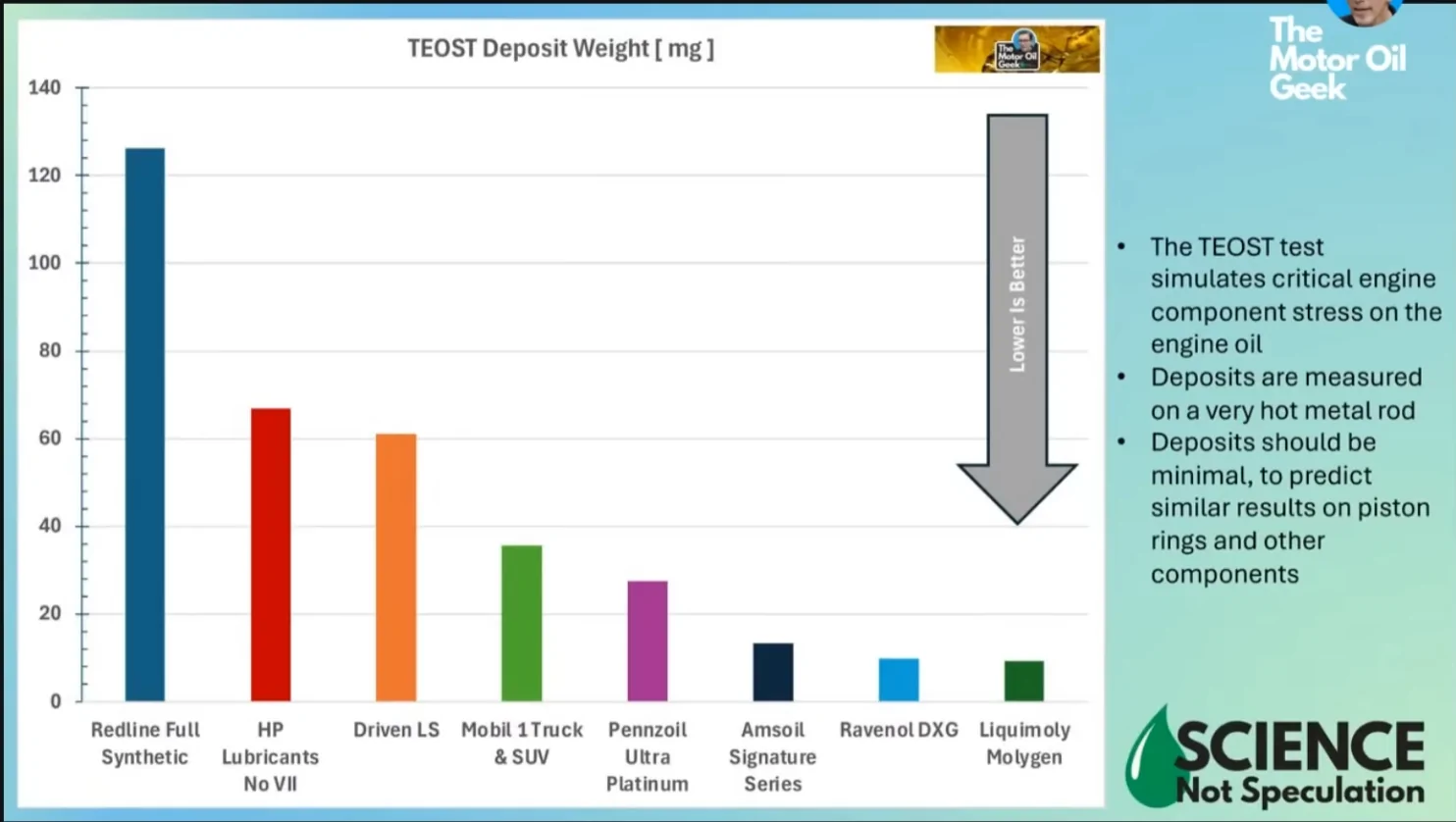

SS has impressive TEOST results:

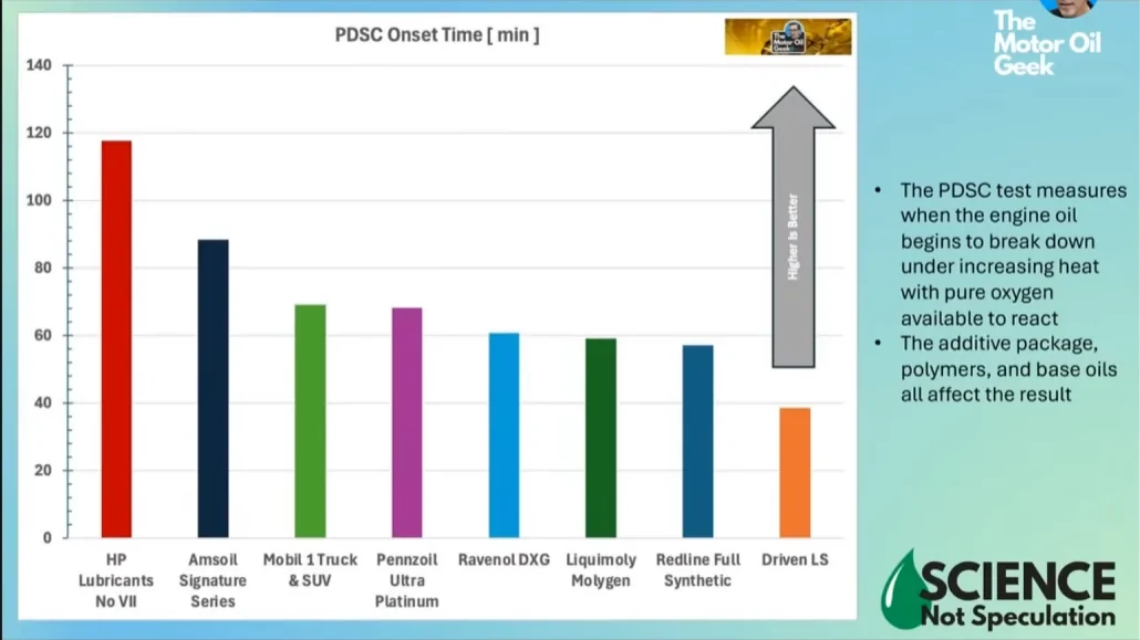

Oxidation resistance is quite good :
11th Gen Honda Civic Eneos oil.. 1775753193398-4l
Notice how HPL had much worse TEOST results and is the only one with better PDSC onset time. This is an interesting result if you want to run higher drain intervals in a TDI engine like the K20C, but want deposits to be kept under control.

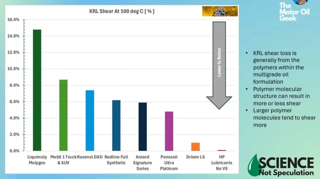

Shear resistance is quite good (Driven had very low PDSC, HPL had bad TEOST, PUP is a good overall oil):
11th Gen Honda Civic Eneos oil.. 1775753235667-8u
Each of these oils have strengths and weaknesses, which is awesome to be able to see. Amsoil SS does not out perform in every category, it just does pretty good across the board and has an interesting balance of performance.

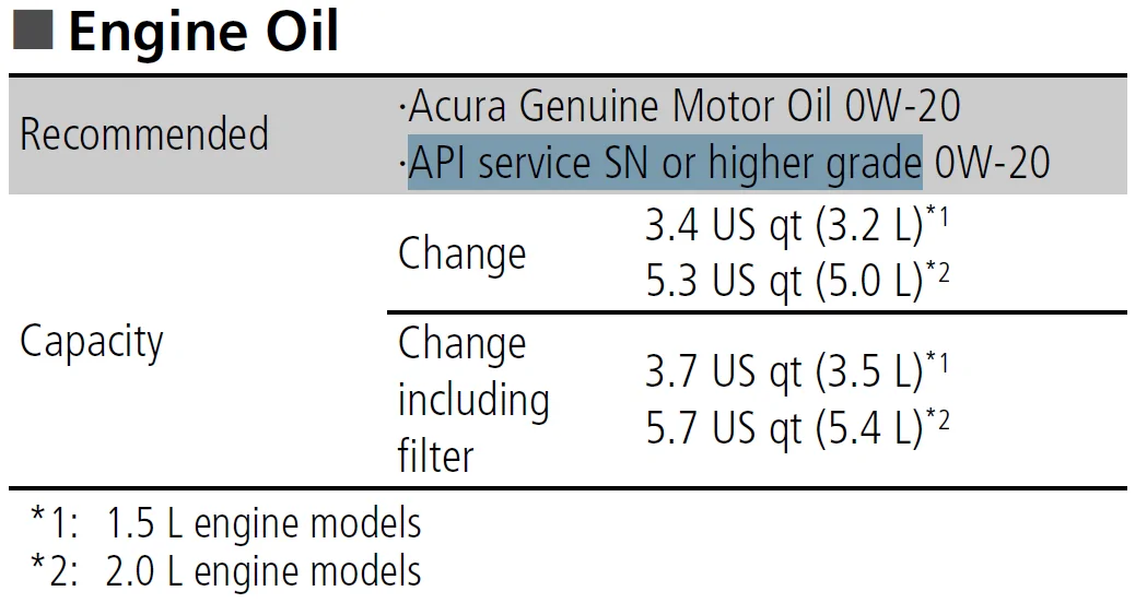

The spicy insider info is my ability to read and understand the owner's manual.
11th Gen Honda Civic Eneos oil.. 1775764877171-2g
Note that "SN or higher grade" here doesn't mean "SN or Amsoil Signature Series" - it means SN or successor API classifications. Those would be SP and SQ, currently.
