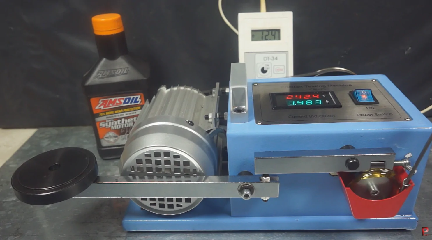

No. Research. Just had a quick Google search on best oils and all kind of stuff comes up with guys doing independent testing and such. But like I said, to each his own. I use nothing but that stuff. You’re more than welcome to use whatever you want. Heck, if someone thinks water works good, so be it. They have that right, even though we live in a dictatorial society!
And what Google got you was likely some sort of test featuring one of these guys:
11th Gen Honda Civic Eneos oil.. 1775750542976-vk
Which is a bearing tester invented by Timken to test wheel bearings and wheel bearing grease.
Yes, grease. Not motor oil. Grease.
https://advancedinstruments.en.made...Load-Test-Machine-for-Lubricating-Grease.html
Let me know how many wheel bearings you find in your engine next time you take it apart.
It's a completely irrelevant test, engines rely on oil pressure whereas wheel bearings do not. But unscrupulous and/or uneducated folks can use that test to "prove" one oil is superior to another based on a characteristic that isn't relevant to conditions found inside an engine.
It can actually favor worse oils, because the extreme pressure additives needed to be successful with that test are often corrosive to metals found in engine bearings, which are much softer than wheel bearings and are never intended to have regular metal-on-metal contact.
And not coincidentally, it's a test favored by MLM Amsoil lackeys (note the bottle in the above picture) because it's one that favors Amsoil and is easily rigged.
