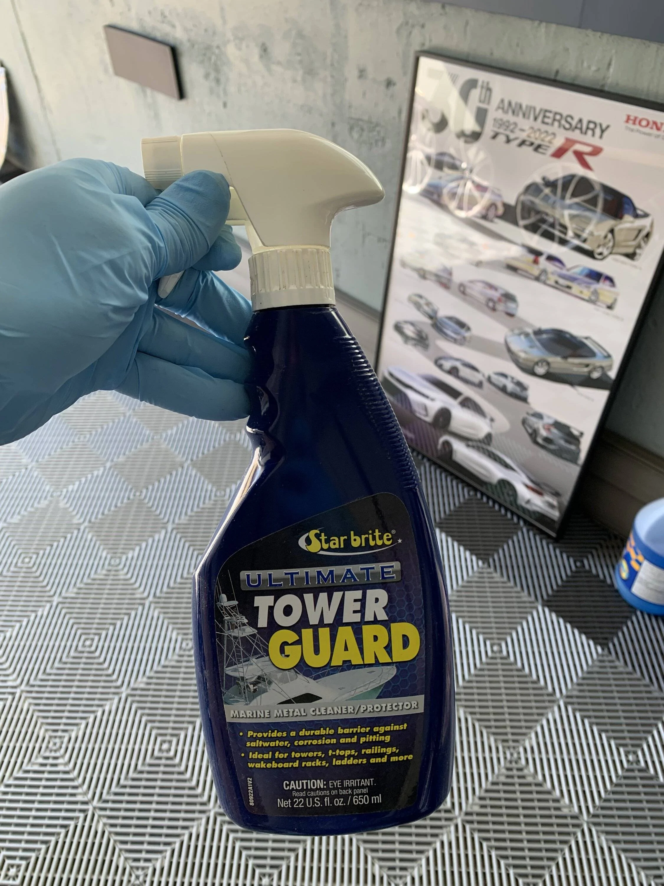

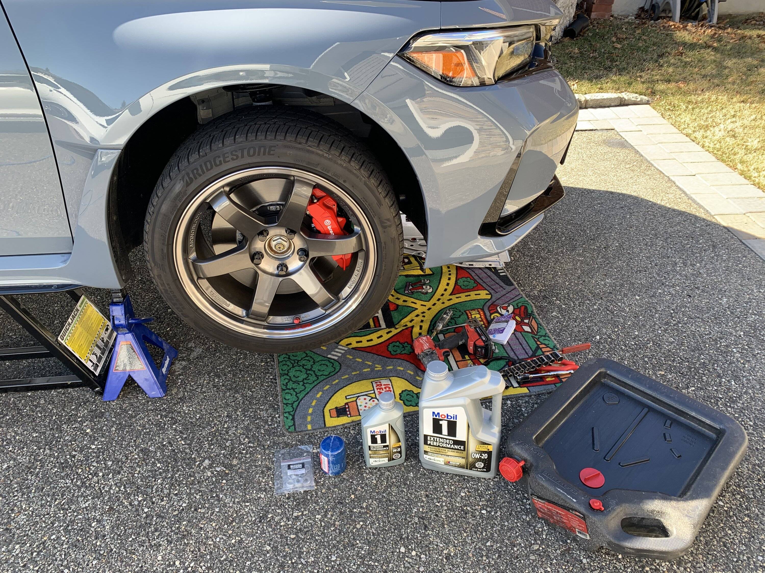

Just replaced oil and filter today. Also used Tower Guard metal clean/protectant on all the easy to get to aluminum parts (bottom of engine and trans case, control arms, underbody shield, steering knuckles, etc.) to help resist the white oxidation that occurs over time.
Tools needed are, large flat blade screwdriver and large Phillip’s screwdriver, 17mm for oil plug.
