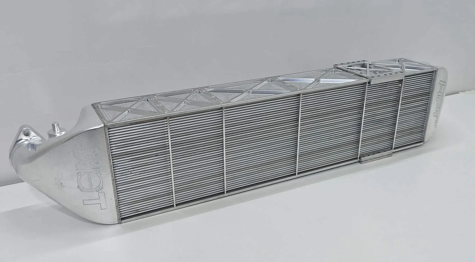

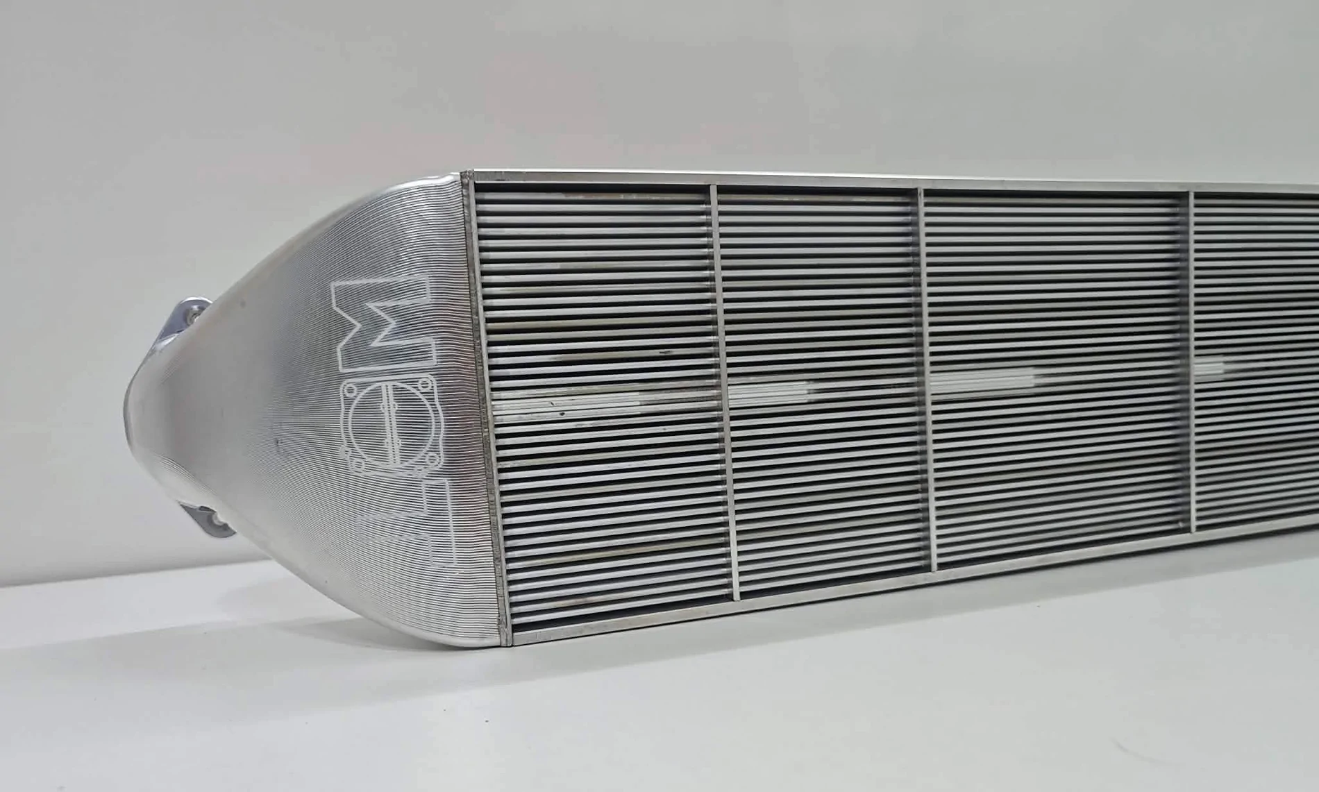

Will there be a WOT variation of the new PWR intercooler? Also think it'd be cool if there was a WOT variation of the micro tubule one 👀
The microtube is a WOT product in partnership with HPT, similar to my radiator in partnership with PWR.
11th Gen Honda Civic FL5 Intercooler Reference Thread received_1062368239553674
11th Gen Honda Civic FL5 Intercooler Reference Thread received_1368408968839945
There's no plans to have a WOT specific variant of the PWR unit, but I will be selling them as another option.

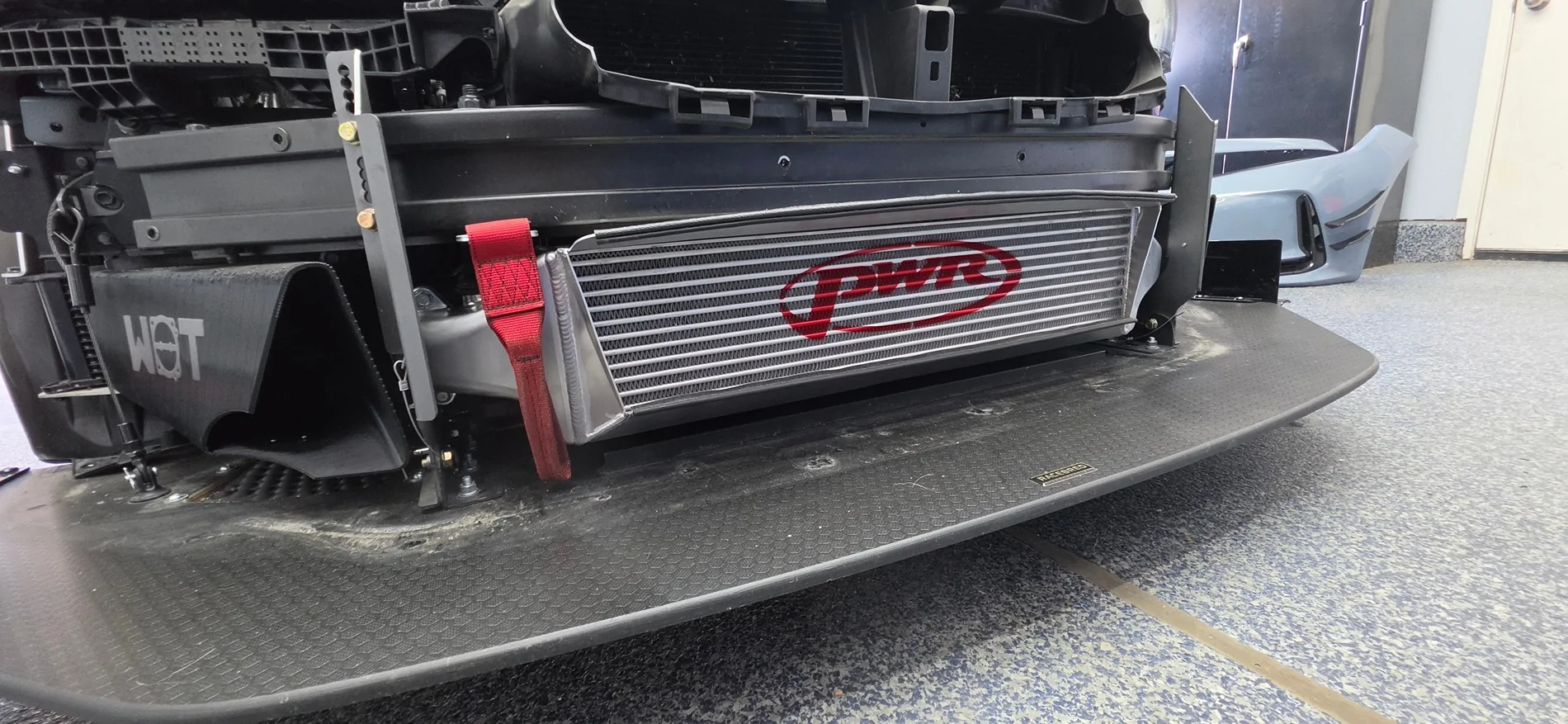

I had emailed PWR awhile back asking if the new model has the same fitment as the current one:
“The new FL5 intercooler will have the same fitment, still will accept factory charge pipes, you will now have to remove the factory air guides like with every other intercooler on the market. But we have built in ducting on the intercooler as standard that replaces the factory air guides, so the intercooler will be fully ducted tor the lower grille opening.”
I should've asked if relocation of the sensor was necessary, but my guess is if it’s a bigger core, maybe????

Has there been any photos of any information of this release from PWR?
Nikw91
Nik 772typr
Nov 3, 2023
557
569
WPB, FL
2025 CW FL5
If you go to the previous page on this thread, I posted a couple of pictures.

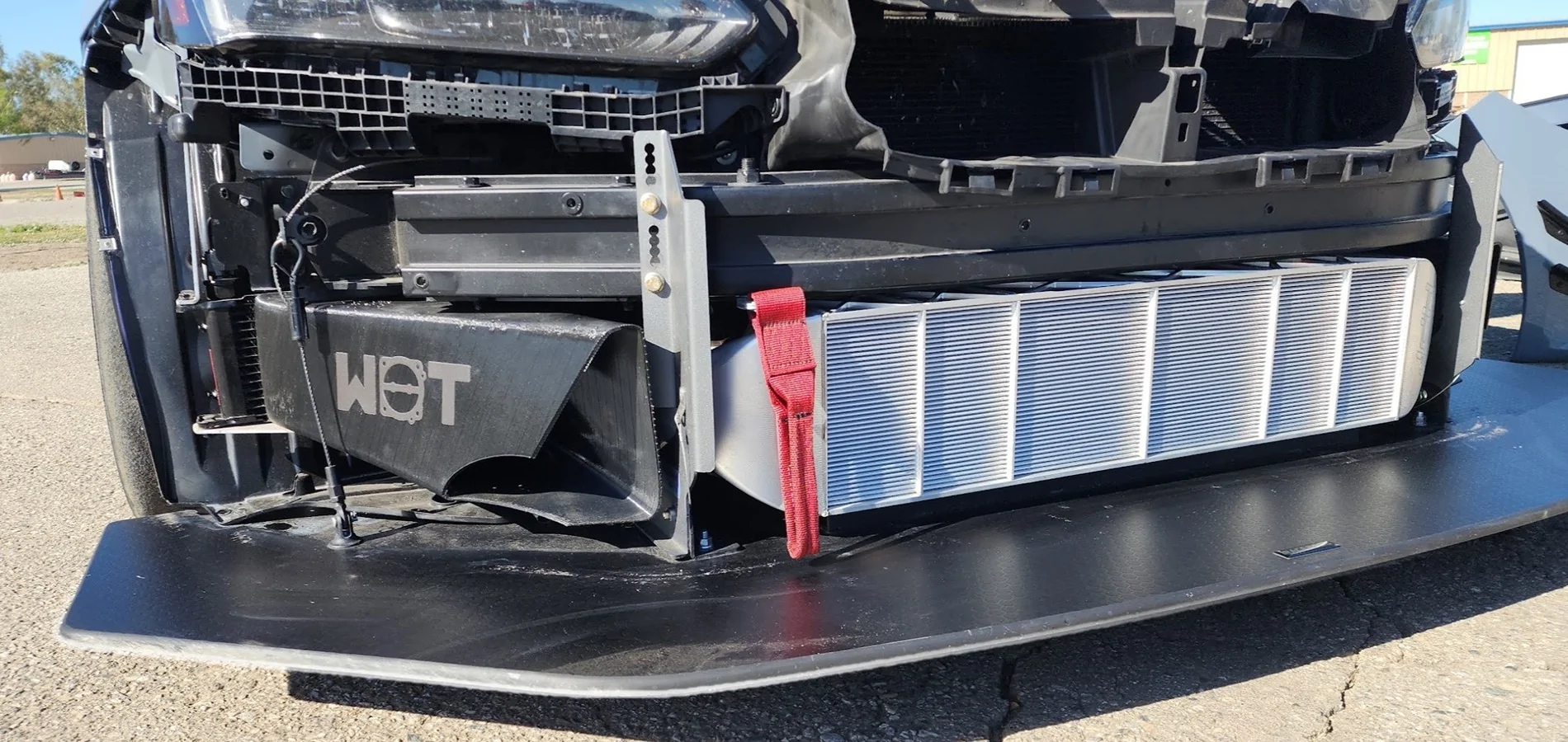

PWR Tube & Fin and WOT Microtube IC testing at Sonoma.
2 weeks ago on 8/22/26 I was at Sonoma Raceway for a track day. Along with trying to get records and such, another objective of mine was to test the new PWR Tube and Fin intercooler alongside the WOT Microtube intercooler to see how each performed on track.
My approach was to use the PWR T&F for the first 3 sessions, and then during the lunch session I would swap them out and run the WOT Microtube in sessions 4 and 5. Unfortunately there was a medical emergency in the paddock which required the ambulance to transport someone to the hospital. Obviously this is terrible. It also meant that session 4 was lost as we waited for the ambulance to return. Eventually they did return and we were able to run session 5.

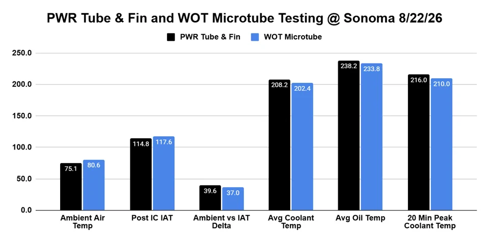

The data comes from session 3 with the PWR T&F IC, and session 5 with the WOT Microtube since these sessions were the most similar in ambient temp and driving pace.
Data was collected over the course of complete 20 minute sessions, with 8 hot laps of data for each session. The various data points were all collected at exactly the start/finish line on each lap and averaged to provide a more consistent information.
Both IC's were on the same tune and boost level (28.2 psi), 500whp. Nothing on the car was adjusted or changed.
Testing Results:
Ambient Air Temp: PWR - 75.1°F, WOT - 80.6°F
Post IC IAT: 114.8°F, WOT - 117.6°F
Delta IAT-Ambient: PWR - 39.6°F, WOT - 37.0°F
Avg Coolant Temp: PWR - 208.2°F, WOT - 202.4°F
Avg Oil Temp: PWR - 238.2°F, WOT - 233.8°F
Peak Coolant Temp (at any point in session): PWR - 216°F, WOT - 210°F
Avg Speed (MPH): PWR - 115.9, WOT - 117.1
Avg Lap Time: PWR - 1:45.7, WOT - 1:46.1
Conclusions:
Both are very strong options. Likely the best 2 intercoolers on the market for the track. PWR's is a tube and fin construction with built on ducting, WOT's is a microtube construction with just over 1100 tubes and no fins.
Both units have a very similar core size and weight: PWR - 28 x 6.75 x 4.5", 14.6 lbs (850.5 cubic in), WOT - 27.75 x 7.25 x 4.4" (885.2 cubic in), 14.6 lbs.
From my testing the WOT Microtube performed better on the day. It had the burden of a 6°F higher ambient temp, but still managed to have lower coolant and oil temps, lower IAT/ambient delta temps, and resulted in slightly faster speeds at the start/finish line. The microtube has the structural advantage which allows air to more easily flow through it to the radiator behind. It also produces cooler charge air because each tube has a full 360° of exposed surface area. Ultimately it's just a more efficient structure all around.
That said the new PWR tube and fin IC is a strong improvement over the previous bar and plate model they offered. From my observation it is likely the second best intercooler available for the FL5/DE5 platforms.
The PWR Tube and Fin is listed at $1749, and the WOT Microtube is listed at $2000. Currently there is an estimated 12-16 week lead time on the PWR units as they are all being built to order. There are 10 WOT units in stock at the moment.
There is an FK8 version of the microtube being developed currently that will be ready to ship in the next couple of weeks. Promo pricing for the first 15 units at $1800 shipped. After that pricing goes up to the normal price of $2000.
Let me know if you are interested in either a microtube or PWR unit and I can get one headed your way.

Thanks for the excellent write up! The results are hard to compare without a control like using the OEM intercooler. No doubt these both are effective but by how much is hard to determine. These are definitely both at the top of my list now regardless. Thanks again.
