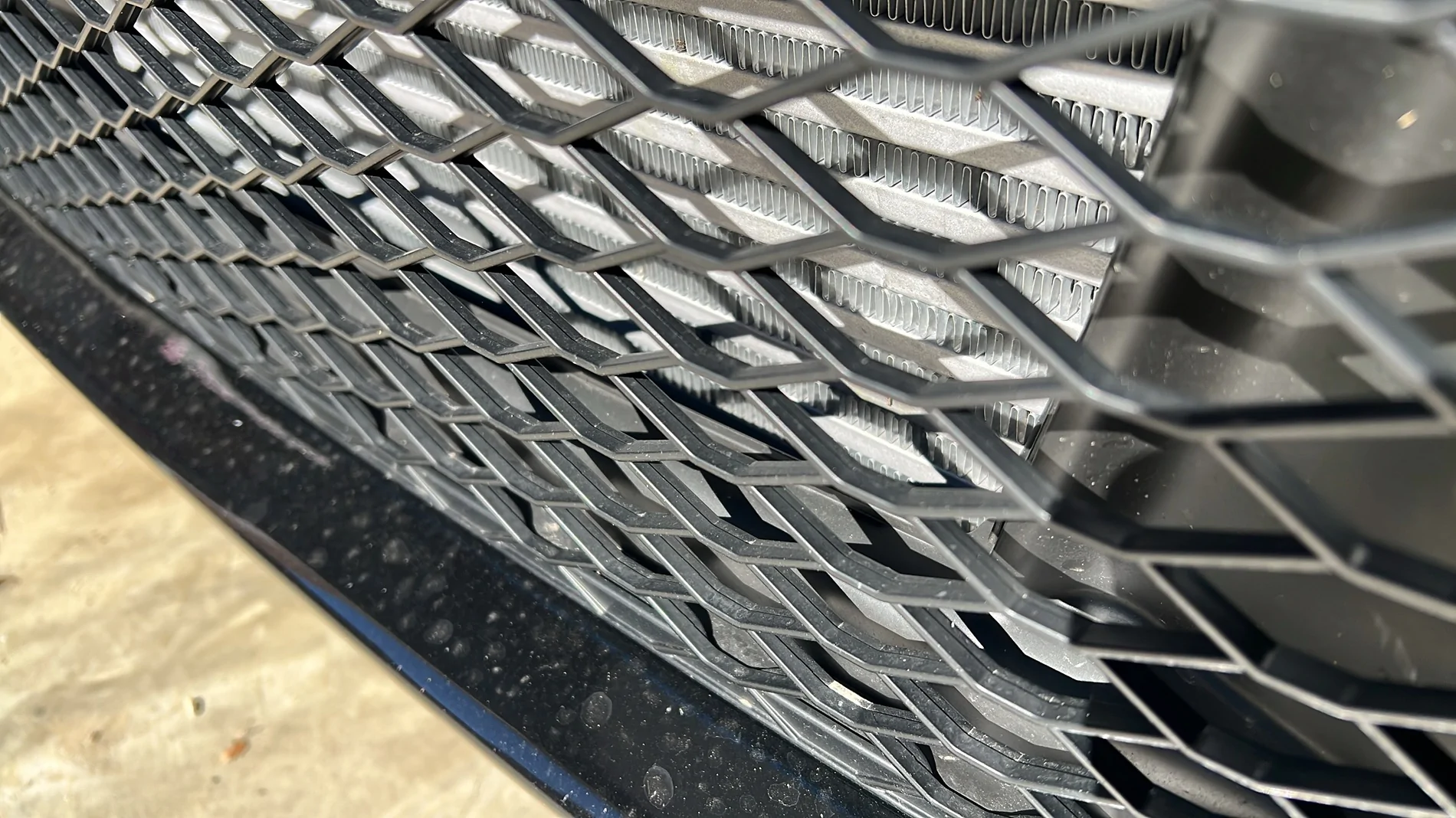

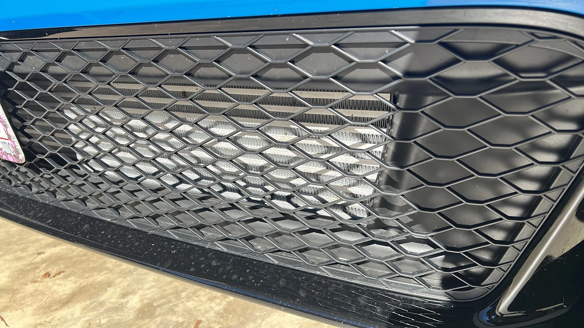

Has anyone shaved the lower inside lip of the intercooler opening?
