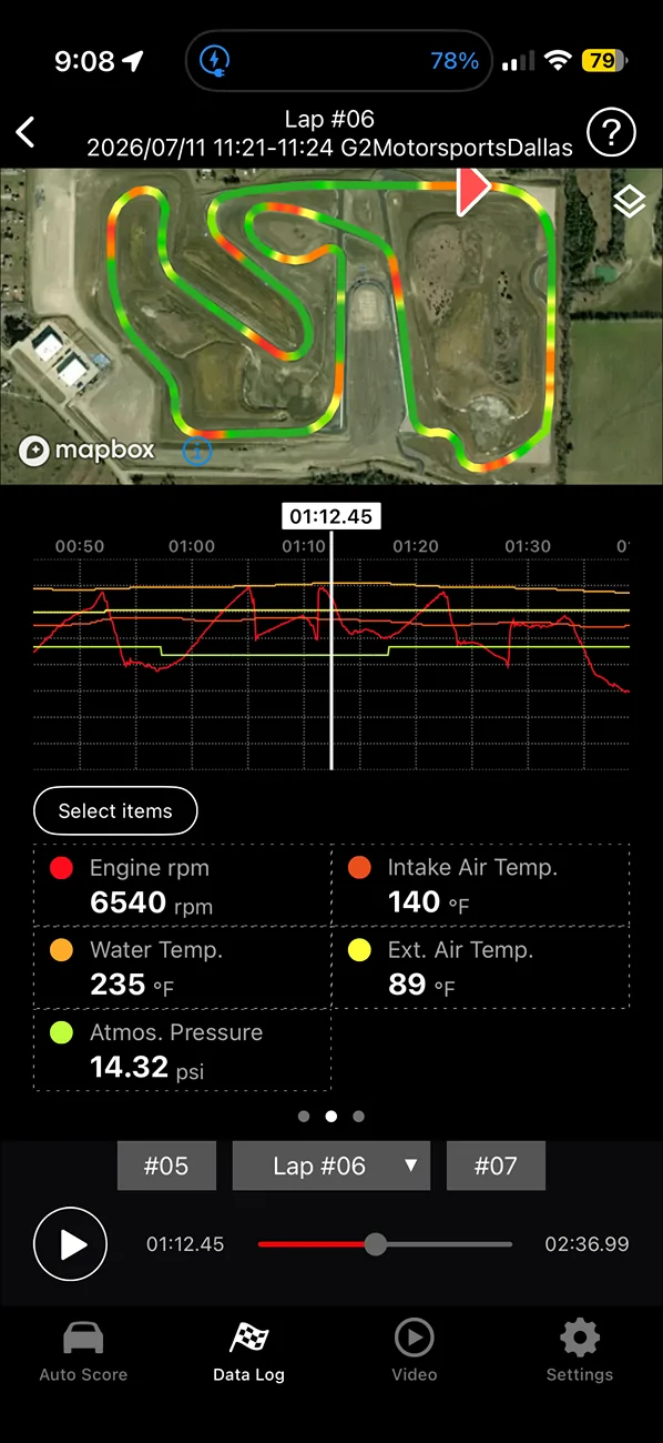

Without - Mister OFF - Water Temp 235F

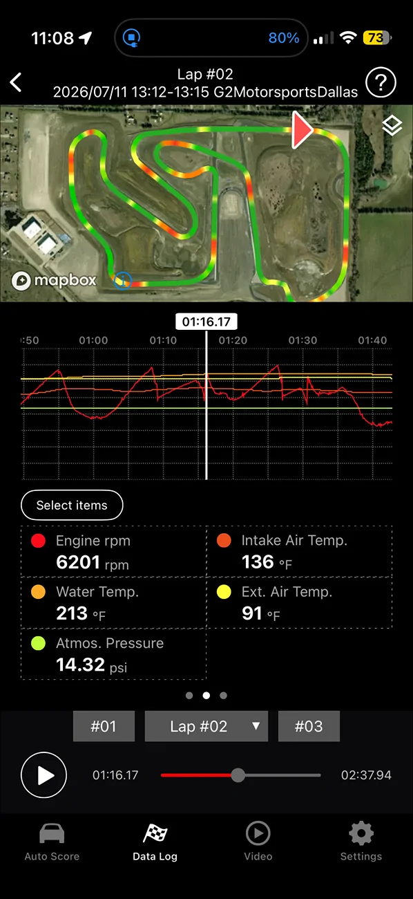

With - Mister On - Water Temp 213F - Same exact hottest location on track

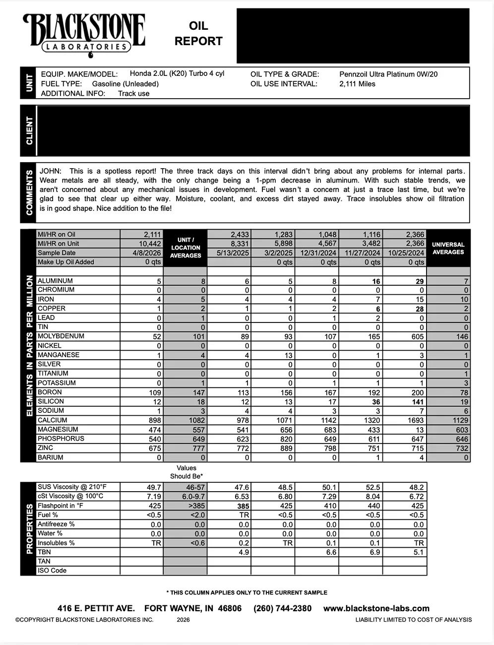

Oil Analysis
Instead of guessing, I've also been sending oil samples to Blackstone Laboratories after track use.
My latest report was after:
  • 2,111 miles
  • 3 track days
The report came back extremely clean.
Blackstone's comments were:
"This is a spotless report... Wear metals are all steady... Fuel wasn't a concern... Moisture, coolant, and excess dirt stayed away... Nice addition to the file."
Wear metals remained very low, and there was no evidence of coolant contamination or abnormal engine wear during this interval.
11th Gen Honda Civic FL5 Track Cooling Experiment: Portable Water Misting the Condenser/Radiator & Intercooler (Data from 99°F Texas HPDE) 1784001399889-lh
Obviously this doesn't prove a cooling strategy works by itself, but it has given me confidence that the engine has been handling repeated track use well with my maintenance schedule.

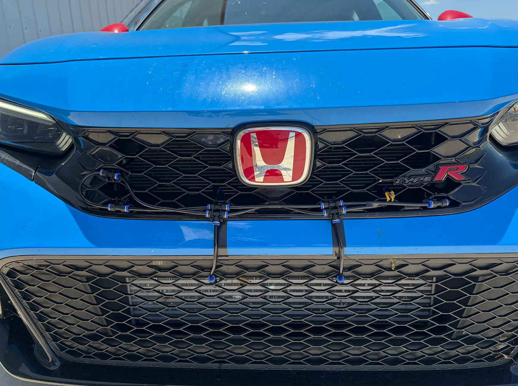

I installed:
  • 4 fine-mist nozzles aimed at the condenser/radiator stack
  • 2 fine-mist nozzles aimed at the intercooler
Everything is removable.
No permanent modifications.

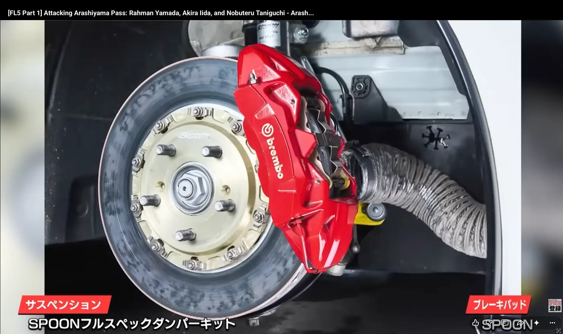

I will soon add ducting, to reduce the brake caliper temps by another 100F degrees and will also try misting it in the center of the brake rotor and as it spins and air flows from the duct, it will cool the rotors instantly and constantly from the center out.
Spoon uses a similar duct - I'll try this next, take readings then add water misting also if it's not enough.
