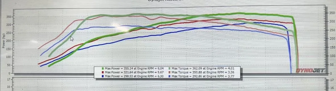

This is all I can share since I do not have any other tunes from other companies. But at least you can see stock, Hondata and my custom tune for track duty.
11th Gen Honda Civic Head to head comparison of “off the shelf” tunes for a stock fl5 coming soon. (UPDATED WITH INTERIM RESULTS) IMG_3094
If you need any guidance or any tune requests feel free to send me a DM.

Also this was achieved with 24 psi of boost. A bit less than Hondata to avoid fuel pump crashing.
This was also on a bone stock car except for intercooler. Stock fuel pump, stock downpipe and exhaust, stock intake and filter.
