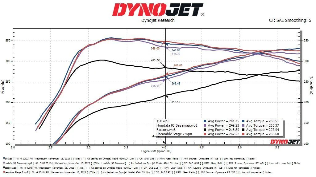

Dyno chart from then:
The key learnings from that were:
- TSP and Phearable are very similar to each other.
- Both produce way more power than stock
- Quality of gas matters a lot. Both TSP and Phearable tunes had meaningful knock above 6k which pulled timing and limited peak power. This was on 93 octane.

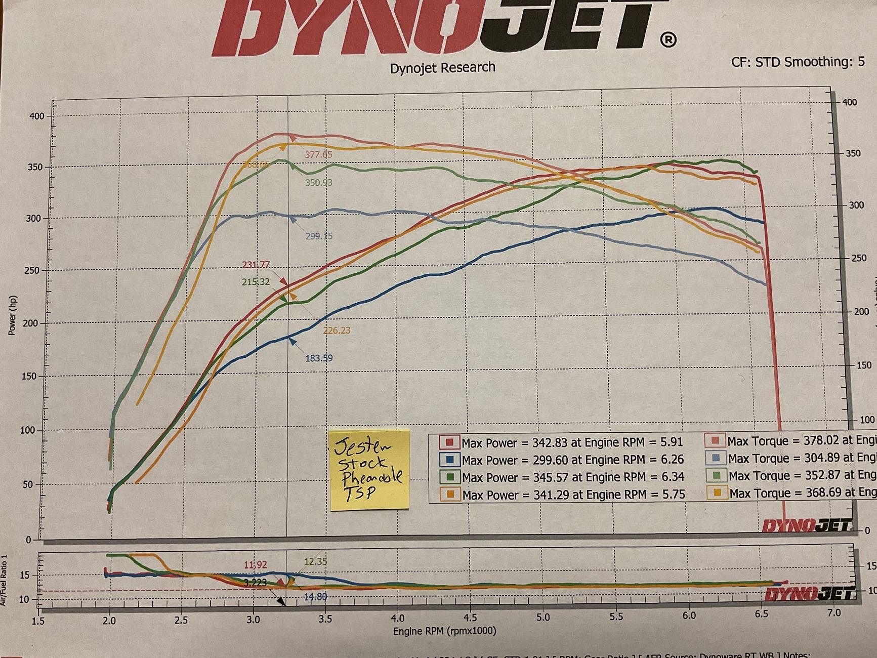

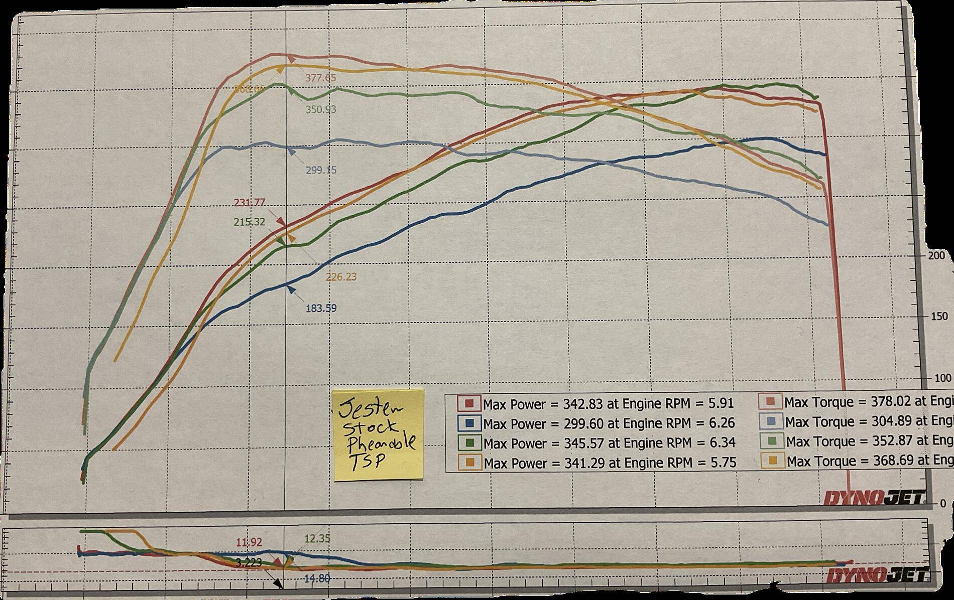

Here is the results of round 2:
Once again knock was an issue above 6K rpm suggesting that a) these tunes are sensitive to fuel quality above 6k and b) 93 octane in Va sucks (remember I had added an octane booster). Peak horsepower for TSP and Jester was limited by knock retard.
There was a very small amount of knock on one cylinder with JesterTuned. TSP had more significant knock on two cylinders. Phearable had none. I ran 3 pulls each and picked the best result that was backed up. I also reran Phearable and Jesters again at the end to confirm the results and they were consistent with the first time.
- the Phearable tune appears to be the most conservative with timing and the only one without any knock. It previously was nearly identical to TSP when I ran this last year so I am guessing the performance difference was a fluke.

Thanks for taking the time to post your results.
Do you happen to have datalogs for each dyno run?
Was curious to review logs if you have them as it looks like you may have not driven the vehicle long enough to allow the cam timing to come online when testing the Phearable tune.
Also, notating what the iats were for each run would be helpful.
Regarding knock retard with other tunes, it’s not ideal to constantly rely on the knock sensor and ecu to constantly pull ignition timing to prevent ignition timing. Especially for a “track” application.

My tune does not rely on the knock sensor for a track application. This was explained to the customer and the reason for revisions to really dial in the tune with the fuel they actually have available.
