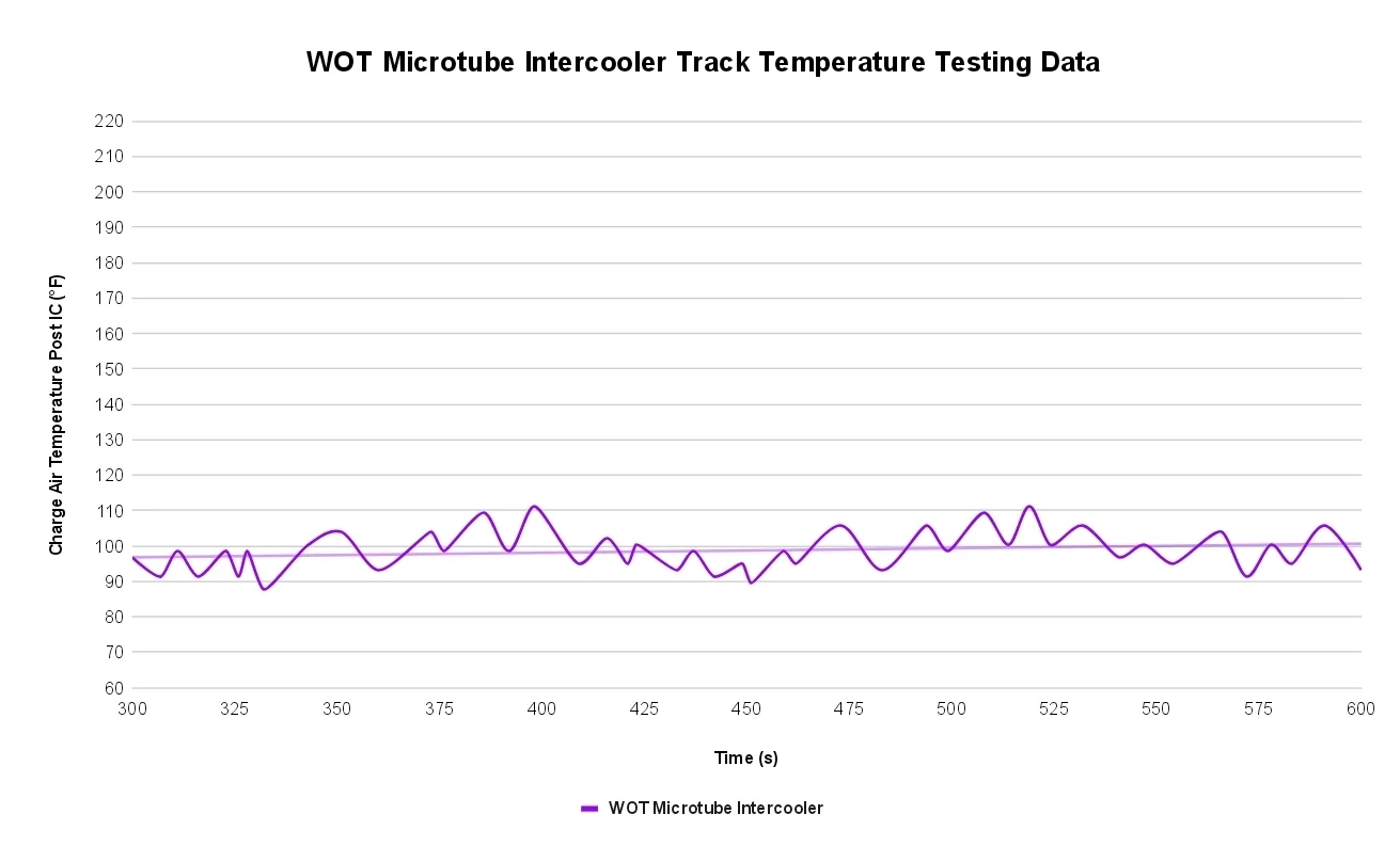

Here's some more testing data on the WOT Microtube Intercooler.
This is a line graph showing the performance of the WOT Microtube intercooler when tested a couple weeks back on the track at GTA Finals at Buttonwillow Raceway. The ambient temp during this session was 74°F. The car is making approx 500whp pushing 30psi with the MHI turbo. The data shown is actually the second 5 minutes of my session, from 5-10 minutes. I figured why not show everything when it's really had a chance to be pushed and fully heat soaked. If it can win with this disadvantage that's all the more impressive. Couple that with the power the car is producing and this is a real stress test for the microtube IC.
You'll see that the trend line hovers right around 98-100°F, with a few peaks getting up to 110°F. The graph isn't uniform because the demands of the track are fairly random when it comes to looking at them on a graph. What is nice though is this is real and hard data in the setting we all hope to have performance at: on the track, with real load, with real drag and air flow, and in a truly dynamic setting.
What isn't shown on the graph is the extremely impressive coolant temps to go along with these great post IC IATs. One of the major benefits of the microtube structure is the air flow it provides the lower half of the radiator helping it to function at a much higher level of efficiency (max coolant temp of 204°F in this session), to go along with the impressive charge air cooling. And this unit only weights 15.5 lbs! It really is a win-win-win.

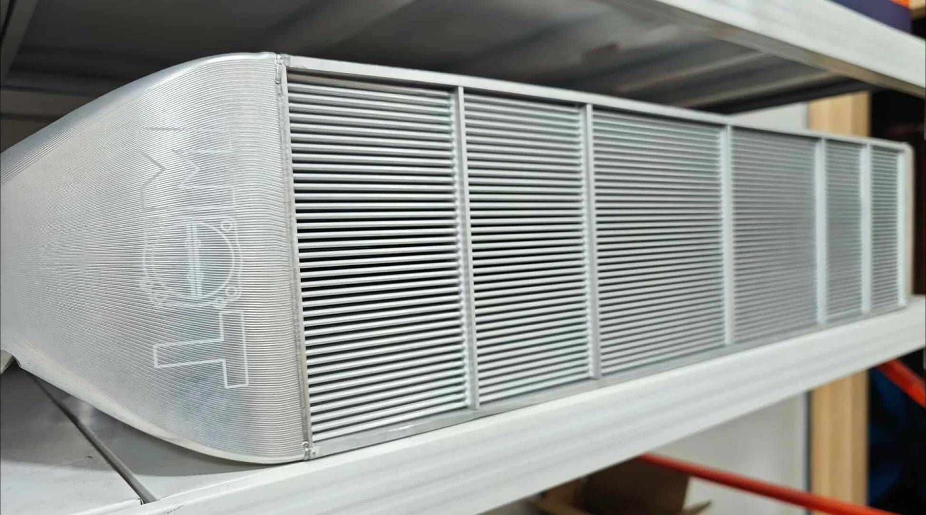

Very interesting and impressive results...Since the intercooler uses 1,102 individual tubes, how are the tubes secured to the end plates to maintain a positive seal over time?
They are sealed to the header with a proprietary epoxy that has a working temperature range of -60°C to 250°C, with a momentary peak of 400℃.
I understand that the epoxy will withstand the temps.
But what about heat cycles combined with vibrations?
Will the epoxy develop stress cracks, or be separated from the aluminum?

That's an understandable concern.
The epoxy formula used on the Microtube IC is also used with mining machinery and in high-frequency vibration environments.
If one should fail we offer a 1 year warranty against manufacturer defects.

Failure would most likely just lead to a boost leak. Reduced power would be the result, but would still be drivable.
If failure were to happen it would really just depend on the failure, but repair would be likely. If the epoxy fails then more could be applied in the affected area. If a tube were to be broken it could be welded closed to seal off the leak.
This is similar to traditional intercoolers which could take road damage and be repaired, but if the damage is massive like a giant rock takes out a big chunk, it might be beyond repair.

The epoxy is giving “point of failure” vibes. There’s a few out there on track I think I read? Maybe find out who and ask nicely if they can inspect and update folks?

It's honestly not a concern. Epoxy is used in high pressure and high heat applications. It's used in basically every composite (carbon fiber and other) formulations. We know carbon fiber parts are used in a massive array of parts and we don't question those parts, but they are made with epoxy.
Industrial epoxys can have a sealing rating of 500-600psi. Aerospace grade can be as high 15,000-20,000 psi.
Temperature ratings can be north of 500°F.
Ferrari F1 microtube heat exchangers used epoxy in their designs.
We are dealing with a relatively low amount of pressure and heat in comparison.
I'm just answering everyone's questions honestly. A person's concerns are fair but they don't necessitate an issue.
