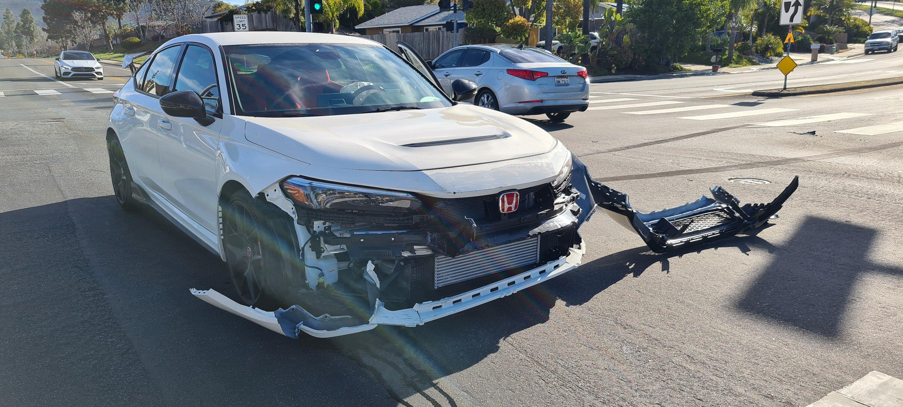

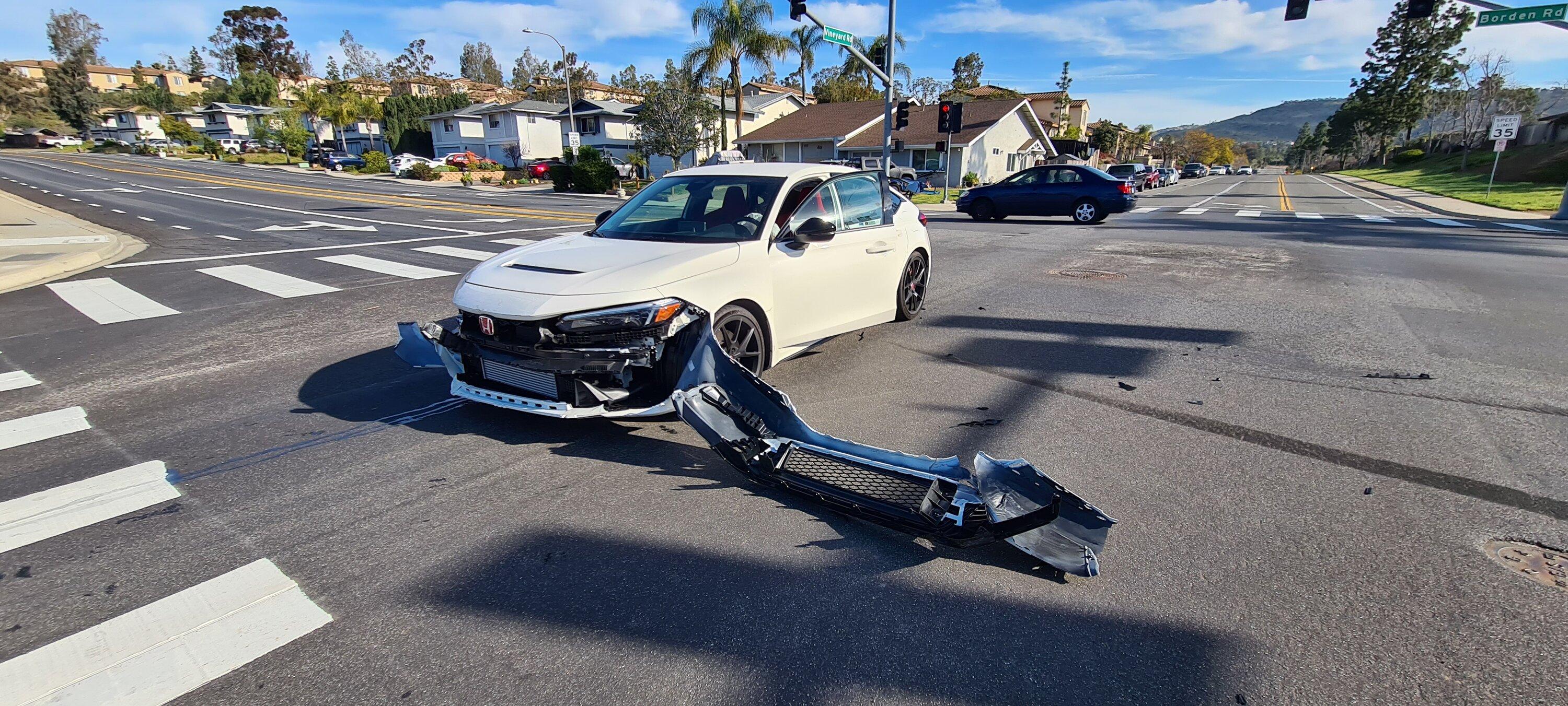

Well, after 3500 miles of fun ownership, someone ran a red today and hit me.
While not a loss in my eyes, I gotta wait for insurance to take a look at it and determine the details. Airbags did go off so I'm hoping it's a case of a sensor just getting clipped based on the fact that it looks mostly cosmetic.
Thankfully no one was hurt and the other driver admitted fault on the police report.

Could've been worse. If I was 1 foot further up the road, that impact would've been a real hit. Car runs and drives which gives me hope that they'll repair it.
Seems like an easy fix! Bumper components and airbag.

Ouch, sorry to hear it man but glad to hear your insurance isn't screwing you over. How longs the estimated repair? The damage appears to be superficial to just the exterior panels.

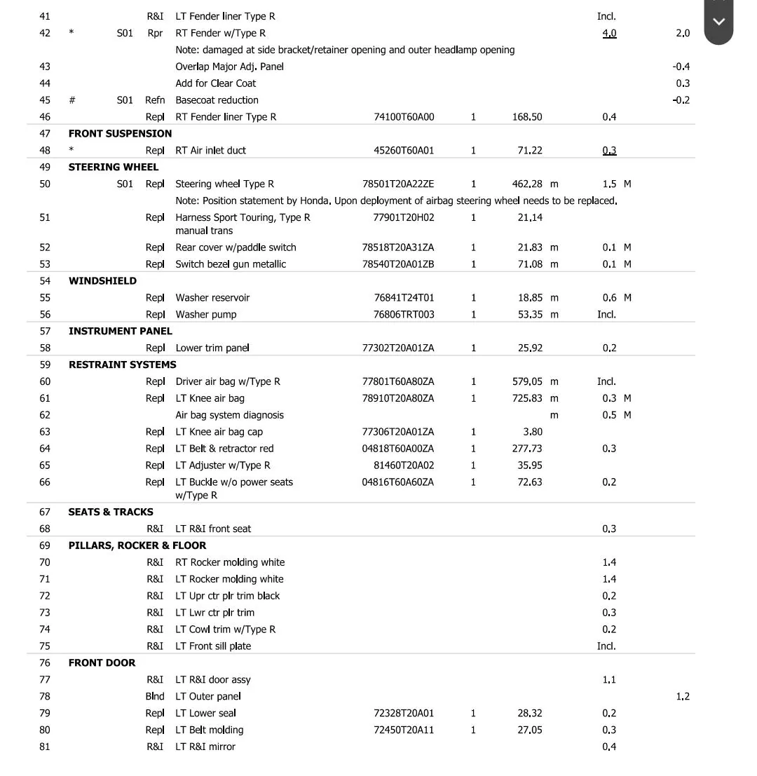

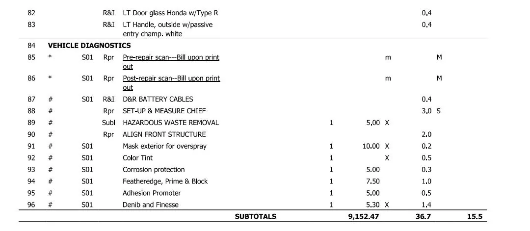

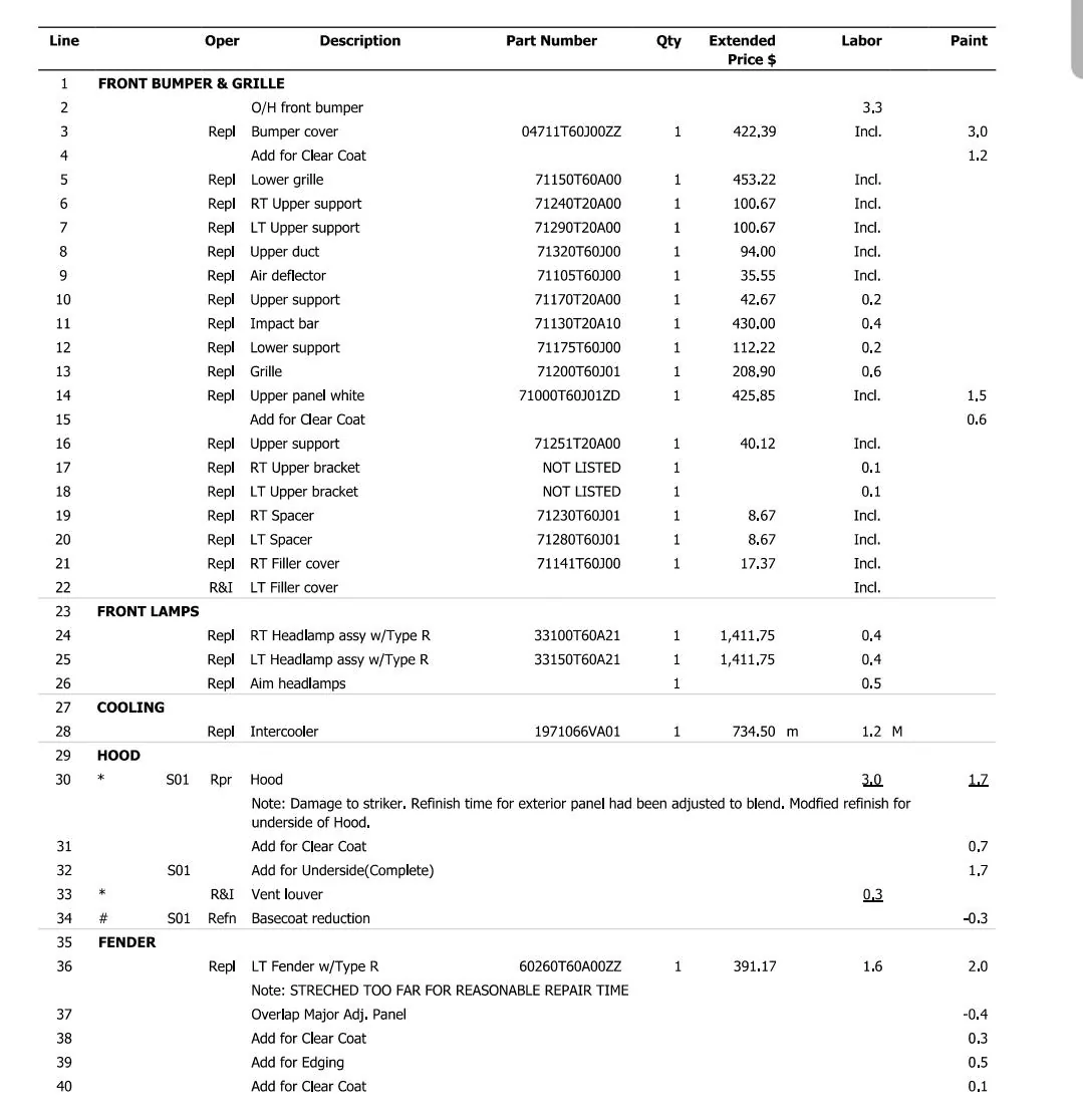

They said the work itself would take them about 2 weeks, but the big thing is parts availability so they don't know exactly. Exterior panels plus some interior parts plus some other stuff. I'll upload the full sheet here
2,057
3,454
Oh
Thats the just the parts cost lmao
Labor cost, not pictured above was 6k
