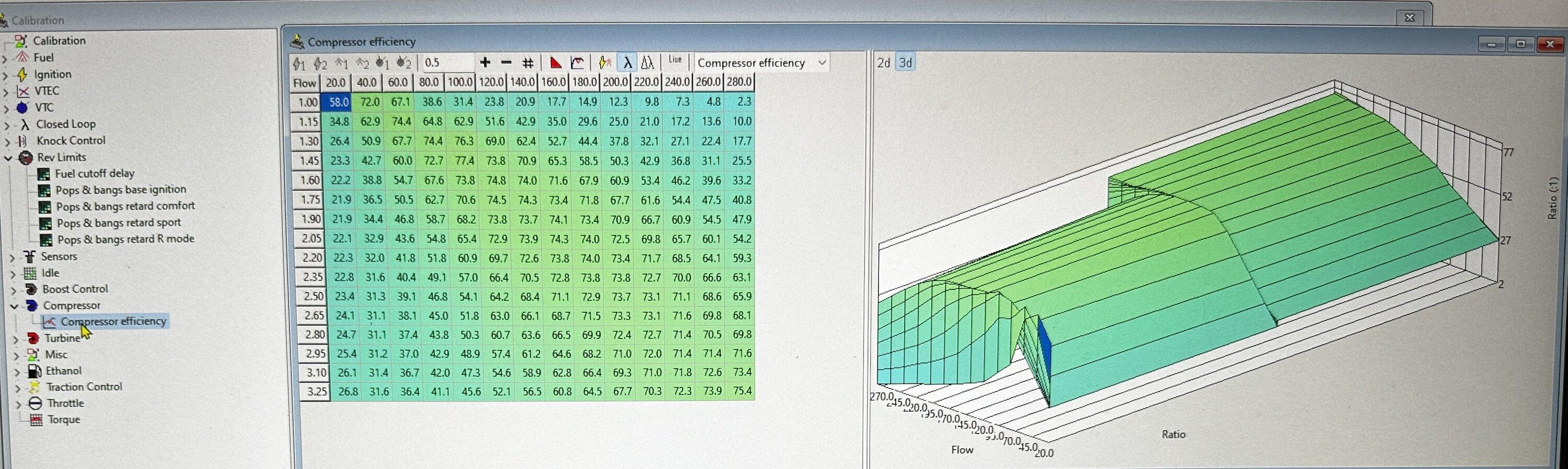

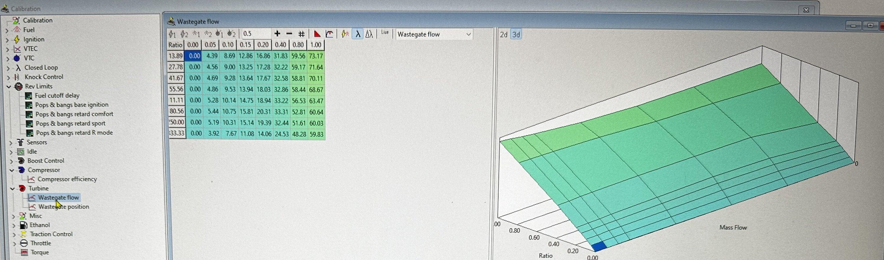

Thanks for sharing great insights! I am a fan of sharing information as that is likely to up the quality of tunes overall.
Is it relatively easy to scale tables for say 8000 rpm redline? As we go beyond factory parameters, I would imagine we will need to figure out turbo model data as well.
So can’t give insight on the new turbo tables since I have not used them yet since I’m stock turbo. Scaling up in RPM’s is ok to do, but for safety reasons I would recommend upgrading internals so it can handle it. I would not go over 7500rpms on a stock engine.
Hondata will keep adding features and making the software more complete so in time it will get better. But if 8k rpm’s are the goal I would jump to Motec if it were me. Hondata I would limit it to 7,500-7800rpms and even then you will lose some resolution of the tables.
And I’m all for sharing to a certain extent, and I will gladly help people to the best of my knowledge. But some caution comes with that. Too much info can be misused and other people can take advantage of it too. A lot of people copy paste other tuner’s work.
