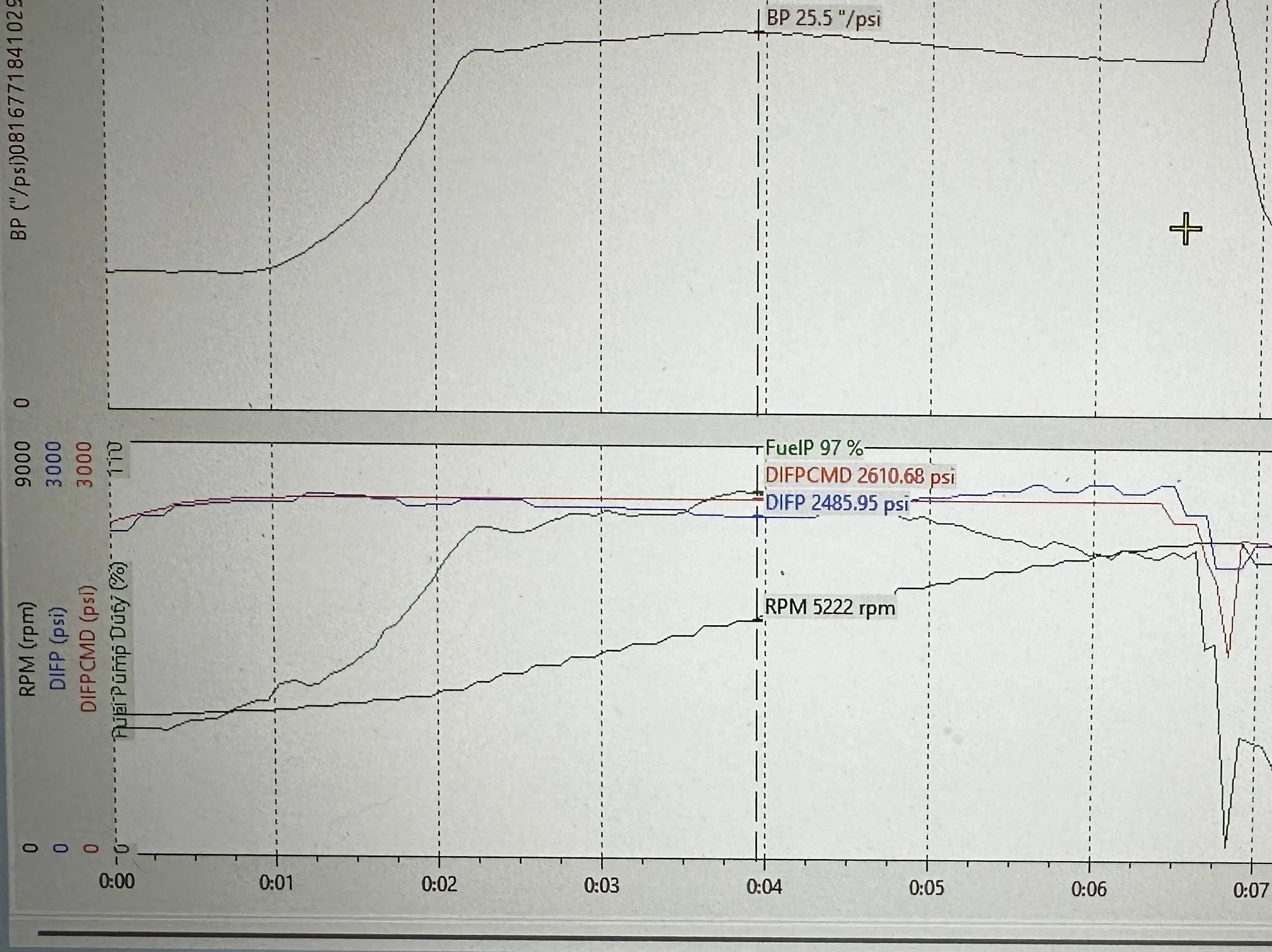

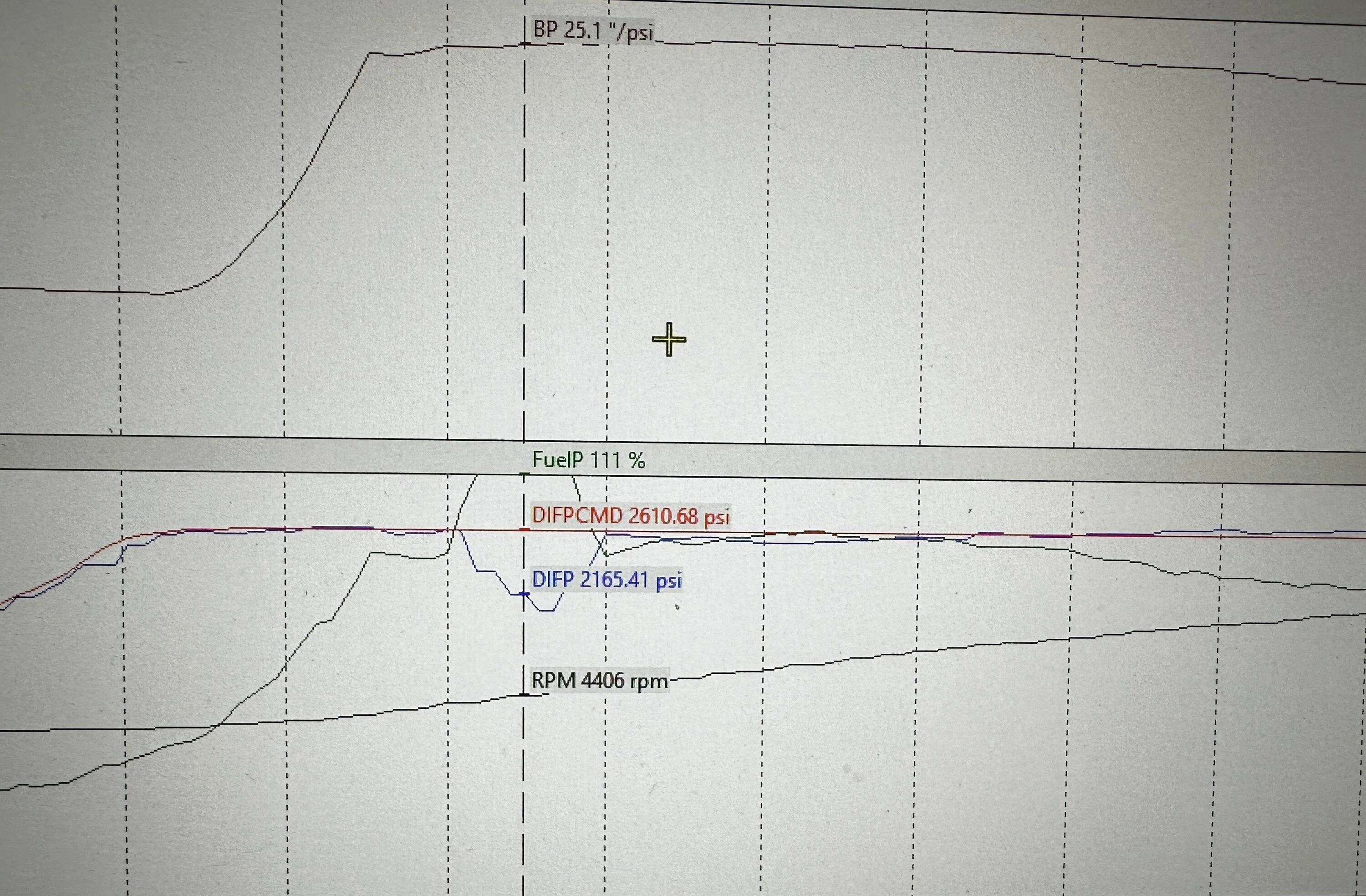

Here is some data I would like to share
This is a log of the Hondata map. In which you can see the agressive boost curve maxes out the fuel pump for a moment and the car loses control the air fuel since it goes into protection mode which richens the fuel mixture. This won’t break the car and its safe for the short amount of time it happens. Hondata is not going to break the car.
11th Gen Honda Civic Jester’s Hondata thread IMG_2827
Now this is my map with a more progressive boost curve and look how the fuel pump handles it much better without a crazy pressure drop. This also decreases the torque spike down low to decrease stress on the engine. Final goal for the tune will be around 24psi so a bit less than its running right now. Also this map holds boost longer until redline since it does not spike as hard.
11th Gen Honda Civic Jester’s Hondata thread IMG_2826
