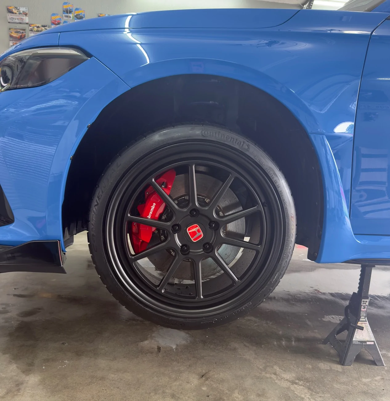

I went on the OEM tire size with same spec just less offset instead of +60 went +50 and continental DWS, still waiting on one of the link kits to arrive and figured out a way to loose the nut to see how they look on the ground. But here a picture on the car.
What wheels are these?
