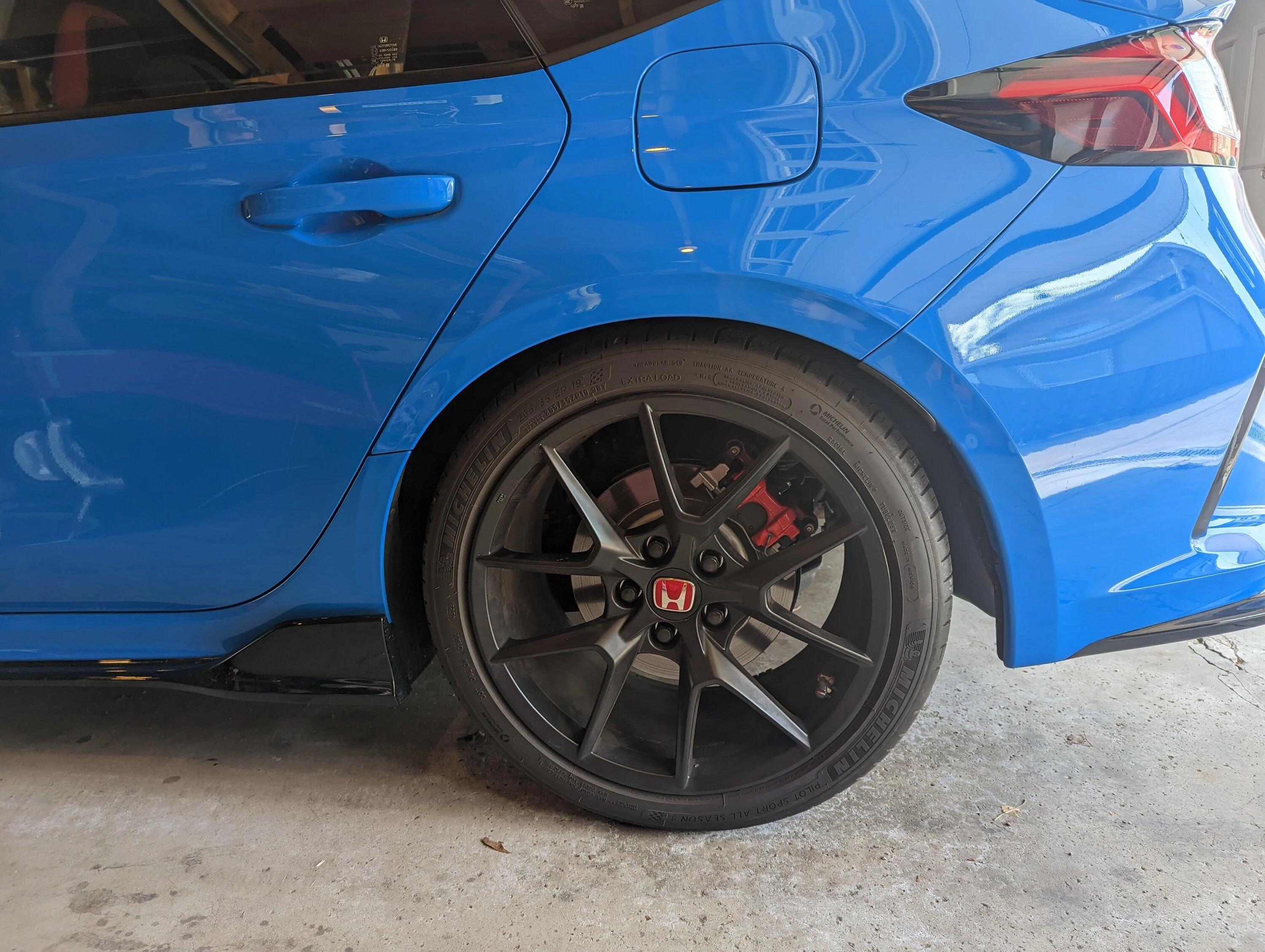

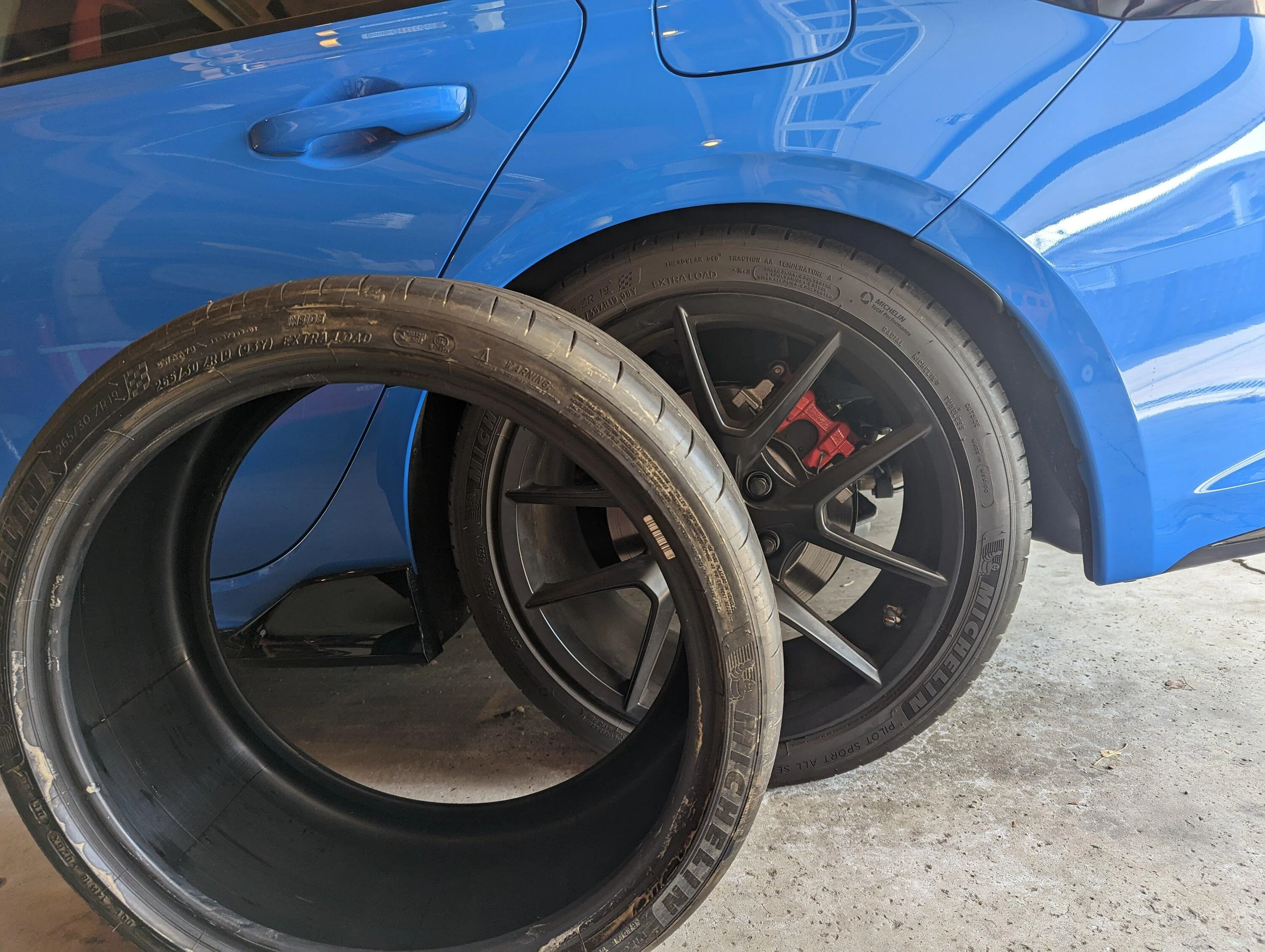

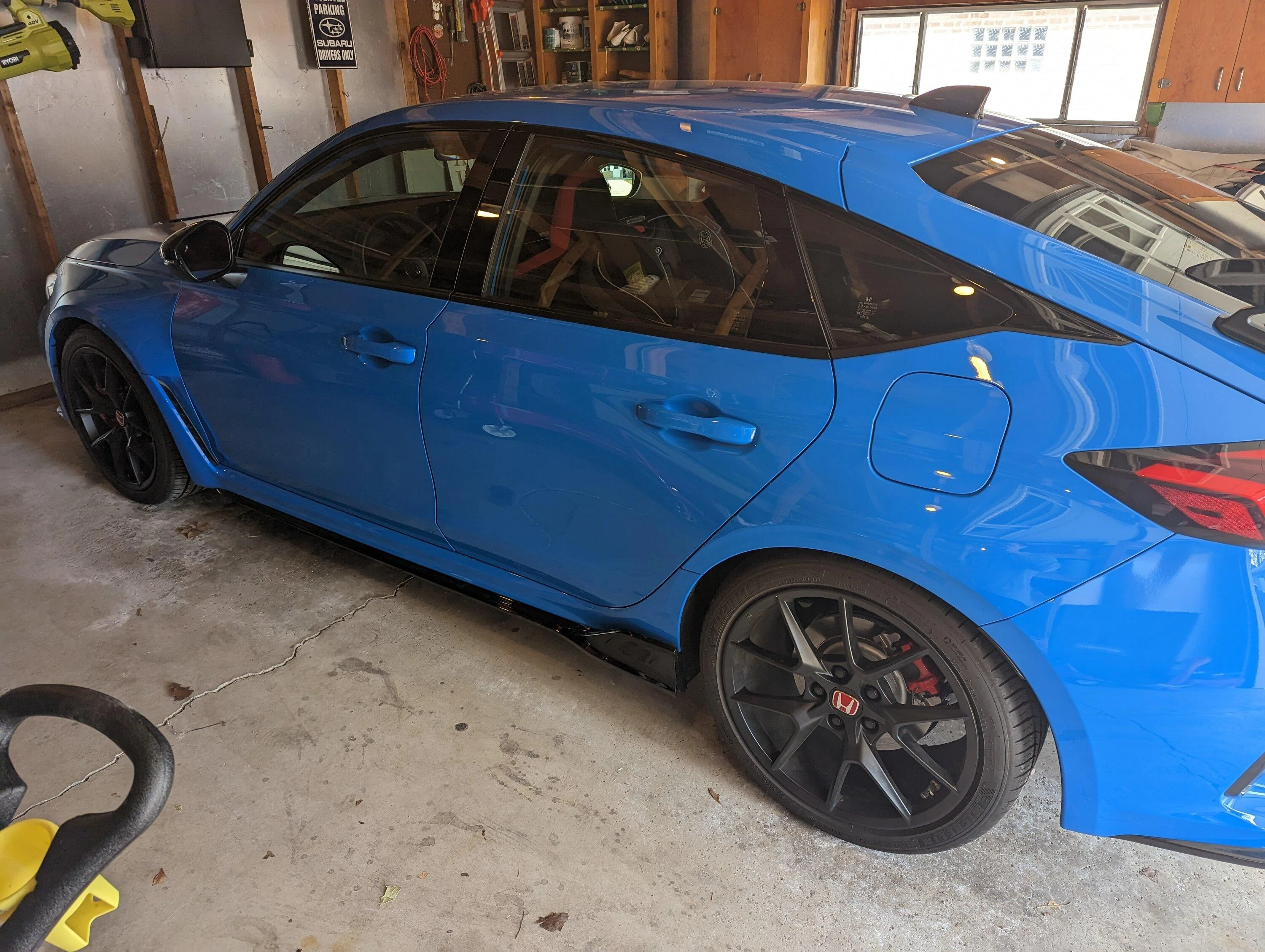

Not the best pics but should give you an idea. OEM summer tire for reference.
Looks great! Thinking of doing the same. I drive from CT to NY all the time and twice I struck a pothole so hard that I thought I completely cracked the front rim in half.

Now that you've spent time with this set up... Do you have any thoughts or opinions?

I'm happy with it. The extra sidewall is a lot better for city driving. I'm no car reviewer, but in my opinion unless you are tracking it you won't notice any real negative performance changes in street driving compared to oem.

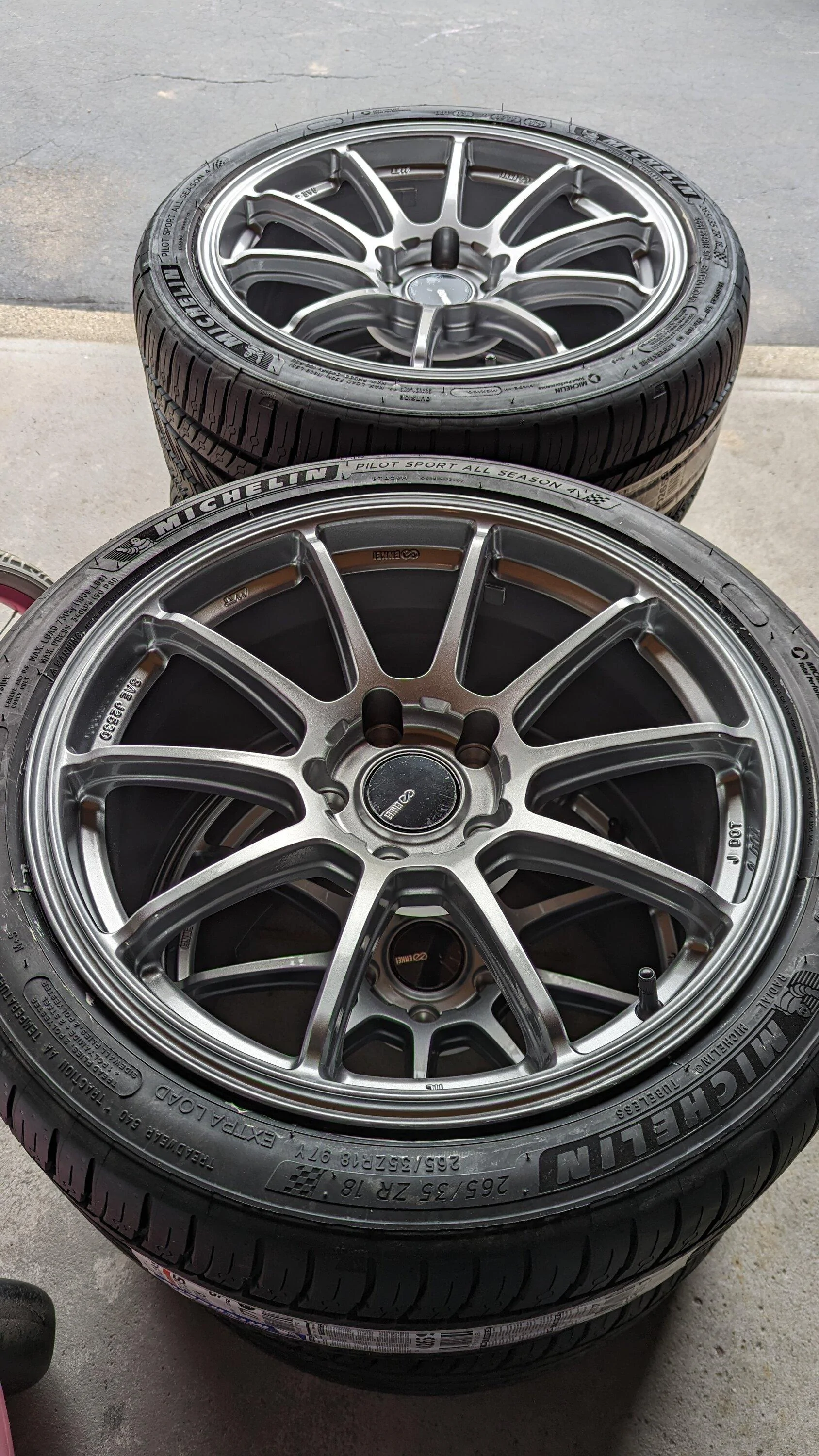

Speaking of Michelin Pilot AS, my daily driver setup just arrived . Will get some good driving/ride impressions once installed.
Are those the Triumph model? Any idea what the weight is? They look great I wish they came in gold. But the bronze may work for me.

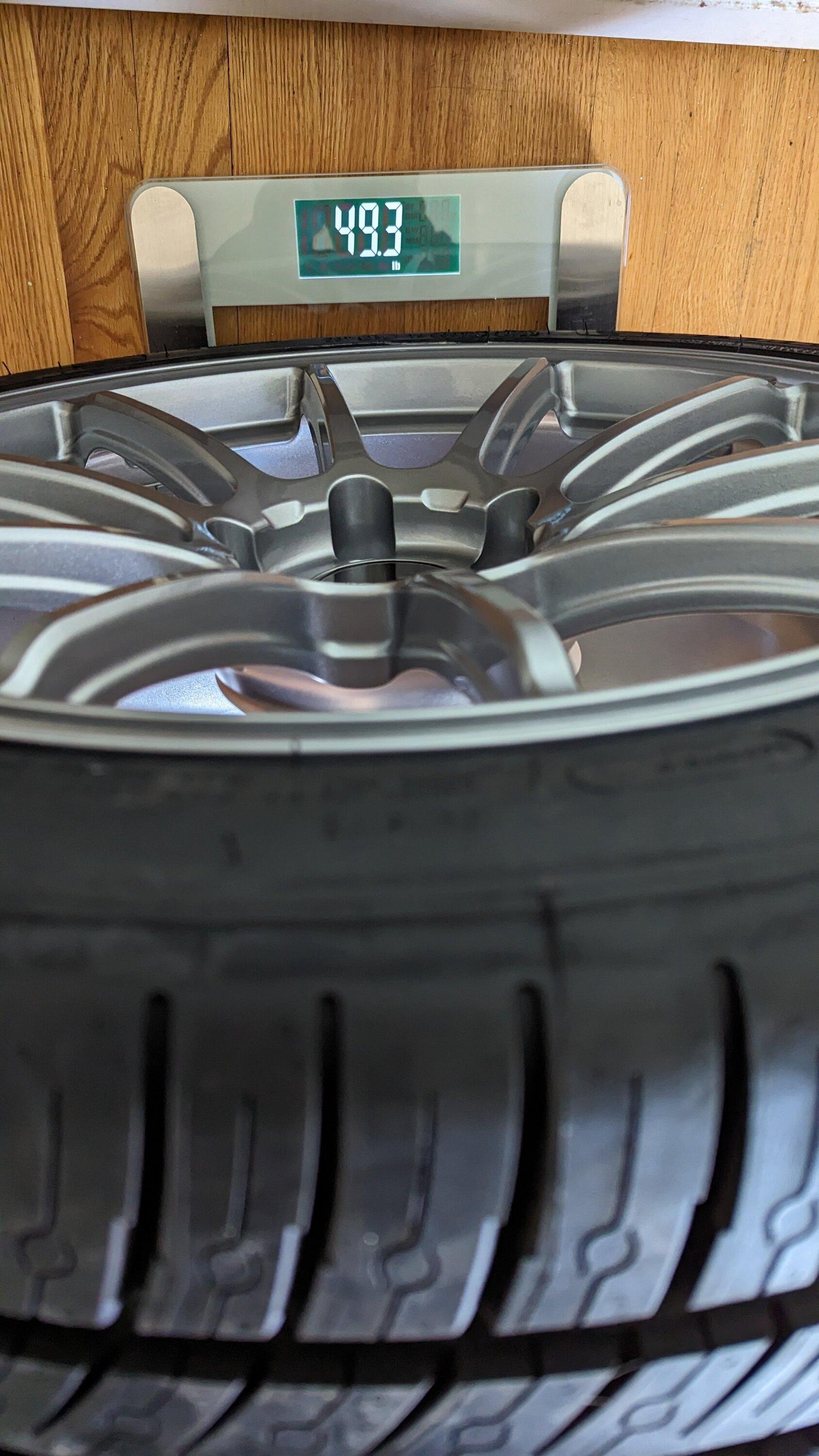

Yep! Triumph 18x9.5 et45 mounted on Michelin pilot AS 265/35/18s.
By my math, the triumphs weigh roughly 22lbs. I derived this by weighing the new setup and subtracting the official listed weight of the tires which is 27lbs. 49 - 27 = 22lbs. Btw If you're looking to save weight, go with the Continental DWS 06 plus, they're only 20lbs.
Here's a pic of my setup and the weight if it helps.
