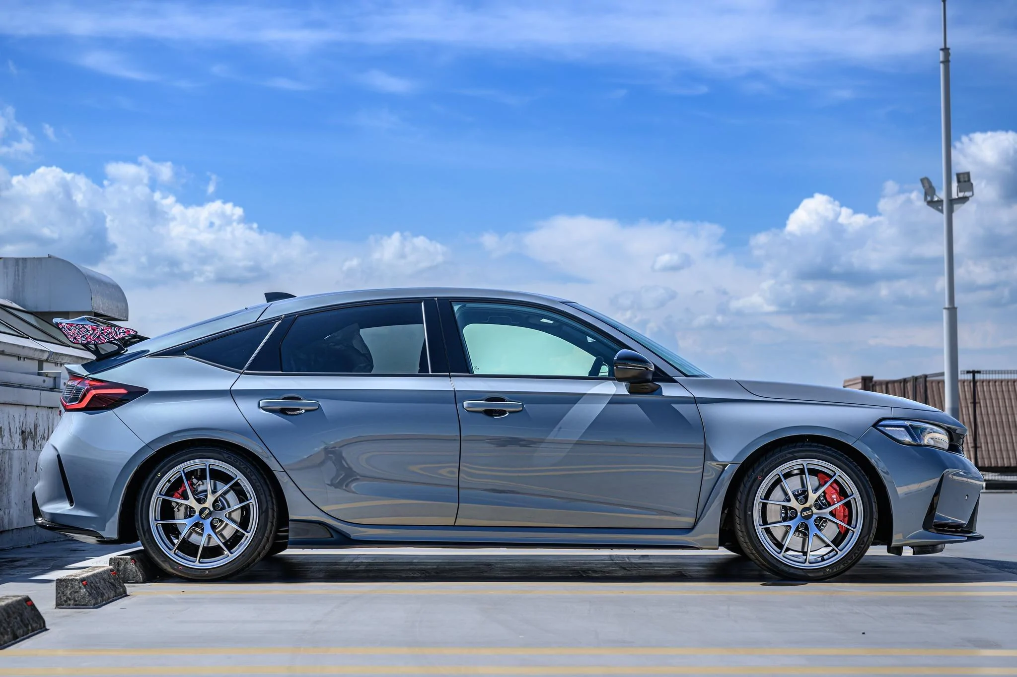

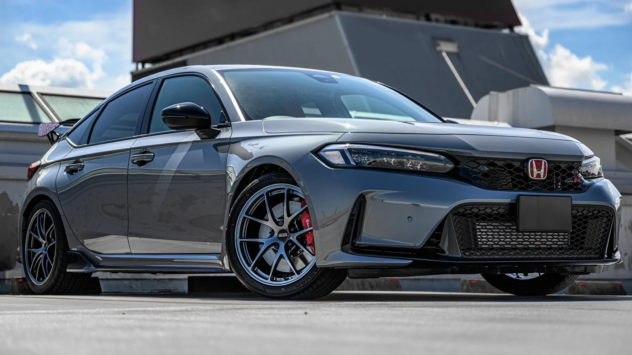

BBS RIA in 18x9.5 +50 in Diamond Black, w/ Yokohama 265/35/18 tires on stock height, equipped on user BigPeriodA's Sonic Gray Pearl 11th Gen Civic Type R!
These look very good. I am not a fan of the protruding wheel look that 45mm and less give. For me it's somewhere between 50 and 60mm offset. I wish the MF10 came with 50-52mm. MITA has a knockoff MF10 in that range, does anyone have experience with MITA wheels?

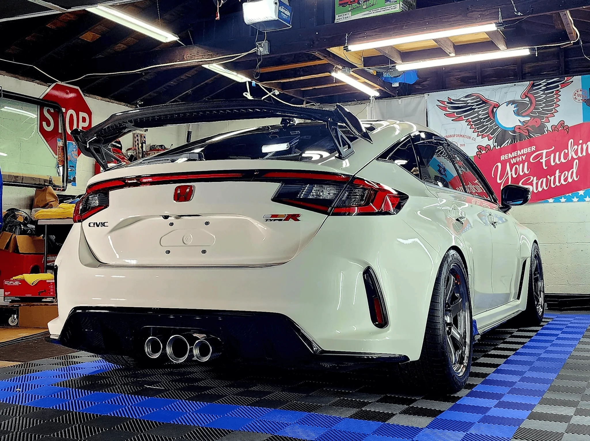

Champ White x 18" Pressed Graphite TE37 on our client's car!
11th Gen Honda Civic Official Wheel Fitment Thread for 11th Gen FL5 Civic Type R 1697654430232
