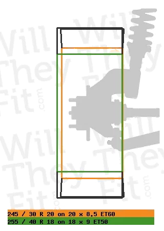

Inner clearance will be limited to around 9.5 ~50-55, before it is far too close to the inside. 11" likely would not work.
Do you mean there is 5-10mm of clearance inside? 50-55 offset pushes wheel out 5-10mm.
On my FK8 I ran 255/40R18 on 9.5x18 +50 Weds.
11th Gen Honda Civic Official Wheel Fitment Thread for 11th Gen FL5 Civic Type R 1702909773971
" Compared to your existing wheel, this new wheel will have an inner rim which is 3.6mm further away from the suspension strut. The outer rim will poke out 16.4mm more than before. "

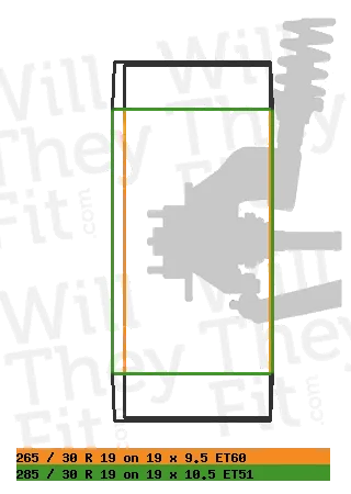

Thinking of buying 10 or 10.5x19 for DE5.
11th Gen Honda Civic Official Wheel Fitment Thread for 11th Gen FL5 Civic Type R 1702911275955
" Compared to your existing wheel, this new wheel will have an inner rim which is 3.7mm closer to the suspension strut. The outer rim will poke out 21.7mm more than before. "
Dont think 10x19 +50-55 would have any issues at all.
