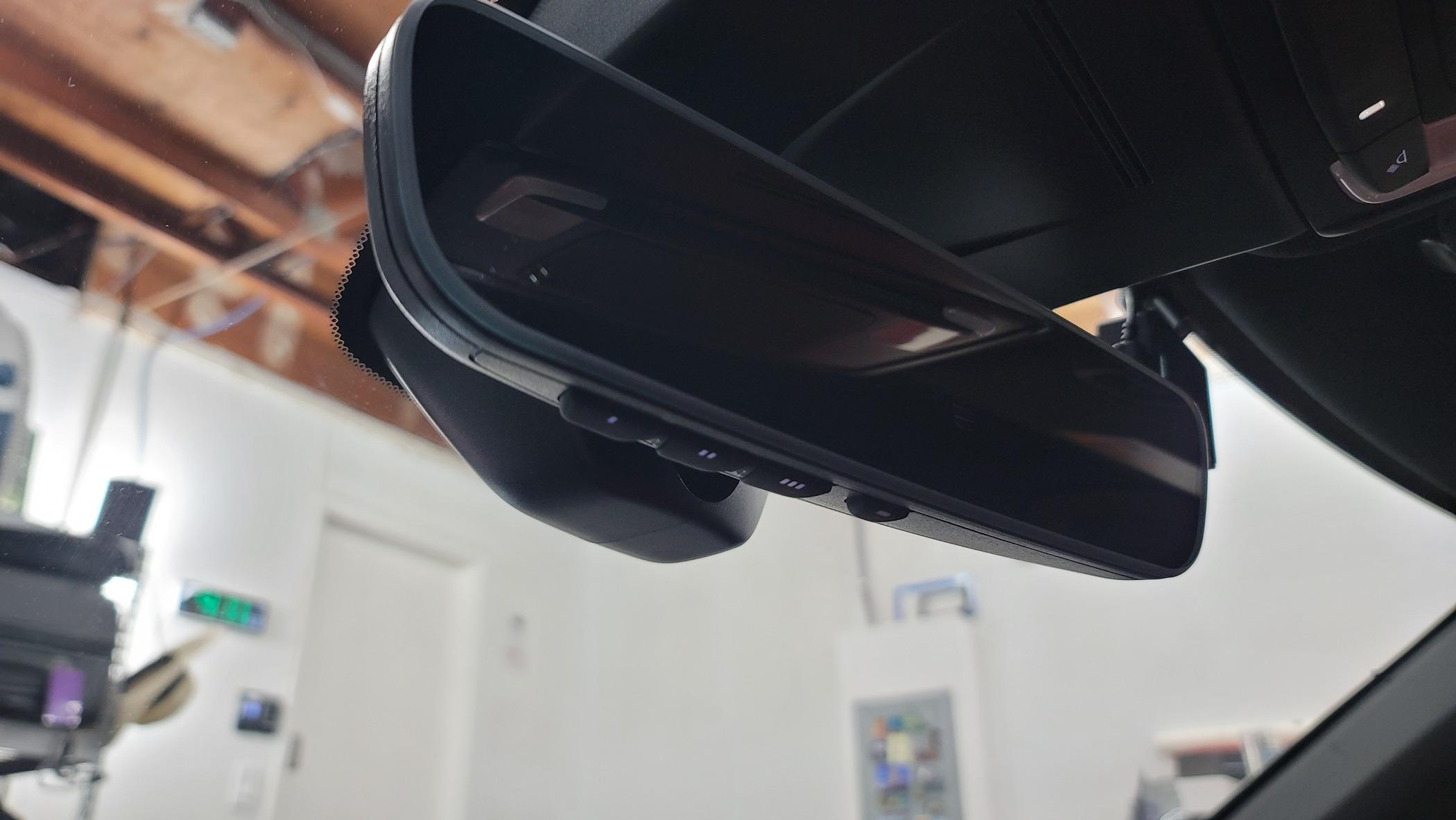

I installed my mirror today. I was being super gentle as I hate prying apart plastic. The A pillar clip seems to be single use only - make sense, as it's probably related to the pillar air bag and the way the clip is designed to pop off with certain force.
I did not re-use my old clip even though it looked perfectly fine.
Thank you to the OP for pics and part numbers!

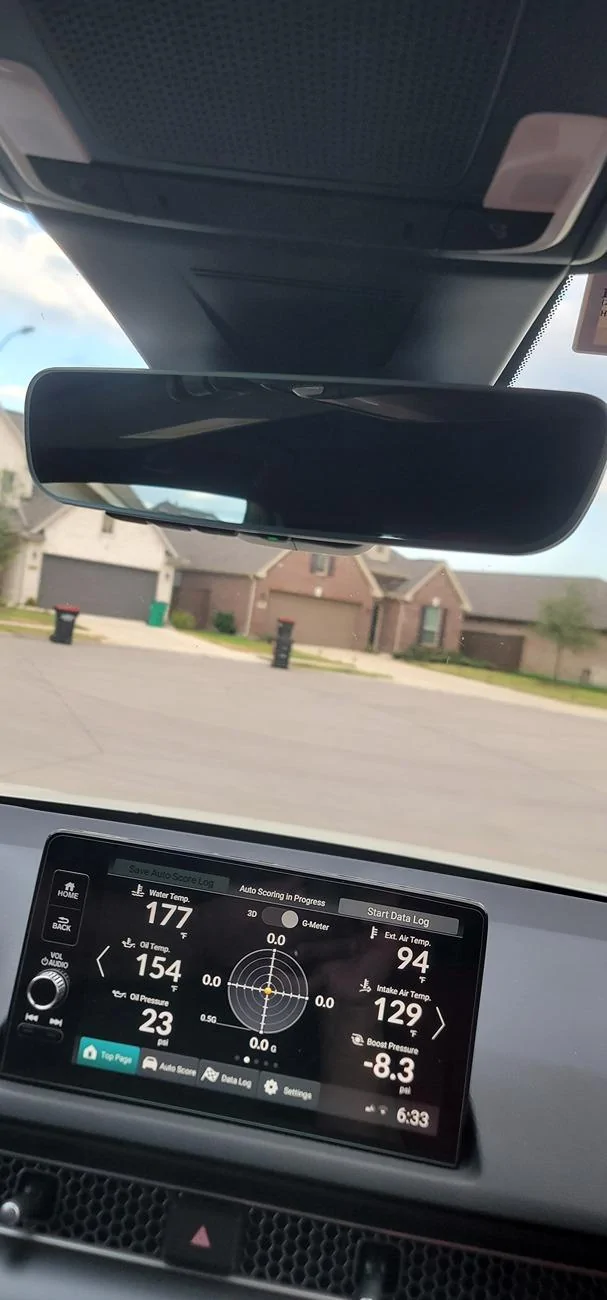

Thank you all. It works great and easy install.
