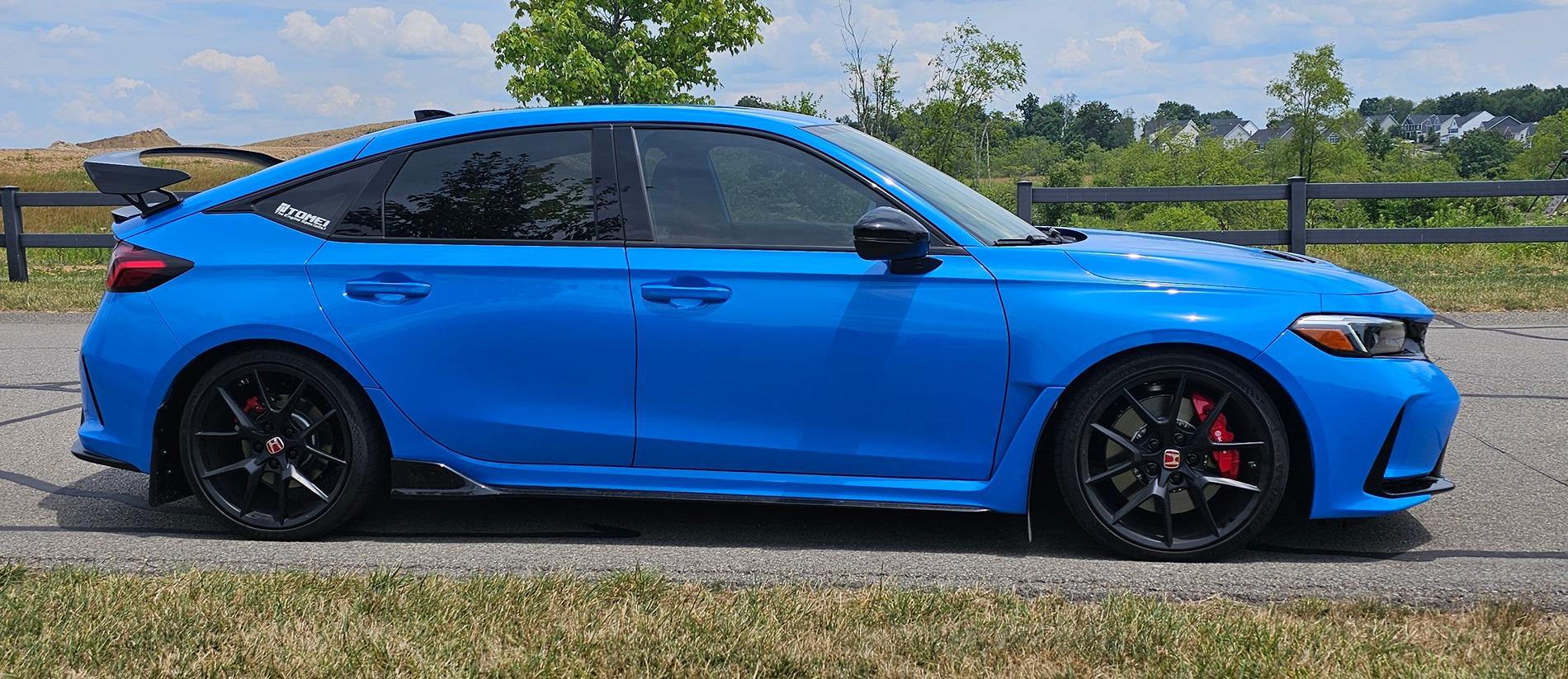

I have H&R installed and ride quality increased, along with better dampening in R mode.

How much of a drop is this? Do you know? Thanks!
.75 Front
.60 Rear
