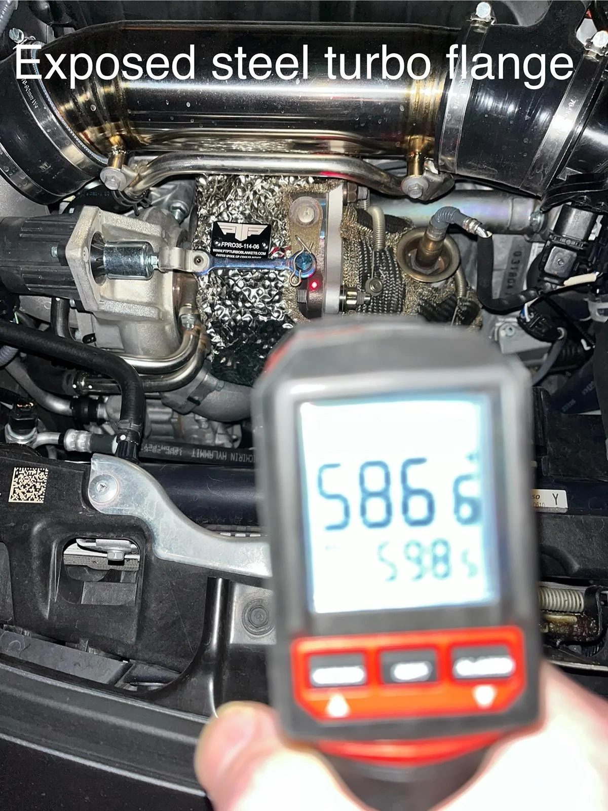

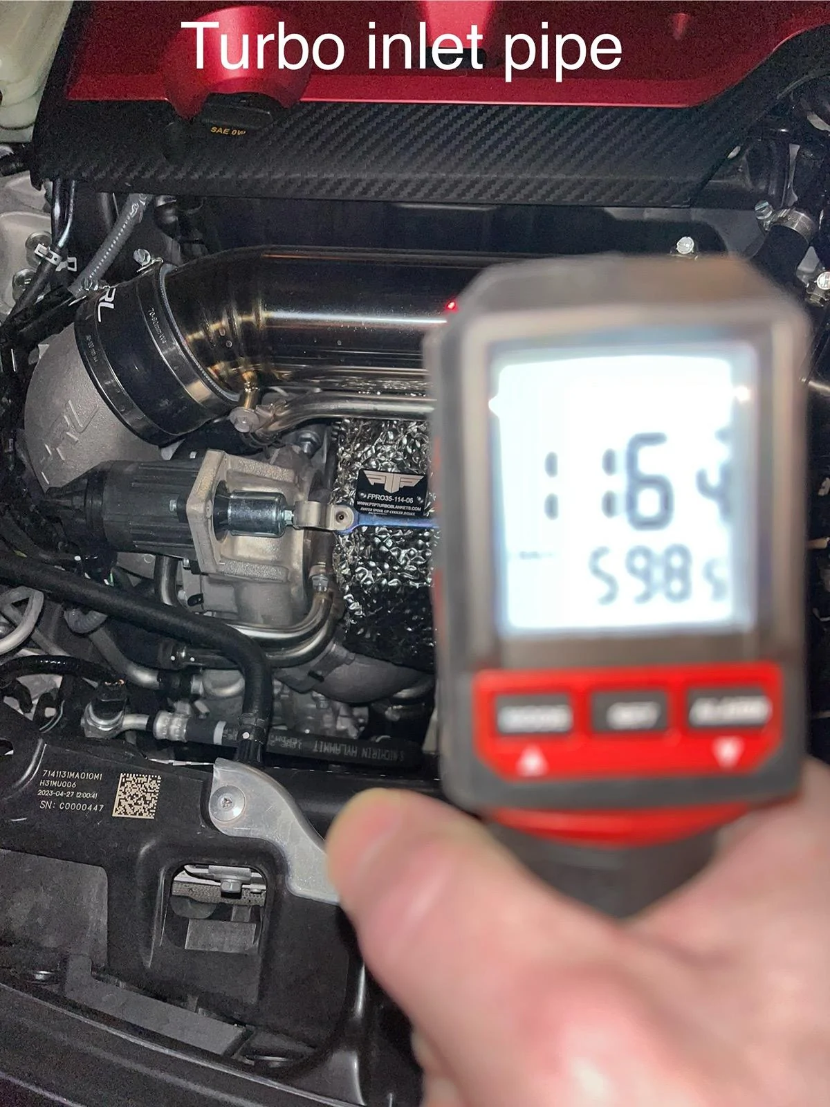

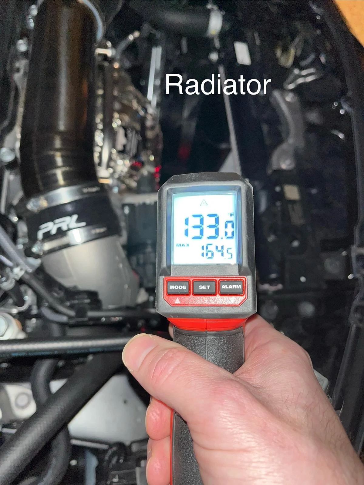

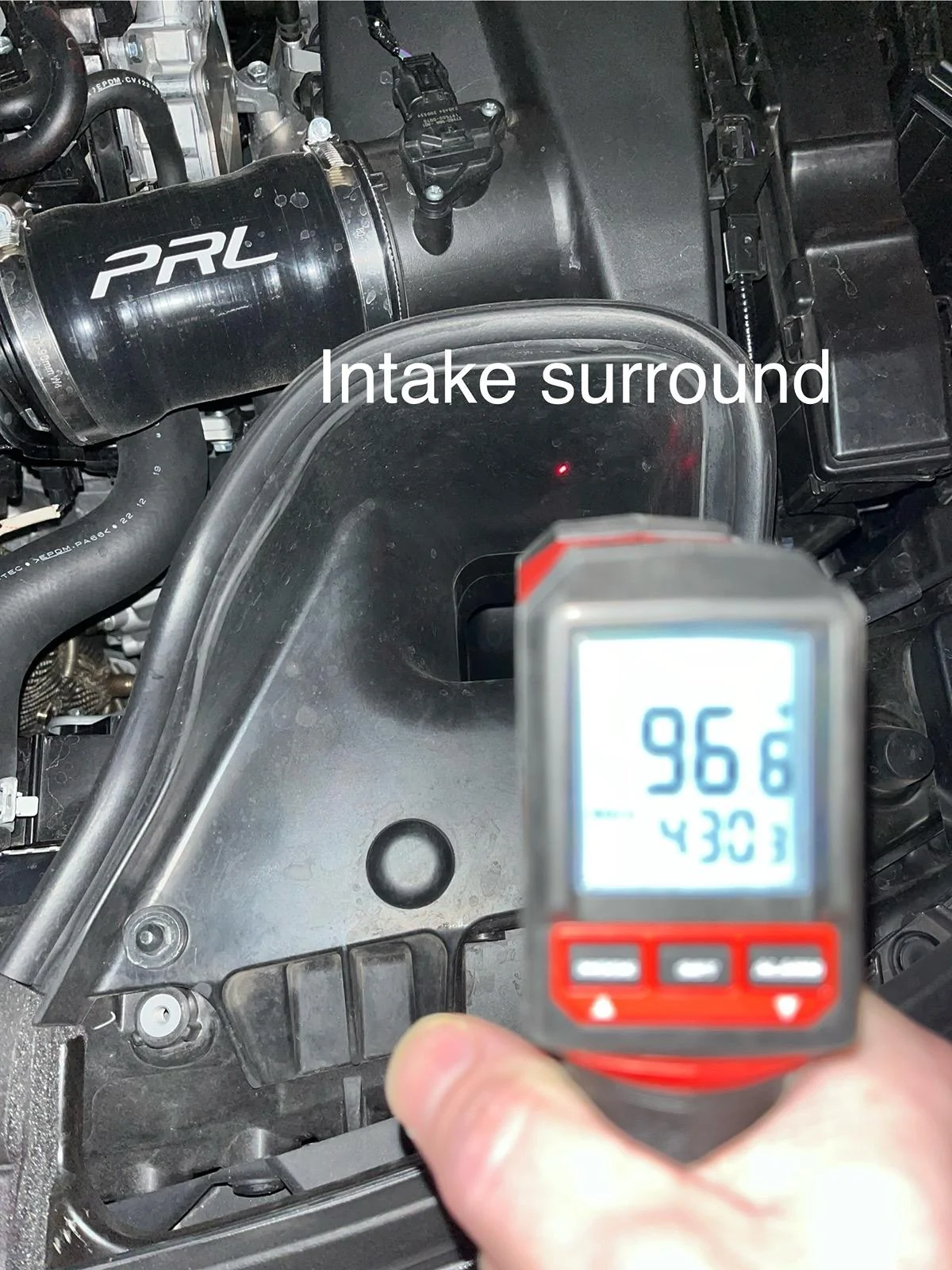

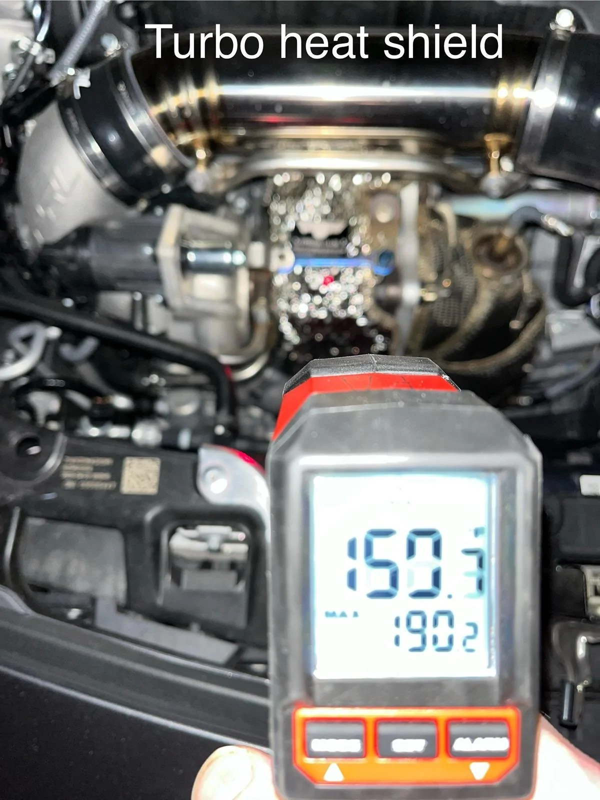

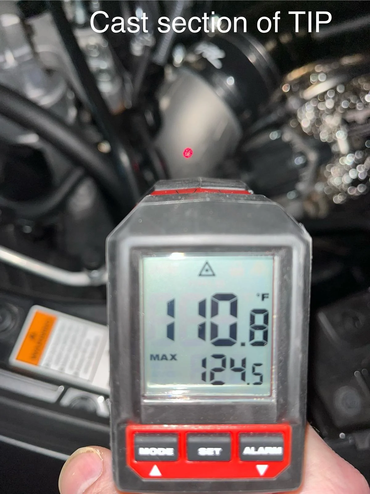

Point taken...So it would seem that a reason to replace the stock turbo inlet would be to eliminate it as a heat sink. I presume a replacement would also provide a less strictive flow internally. That does not seem to be worth a $500 upgrade to me at this point.
Blankets will help substantially more than the TIP. Took these immediately a couple hard runs. The PTP hybrid shield will be available in a month or so through TSP and temps were in the mid 100's if you can wait.
