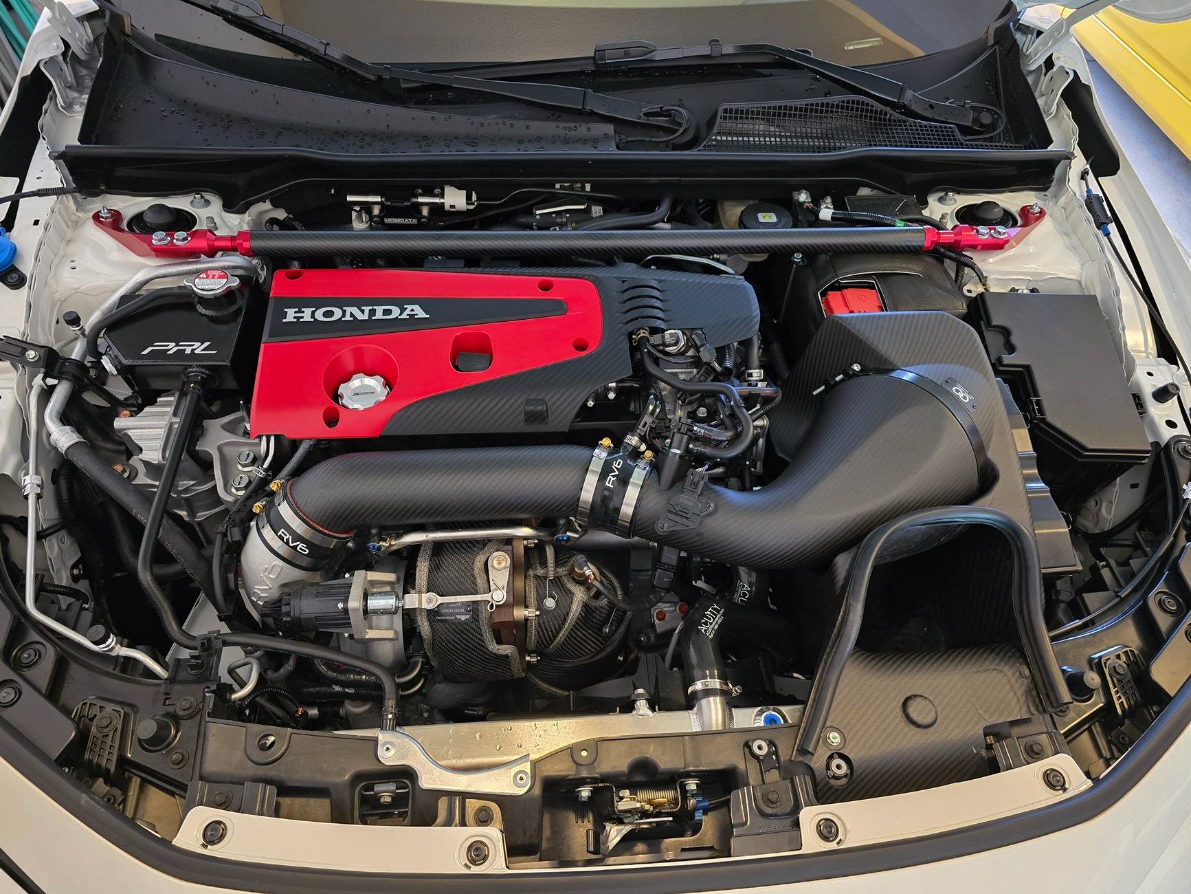

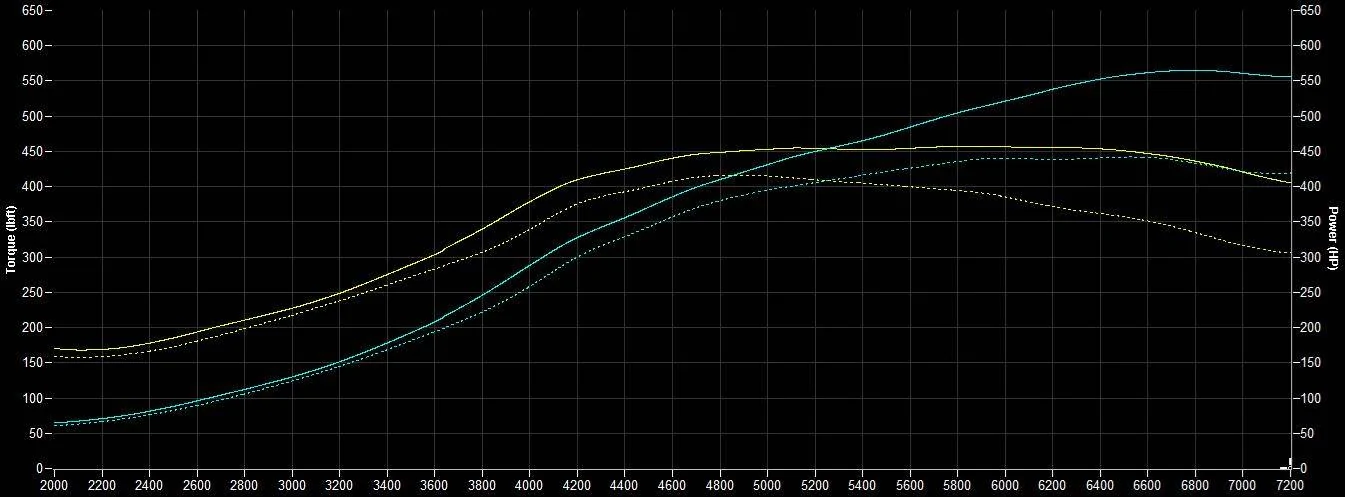

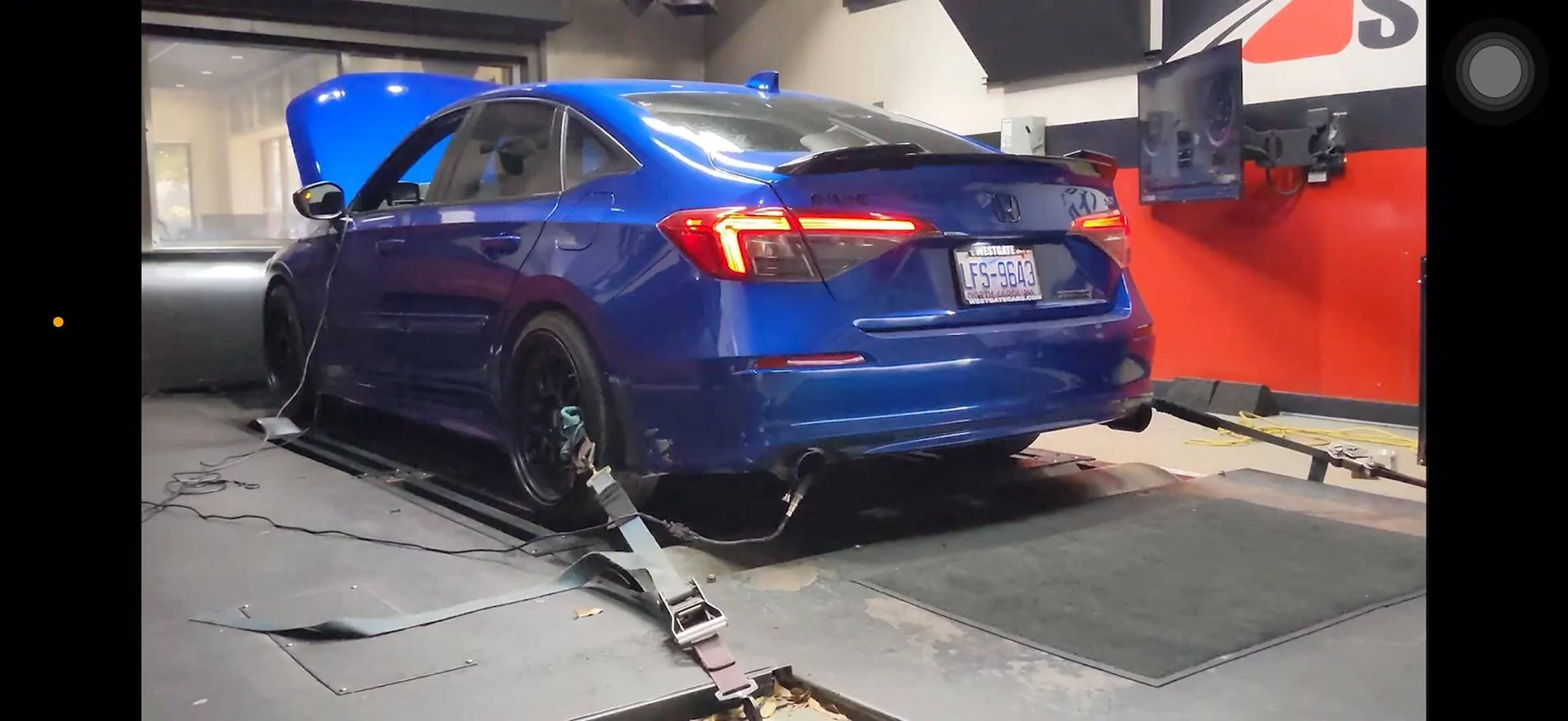

167
2024 Civic Type R, 2006 S2000
Vehicle: 2024 Civic Type R
Total tuned time: 9 months
Tuned miles driven: 4000
Tuning device(s) used: Flashpro
Tunes used: IMW Custom tune
Fuel used: 93 octane and e85
Additional related mods:
R660AS Anti Surge Turbo
RV6 Carbon Fiber 3" Inlet
Full Race HPFP
Deatchswerks DW300C LPFP
Hondata 1530cc Injectors
Infinity Designs Carbon Fiber Intake
PracWorks Carbon Fiber Intake Manifold
PRL intercooler
PRL charge pipes
TSP Down Pipe
RV6 Front Pipe
Apexi N1 Catback
Hondata CanFlex
PTP Blankets (Turbo and Downpipe)
Acuity Reverse Flow Radiator Hoses
PRL Street Radiator
Exedy Stage 1 clutch
PRL Rear Motor Mount
Problems/issues: None
Driving style: Aggressive
Tuning experience notes: Had to dyno tune because we couldn't get traction for road tuning. 570whp on E50 and could easily go higher if the motor is built
