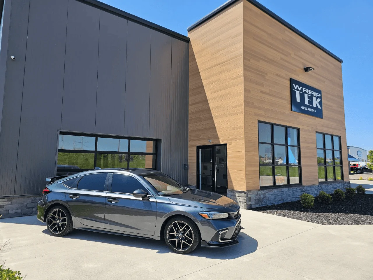

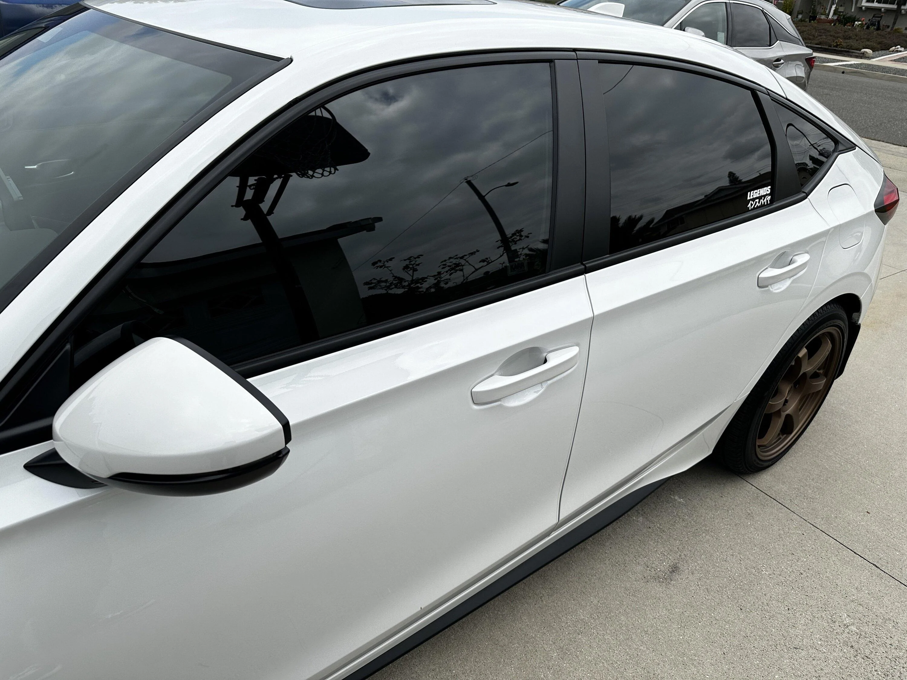

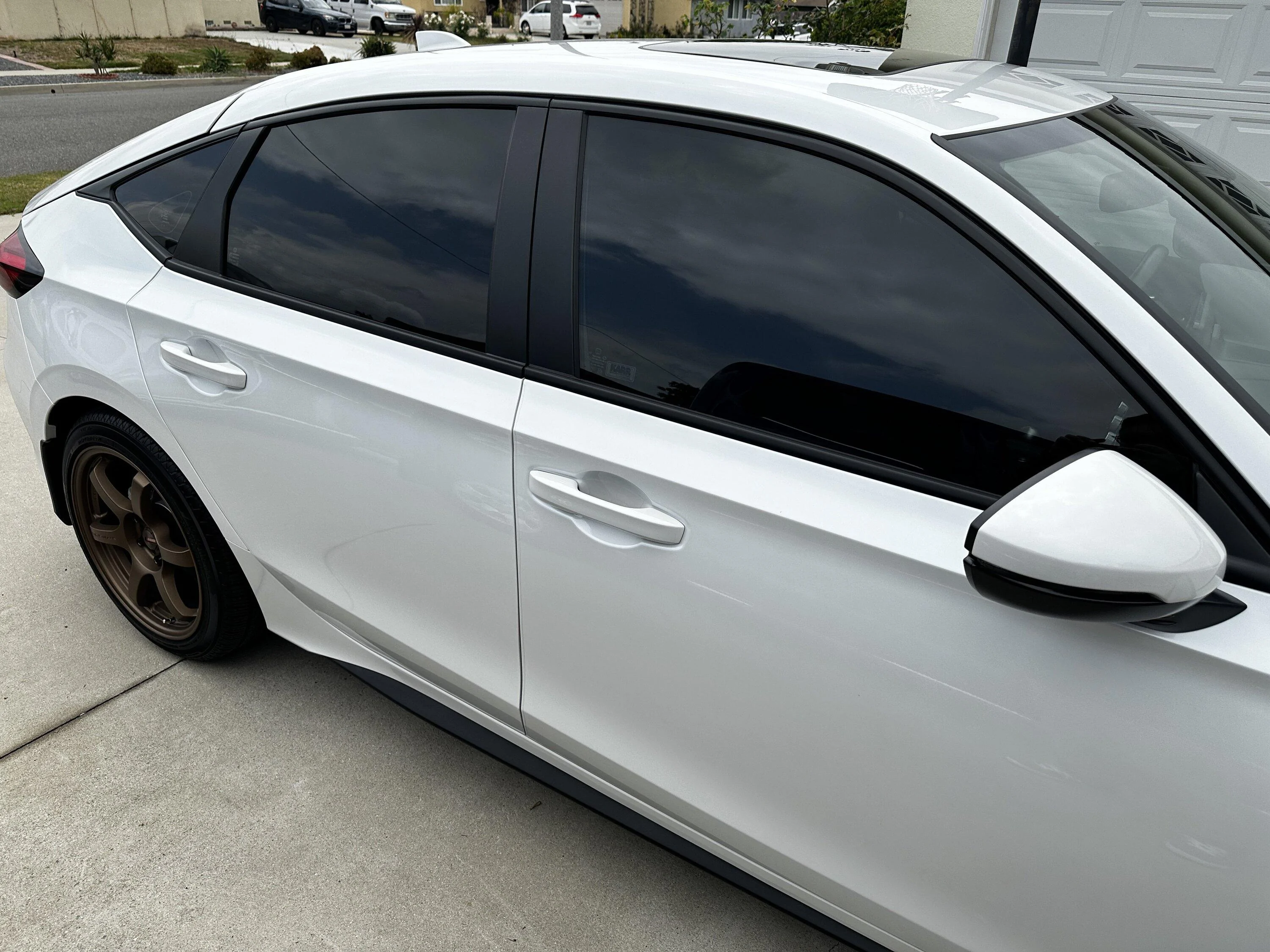

Friday I had an appointment with my local tint-shop. Fairly new building, looks like they came from a small street-side shop and recently developed into a larger warehouse. Reviews looked good so I decided to give them a shot! So far everything is settling in nicely. The windows dont show any signs of defects, no crappy eges or anything. Super happy with the results!
Windshield isn't tinted. I thought of doing 75% just to block UV Light and keep the heat out. But I've seen people complain any tint wont be *as clear* as pure glass. So I decided not to tint it. Everything else is 20% Ceramic tints. This is my first car I've owned with tints and so far I'm very happy with the results. Its great ( and weird ) to no longer feel heat from the sun beaming into the car. At night,headlights behind me are no longer overly annoying. I have astigmatism and 2 headlights behind me in the rearview is like major stars blowing out. With the tint, I still easily see them, but the 'exploding out stars' are WAY smaller and less distracting. Driving during the day..night..sunrise..etc, I dont feel 20% is too dark. Can still easily see objects/people/etc at night with the tints. So I'm pretty happy I didn't go darker. I woulda done 25% if they had it, but I'm still happy. Still gotta replace my front-center lip though! Blew that up during halloween when a street was littered with tons of pumpkins bashed up.
Laws in my state ( Michigan ) Is absolutely no limit on the rear or rear-side windows. Go as dark as you want. The front-side and windshield cannot be tinted to ANY %, below the first 4 inches. So even 75% wouldnt be allowed on the front-sides unless its only 4 inches. Thankfully, Cops don't check that here unless its beyond black. In my area especially, I'd say out of 100 cars, every 60+ vehicles are blacked out darker than I got even. They ( thankfully ) just don't care.

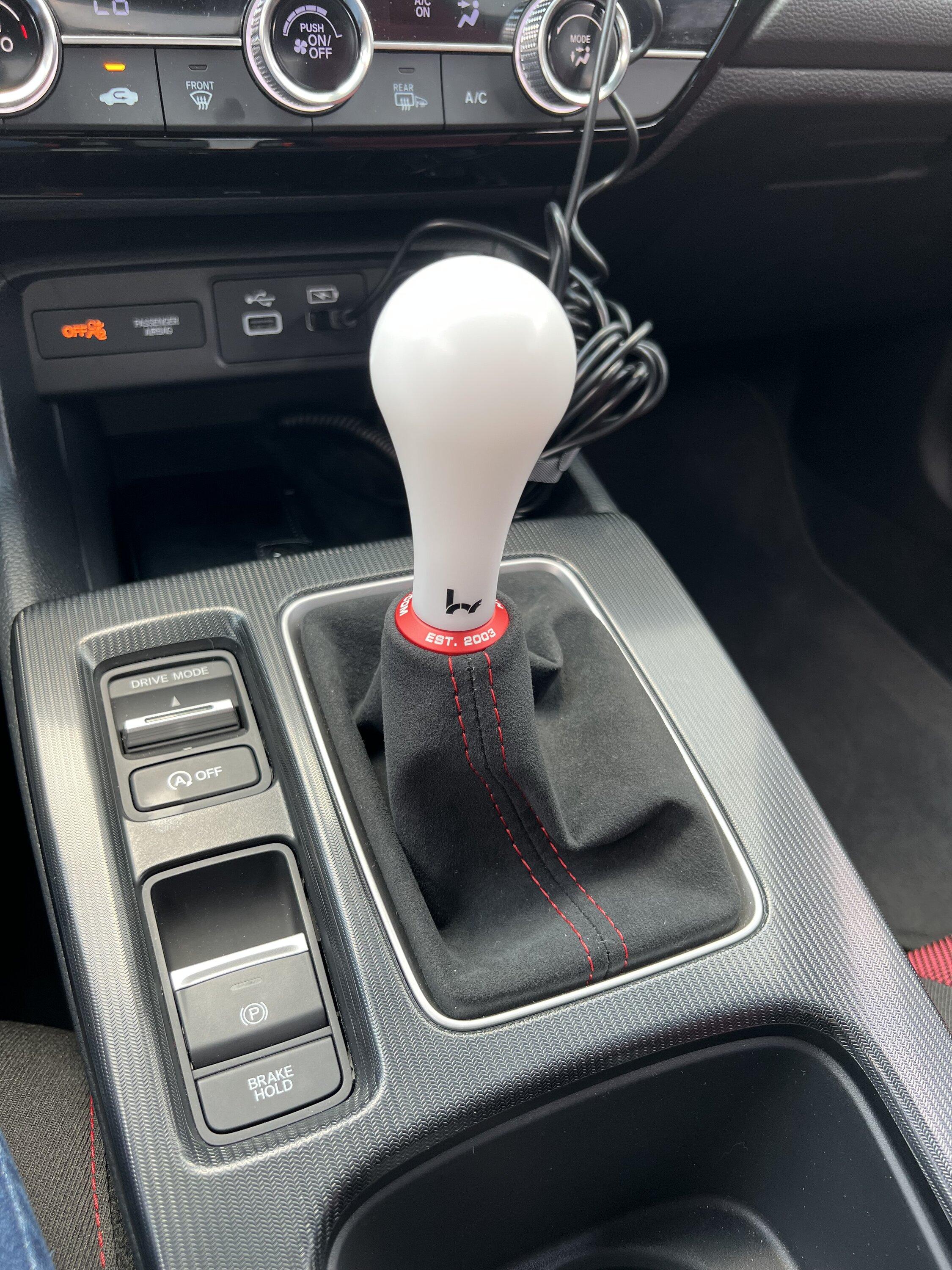

I put on this shift boot yesterday, and it looks so much better than the OEM one. It meshes very well with the shift boot collar and knob. Very happy with it!

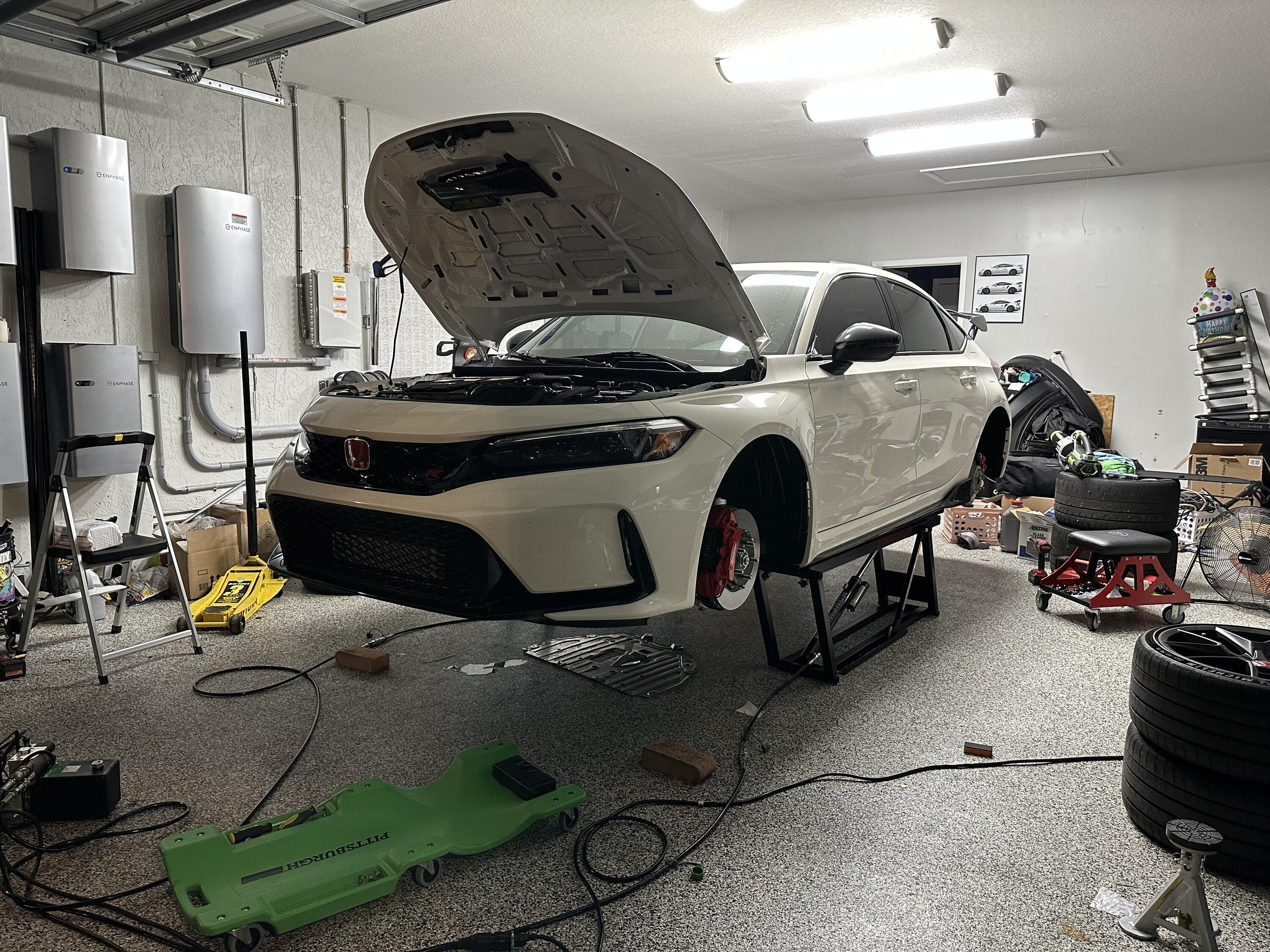

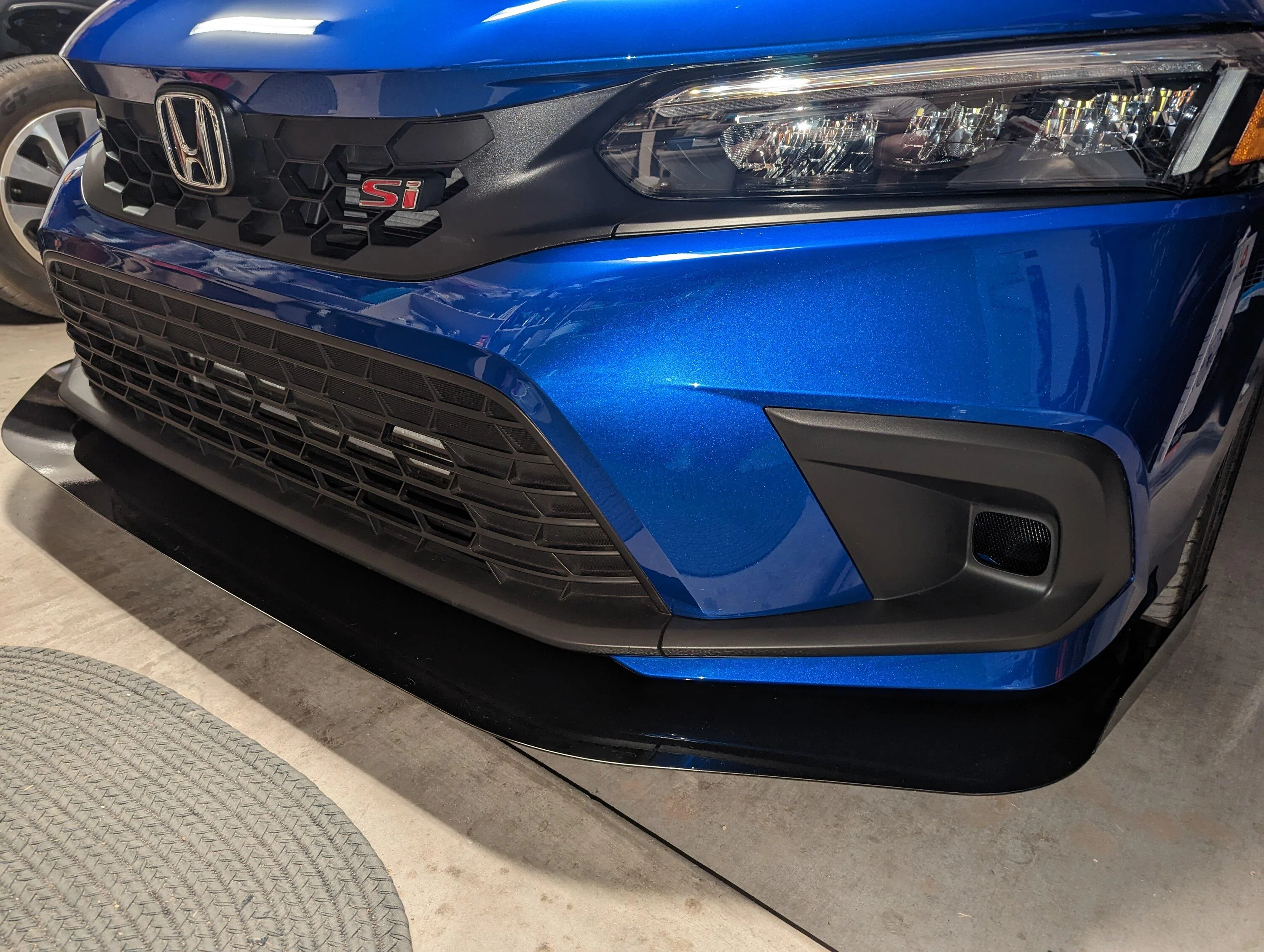

Installed my Aeroflow Dynamics front splitter. It's a pain if you don't have help.

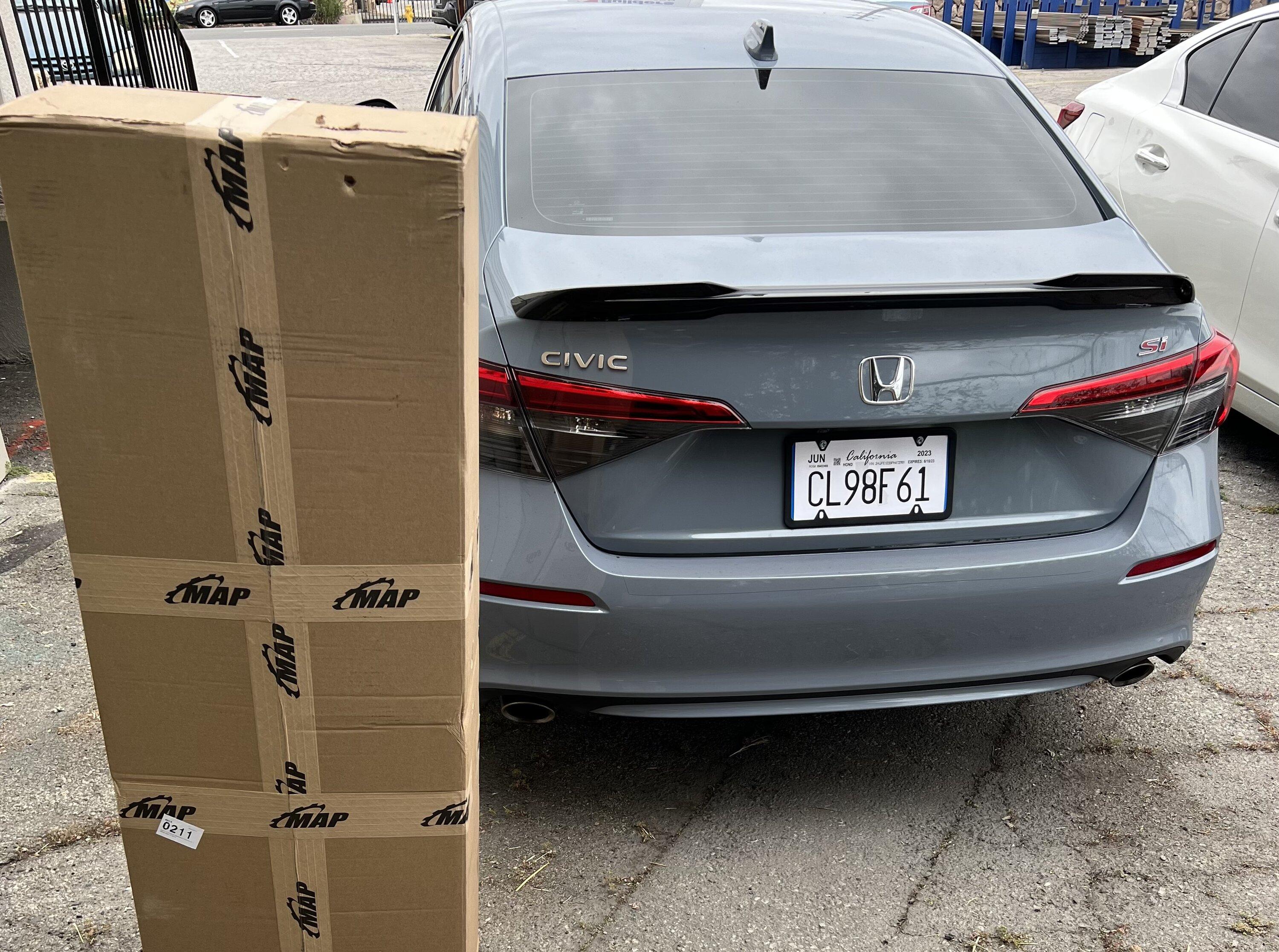

Sup y’all ,
Ended up getting the MAP street exhaust ?
I placed my order with them on Friday 6-9-23 was delivered today 6-12-23! @MAPerformance thanks again

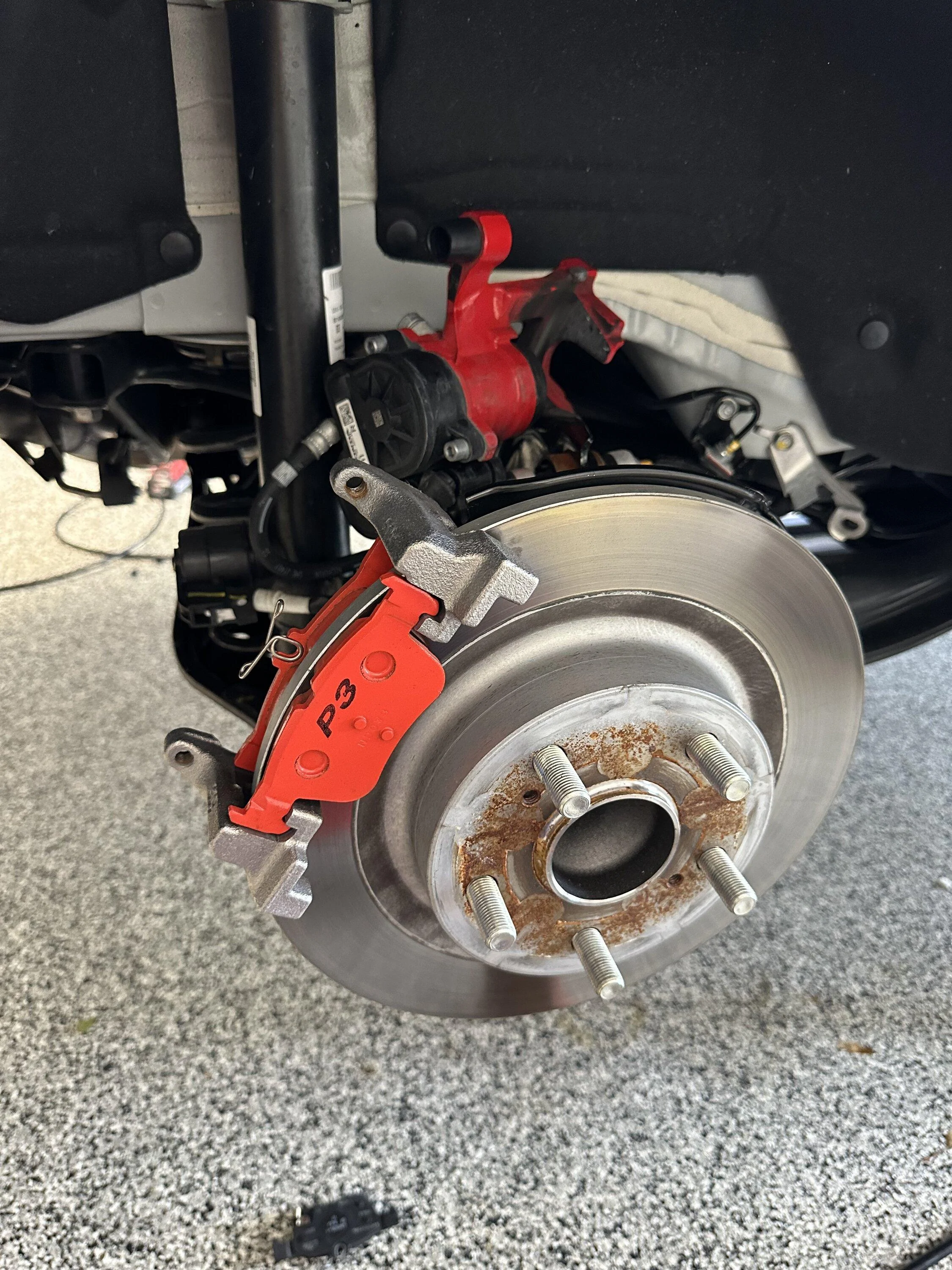

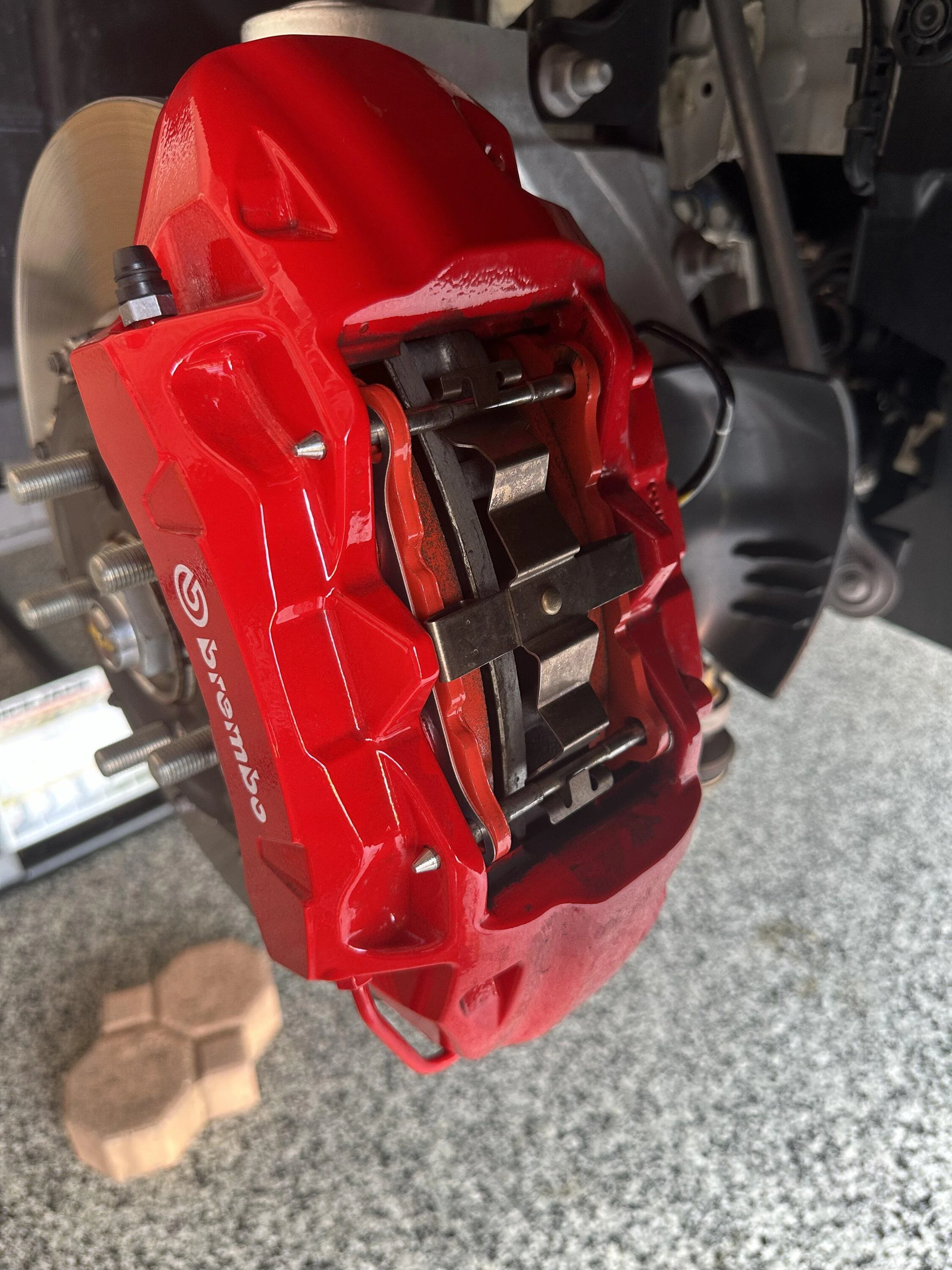

Paragon R5 front and P3 rear brake pads, with Paragon titanium shims on the front. This setup was recommended to me by @Unity Performance on Facebook and after my intial drive to bed them in and feel them out, I think they'll perform really well.
The Autel AP200 was easy to use and worked really as expected to release the rear parking brake.
Track wheels and 275/35/18 V730s coming next week. Will flush the fluid with Endless RF-650 when it's back up in the air for the wheel swap. Running VIR at the beginning of July so it'll need an alignment to get as much camber as well before I head up there.

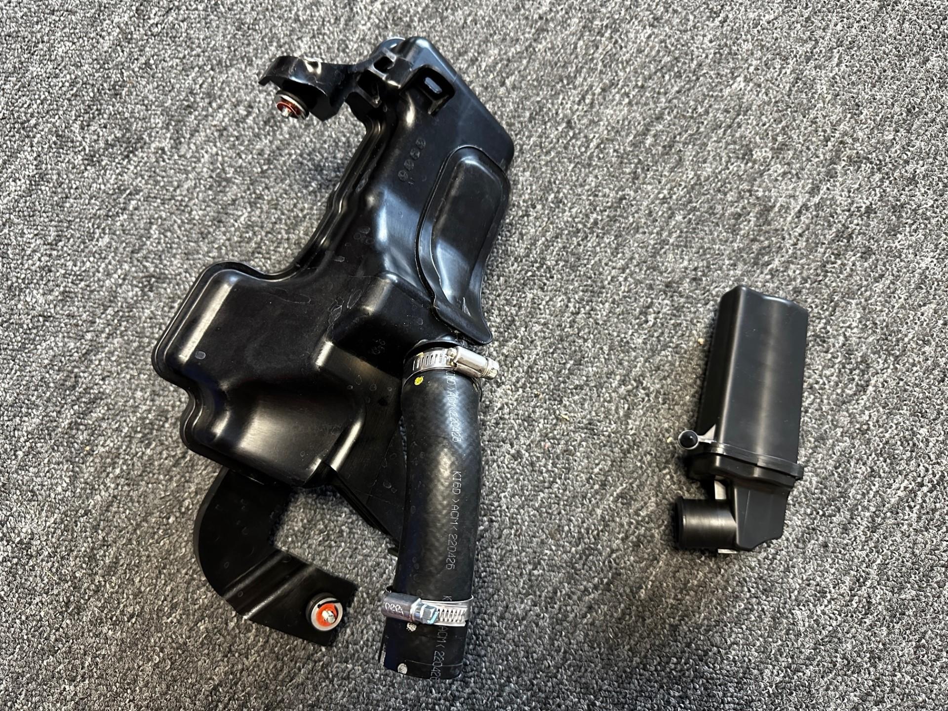

Removed the intake and charge pipe resonators and installed the PRL resonator delete. There was an increase in noises from the intake , blow off and turbo spooling. Is it a considerable increase in sound, no. Was it worth it? Eh, it was only like $40 and maybe 30-45 minutes of time. Majority of that time was taking off the clips, screws and bolts from the air box and fender liner so I didn't have to remove the bumper.

Now get the HVI and cold air add on and you'll hear it all.

Thanks Balu! Sad you sold the car already but definitely got yourself into a sweet upgrade! Did you get to try out the Paragon setup on track?
