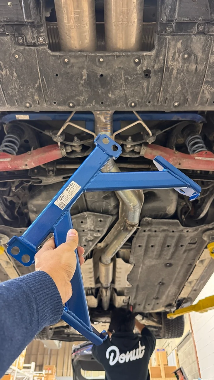

It works great TBH and I feel minimal to not NVH. But I don’t mind getting it even stiffer to see if it helps even incrementally more.
I've seen people say the PRL RMM is even softer than the Hasport U62A but I have no idea how they can tell unless they had both for over a month each to really know. I just installed a Hasport U62A last week and have no idea how much more softer a PRL would be. At the rate I take this car out to drive and go through enough gear changes it might take me 6months to fully break in the RMM.

BLUF: Performance Alignment + Track & Competition Tires + Rear Motor Mount is a good start. Once you have seat time with the aforementioned, reassess and determine next steps.
You’re already on the right path. That floaty feeling under acceleration is exactly what the rear motor mount fixes, so the fact it transformed the car tells you you’re focusing on the right areas. Not sure what your use case is but for aggressive street driving on canyons, mountain roads, or the equivalent I would not jump straight into adding a bunch of hardware. Start with a proper performance alignment and better tires like Michelin Pilot Sport Cup 2 or Pirelli P Zero Trofeo RS in a wider size. More front camber and more capable rubber will do more for stability and confidence than most bolt-ons. You will feel it immediately in turn-in, mid-corner grip, and how composed the car feels under power. From there, make an assessment and determine next steps.
On lowering springs, I would strongly caution against them if your goal is real performance. This is a polarizing topic and I'm sure the fanbois will rush in with post-purchase rationalization, but lowering springs are not the ticket. They change spring rate and ride height without re-matching the damper curve, which disrupts how the FL5’s suspension is designed to control wheel movement. If you want to keep improving, a rear sway bar is the next logical step to help rotation without hurting compliance. If you decide to go further, skip springs entirely and move to a complete system like Öhlins Road & Track coilovers where the spring and damper are designed to work together.

A rear sway is the best mod to do. It's immediately noticeable improvement with almost no disadvantage. The collars are a subtle but weird improvement. Gets rid of that cheap rattly feel to a more refined feel, like a European car.
I agree. My Spoon rear sway bar helped with my turn in again.
