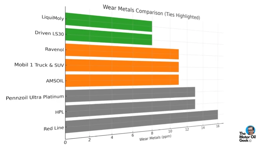

It did poorly on the total wear metals count:
11th Gen Honda Civic 🔴💊 Engine Oil Red Pill Thread: Only Post If You Have UOA - Official Honda Civic Type R K20C1 Engine Oil Analysis 1765381703932-xt

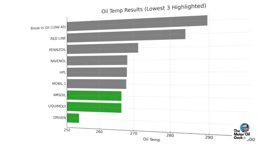

It did poorly on temperature:
11th Gen Honda Civic 🔴💊 Engine Oil Red Pill Thread: Only Post If You Have UOA - Official Honda Civic Type R K20C1 Engine Oil Analysis 1765381773422-ot

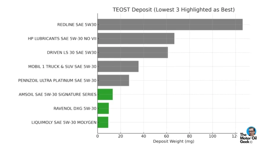

Middle of the pack on the TEOST test to determine turbo deposits:
11th Gen Honda Civic 🔴💊 Engine Oil Red Pill Thread: Only Post If You Have UOA - Official Honda Civic Type R K20C1 Engine Oil Analysis 1765382416728-ka

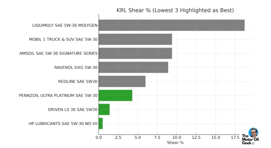

Fairly decent (with a big asterisk, explained below) on the KRL shear test, which tests "High Temperature, High Shear" (aka HTHS)
11th Gen Honda Civic 🔴💊 Engine Oil Red Pill Thread: Only Post If You Have UOA - Official Honda Civic Type R K20C1 Engine Oil Analysis 1765382350311-ua

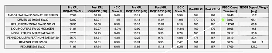

I would caution that the above graph just shows a difference from the original viscosity after the KRL shear test, rather than the absolute values. If the oils all start out at different viscosities and then end up in the same place, the percent change is a bit meaningless if what matters to you is the ultimate, working viscosity. That's an important distinction because the initial viscosity of the oil doesn't matter all that much unless you are doing VERY frequent oil changes. You can see values from after the HTHS test in the raw data in this chart, in the 3rd and 6th columns:
11th Gen Honda Civic 🔴💊 Engine Oil Red Pill Thread: Only Post If You Have UOA - Official Honda Civic Type R K20C1 Engine Oil Analysis 1765382176322-a3
As you can see, although the PUP had relatively little shear in this test, the ultimate viscosity after the KRL test still put it in the middle of the pack once the oil was subjected to stress. Realistically, the oils are much closer together in practice than the % change from the KRL test would suggest, and the PUP is in 5th when you look at the post-KRL 100°C viscosities, even though the percent change had it at 3rd.
