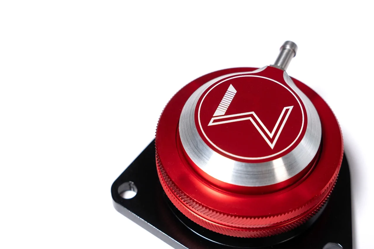

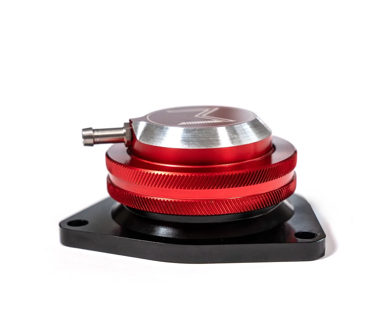

Hello Folks,
Some time in the making, but our upgraded BPV is out now for the latest gen FL5 & DE5 applications. Scoop it up here for $229.99
11th Gen Honda Civic 27WON Billet BPV Upgrade Now Available for FL5/DE5 1782767536521-z8
We've had this Bypass Valve out for the 1.5T applications for a bit, but the shape of the unit prevented fitment for some 2.0T applications. So, we went back to the drawing board and updated the design to work across a wider range of applications. This new version now includes all 2023+ Type R and 2024+ Type S models.
A few callouts
  • Fully recirculating design. No need to worry about fuel wonky trims. This is not a blow-off-valve.
  • Internal metal piston (vs rubber). The rubber on the OEM BPV will degrade and rip over time especially when pushing more boost
  • Billet Aluminum (we ditch the factory stamped steel construction)
  • Works with OEM turbos, both Kuro turbos and any turbo that retains the OEM BPV location
  • This is a serviceable part so we'll supply grease to lubricate the internals. Every 15K is recommend.
11th Gen Honda Civic 27WON Billet BPV Upgrade Now Available for FL5/DE5 1782767562688-l7
Any questions, drop them below.
