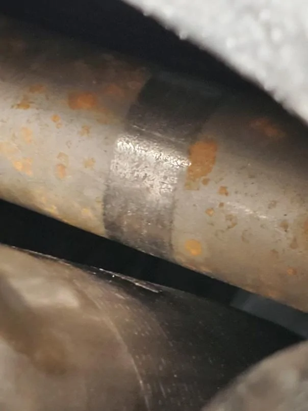

Can anyone answer how close the front pipe should be to the drive shaft? After my last adjustment it started touching there and I don't see away to get more clearance since it's bolted to the dp. It looks like less than a 1/4 inch of clearance on the lift if I drop it down I'm sure it's less. @Unity Performance idk if you have an answer.

11th Gen Honda Civic MBRP FL5 Valved Exhaust now available for FL5 Civic Type R! 20240324_160524
So this is what I've been dealing with. I've noticed that the front pipe is rubbing against the drive shaft, and there is no way to adjust it because it's bolted on to the downpipe. There are also other rattles and noises that can be heard. I've probably had the car on the lift 6 times, taken it apart and re adjusted, and tightened it again and again, I'm done. I'm convinced this is defective. Sorry for the terrible video I did it on the fly.

I gave your video a listen, and I think you've identified the source of your issue--frankly, it sounds like a stunt plane to me, and you're not going to remedy it without a gap between the front pipe and drive shaft.
I didn't get a measurement of the gap on mine, but I remember it being ~1/4". I undoubtedly have a gap, and our cars sound VERY different. I'm truly sorry for all the trouble you're going through, I'd be really frustrated too.
