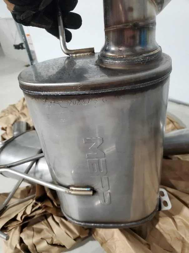

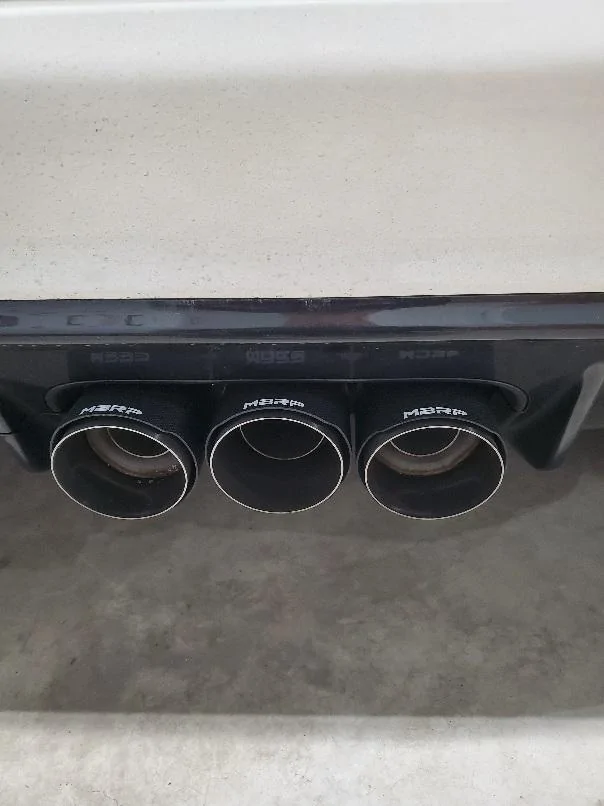

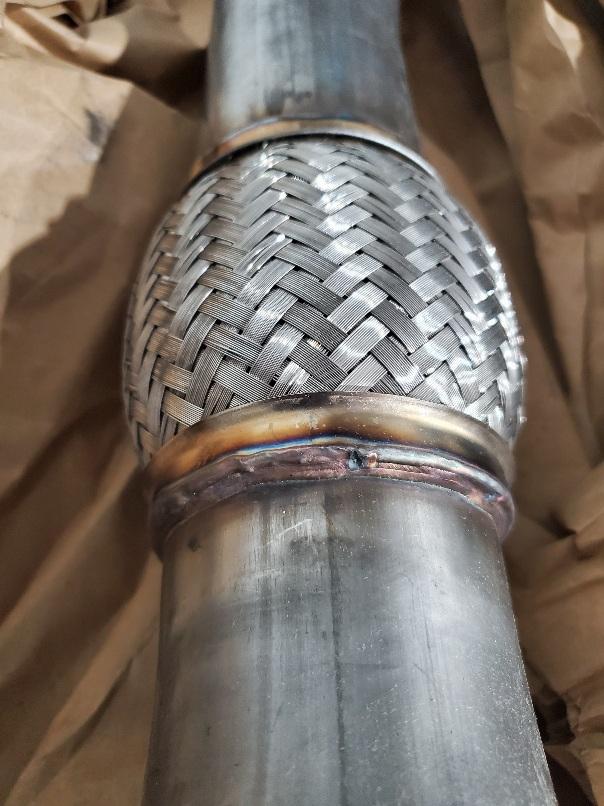

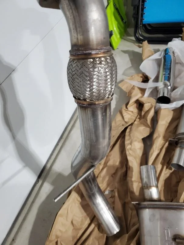

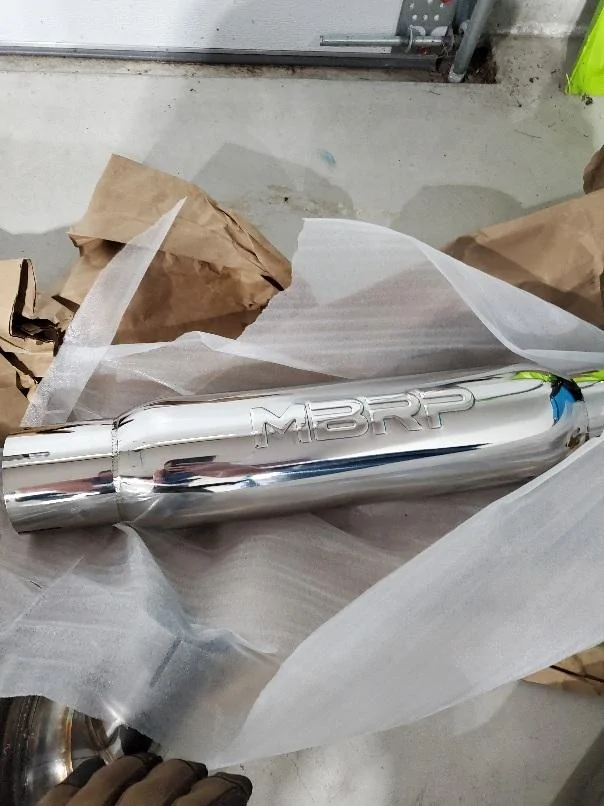

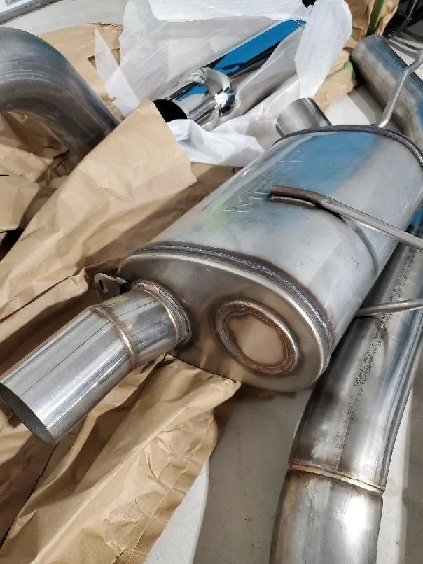

Here are some pictures from before the install. I will say the exhaust is growing on me a bit, you hear a little bit of burbles when upshifting to 2nd and 3rd with regular driving. The exhaust definitely sends more vibrations through the cabin and makes the bar under the seat vibrate like a tuning fork. There is definitely some drone at certain rpm its not terrible and you can manage it with the throttle. I feel like the drone in the cabin keeps me from hearing the exhaust when driving fast, it's just so loud in the cabin. I'd like to hear it after a tune.
As much as I hate to say you've got an installation issue, the bit about the exhaust causing vibrations in the cabin to the point that the back seat vibrates like a tuning fork tells me something isn't quite right.
Without seeing it, I suspect you have the exhaust contacting the car somewhere at/near the rear axle and it's sending that frequency straight into the car. I almost had this issue myself. It may be possible to loosen the exhaust from the optional resonator back and shimmy everything slightly toward the back to fix this issue. I say that realizing everything is rather tight and this is going to be a challenge, sorry about that.
Even 1/4" of space between the exhaust and the frame of the car will make a world of difference, because any contact between that exhaust and metal is going to be audible.
I plan on re checking everything, tighten anything that may have gotten worse. This isn't the first exhaust I've installed I'm fairly certain nothing was touching and everything was sitting well and not moving an inch. Well see and I'll report back. It definitely had gotten better from the first drive.
