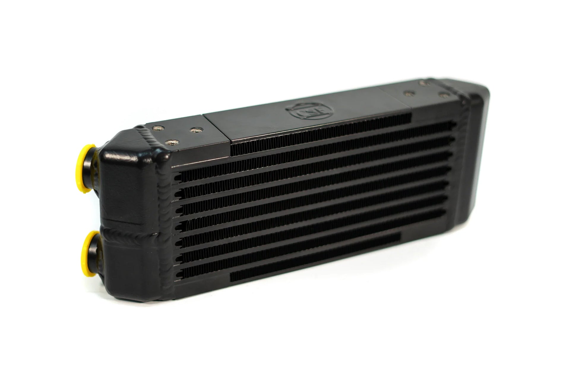

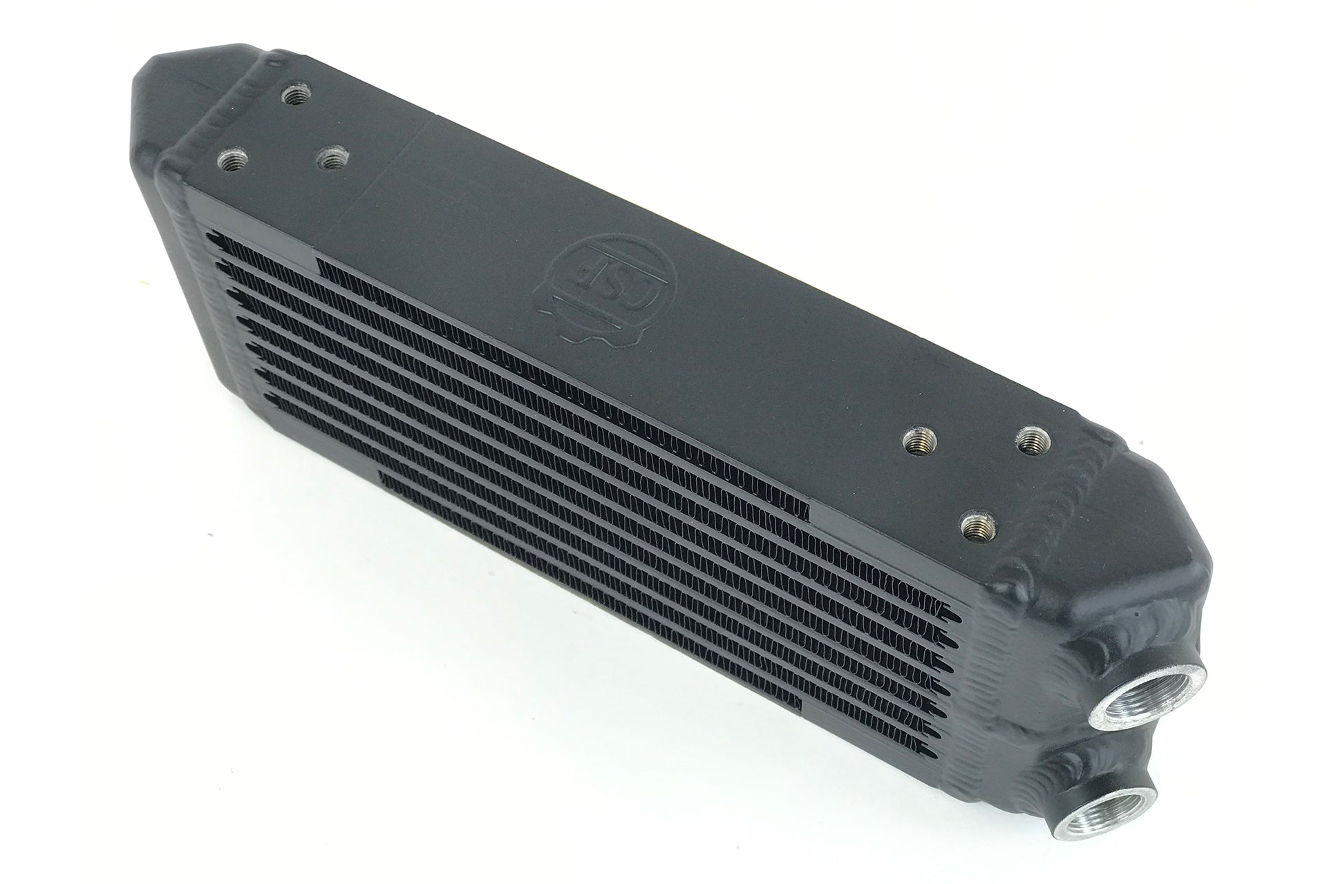

The CSF kit is built around two 13" x 4.5" (33cm x 11.5cm) Dual-Pass Oil Coolers run in series. These High-Performance Coolers offer maximum heat dissipation with uncompromising durability. The Bar/Plate cores feature CSF's "Aero-Flow" Bar Design which reduces weight while offering impressive strength and flow. The rugged design of these cores means you won't need to worry about debris from the track puncturing the coolers like with tube and fin cores.
11th Gen Honda Civic CSF Dual Oil Cooler Kit for FL5 8119_2
11th Gen Honda Civic CSF Dual Oil Cooler Kit for FL5 8119_4
The 100% TIG welded construction with cast end tanks further increases the overall strength of the coolers. Every cooler is pressure tested to 120 PSI before leaving the factory so you can be confident you will never have one burst on you like some weaker designs used in other kits. The end tanks also feature specially designed 40-degree angle feed/return fittings for optimal flow and lower pressure drop.
Oil Cooler Key Features:
  • Bar/Plate Core offers strength and durability
  • 100% TIG Welded Construction tested to 120 PSI
  • Smooth 40-degree feed/return fitting design
  • Dual Pass flow for additional cooling
  • Oil Capacity increased by over 2 Quarts (2 Liters)

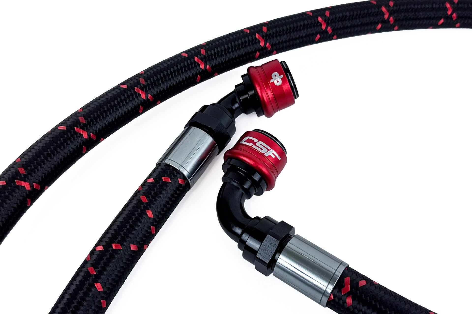

CSF partnered with DYME PSI again for their exceptional quality and innovative quick-release hose and fitting solutions. The DYME Pro/Spec Quick Release Fittings offer race-proven performance with the convenience of tool-free clamshell removal and capable of withstanding up to 10,000 PSI. Quick Release fittings make the installation of the CSF kit much faster than traditional threaded fittings. In addition, they make maintenance like fluid changes much less of a headache.
11th Gen Honda Civic CSF Dual Oil Cooler Kit for FL5 8343_9
11th Gen Honda Civic CSF Dual Oil Cooler Kit for FL5 8343_10
The DYME PSI fittings are hydraulically crimped to their motorsport quality Superstrasse CPE lined 304 stainless steel braided lines. DYME PSI manufactures these lines and fittings in house to CSF exact specifications with the highest level of quality and precision. These lines offer the best flexibility, flow, and chemical resistance possible.

  • Fittings:
      • Forged 6061-T6 Aluminum Body
      • 180° Swivel Adjustment
      • Dual FLUOROK™ FKM Seals
      • Chemical & Heat Resistance up to 401°F (205°C) continuous operation temperature
      • Secure & Permanent Crimp-On connection for high-pressure systems
    • Lines:
      • 304 Stainless Steel reinforcing braid and Polyethylene top braid
      • Burst pressure of over 2000 PSI
      • Suitable for up to 302°F (150°C) continuous operation temperature

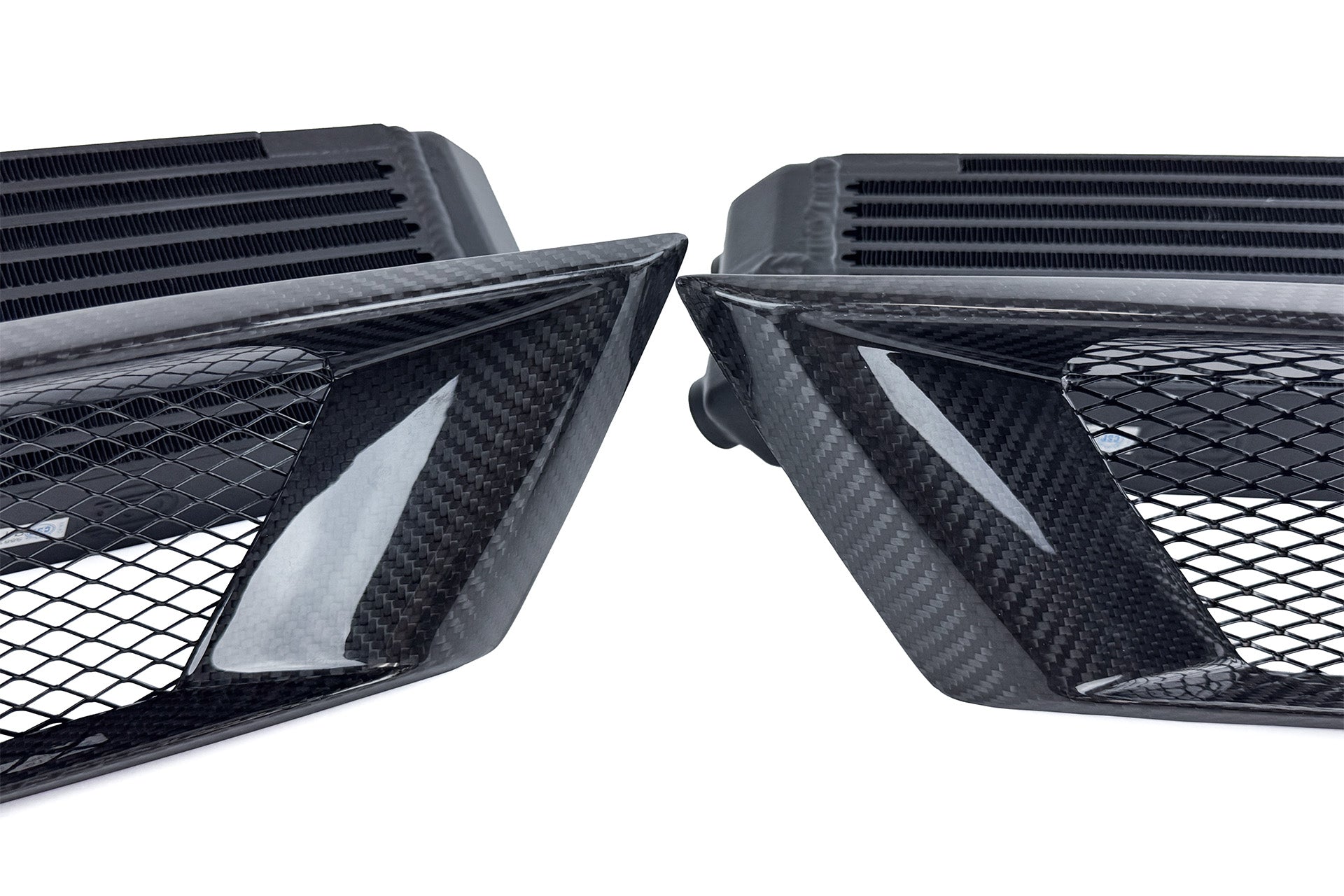

Ducting & Vents

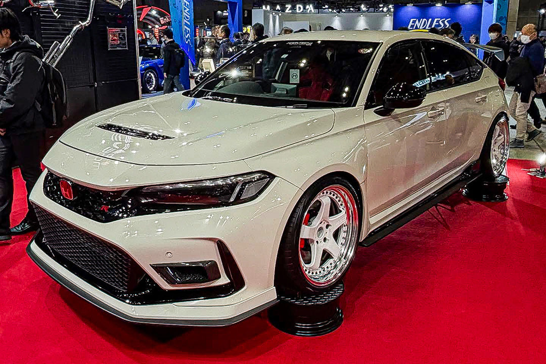

The challenge of getting proper air flow to the oil coolers was straightforward but far from simple. While mounting an additional cooler behind the grill would be the easy choice, that just adds more heat to the rest of the cooling system. The optimal placement for the coolers was in the sides of the bumper outside of having no direct airflow. While technically some air does flow to this area as it leaks around the intercooler, it is not enough for significant cooling performance. While utilizing the brake cooling ducts is a potential option, that could negatively impact braking performance.
11th Gen Honda Civic CSF Dual Oil Cooler Kit for FL5 Light-Paints-3
11th Gen Honda Civic CSF Dual Oil Cooler Kit for FL5 8343_3
11th Gen Honda Civic CSF Dual Oil Cooler Kit for FL5 CSF-1fastvc-FL5-37
CSF designed and modeled vents for the bumper to provide the two oil coolers with ample airflow to keep engine oil temperatures in check. These vents were carefully designed with CFD software for airflow and aero dynamics. Made from pre-preg carbon fiber, these vents match the lines and style of the FL5 and give a very OEM+ look to the front bumper. To further improve airflow and cooling, the kit also includes louvered vents that allow airflow out of the bumper area and into the fender wells.
11th Gen Honda Civic CSF Dual Oil Cooler Kit for FL5 DSC02685
11th Gen Honda Civic CSF Dual Oil Cooler Kit for FL5 8343_7
11th Gen Honda Civic CSF Dual Oil Cooler Kit for FL5 DSC01515

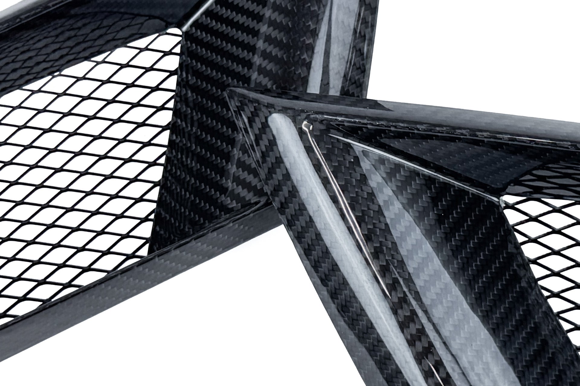

OE Fit and Finish

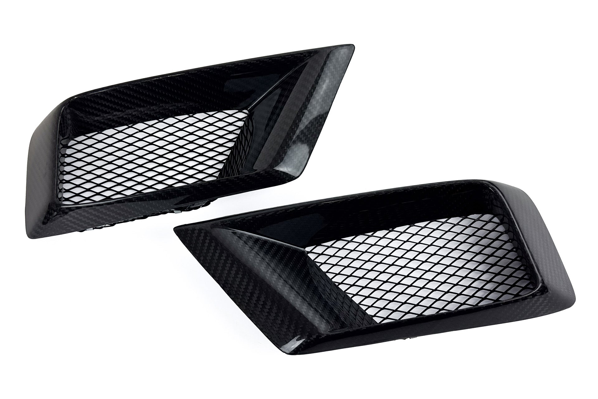

CSF leveraged many industry connections to find the best possible source for motorsport grade carbon fiber. The quality, fit, and finish of these parts are of the highest caliber and have been extensively track tested. Each vent bolts on without the use of double sided tape so they are very secure.
11th Gen Honda Civic CSF Dual Oil Cooler Kit for FL5 8343_4
11th Gen Honda Civic CSF Dual Oil Cooler Kit for FL5 8343_14
Cut out templates are included with the kit instructions to allow for easy installation and ensure proper alignment. CSF also designed templates for the international market with FL5s that come equipped with PDC sensors. The factory PDC sensors will still function perfectly and retain the OE look and feel.
11th Gen Honda Civic CSF Dual Oil Cooler Kit for FL5 moontech.jp_1
11th Gen Honda Civic CSF Dual Oil Cooler Kit for FL5 moontech.jp_2
While there may be kits available that do not require cutting the bumper, they cannot match the airflow and cooling performance of the CSF kit.

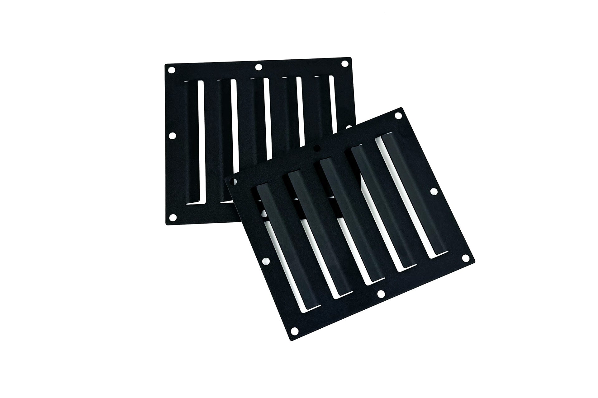

Air Duct Key Features:
  • Motorsport Grade Pre-Preg 2x2 Carbon Fiber Construction
  • OE level fitment and finish
  • Provides optimal airflow to the Oil Coolers vs kits with air deflectors from the center opening
  • Instruction include cut out templates for easy install with motorsport grade hardware (no tape)
  • Laser Cut Louvered Vents for airflow into the wheel wells
*Note: Carbon fiber vents can be refinished as in matte clear or painted. CSF recommends using a qualified paint or body shop for best results.

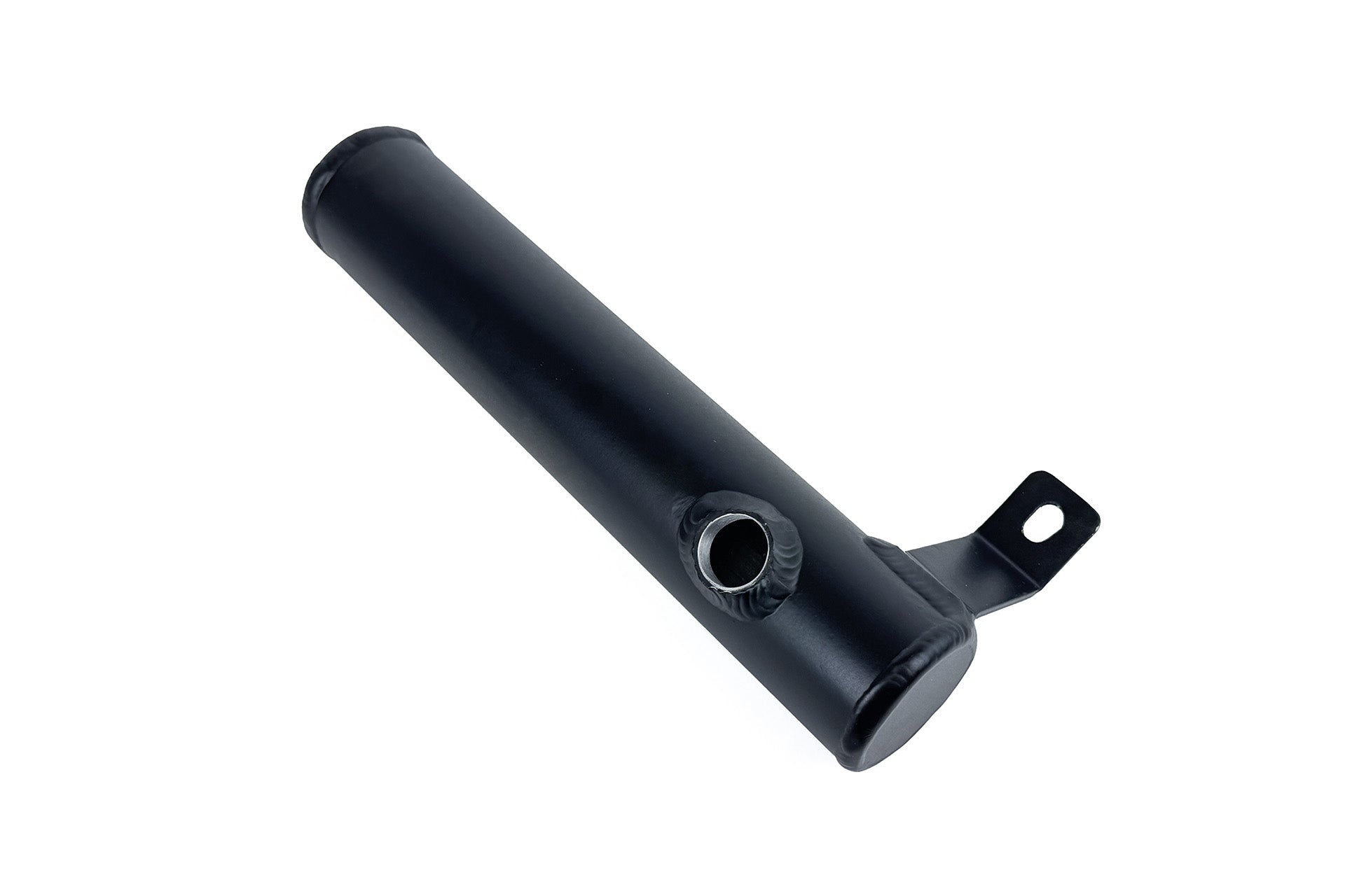

Replacement Windshield Washer Reservoir
To make room inside of the right hand side bumper for both the oil cooler and proper airflow, CSF designed a replacement windshield washer fluid reservoir. This low clearance reservoir/bottle works with the factory pump and filler neck. The engine bay retains a clean factory look while freeing up space in the bumper for the cooler.
11th Gen Honda Civic CSF Dual Oil Cooler Kit for FL5 8343_8
11th Gen Honda Civic CSF Dual Oil Cooler Kit for FL5 8343_13

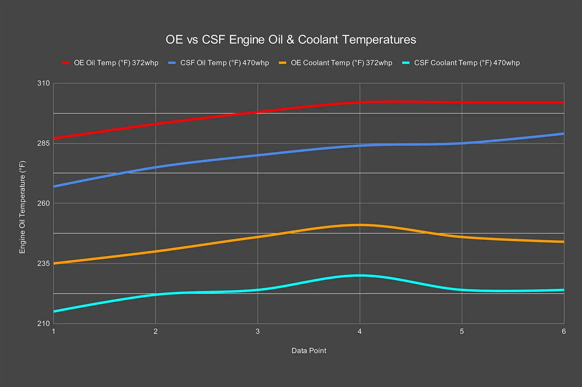

Dyno Testing
For initial testing, CSF turned to the automotive authorities and industry experts at MotoIQ for third party verified data collection. Mike and the team there developed the testing procedures for the prototype baseline data. Temperature readings were taken with two temperature sensors installed at the oil filter housing/sandwich plate for the most accurate readings. The FL5 was first run for 9 consecutive pulls on the dyno at World Motorsport to simulate hard driving and engine oil heat soak. The prototype CSF Oil Cooler Kit was then installed and the same test was conducted again. Average ambient temperature was only 0.5°F (0.3°C) higher on the test with the CSF kit.
11th Gen Honda Civic CSF Dual Oil Cooler Kit for FL5 8343_data-log_1
You can see from the results the CSF prototype kit offered consistently cooler engine oil temperatures throughout the test. On average the engine oil temperatures were about 9°F (5°C) cooler with the CSF kit installed. While the max temperature seen was only 222°F (105.5°C), this gave the engineering team a great comparison data point. This test was performed before the addition of the fender liner vents.
