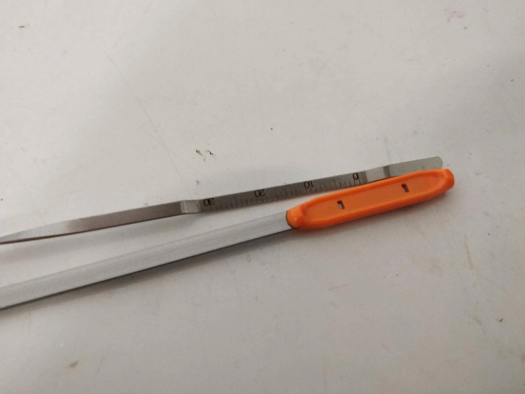

They don't thats why the way to do it is to just mark the metal through the holes on the orange plastic. Then you will have the exact markings. Then also a good idea, saw it done somewhere, pretty sure on this forum, someone made the tip round because its square and be better to be rounded just like a good ole metal dip stick

Where I think you’re getting mixed up is that there are no holes in the plastic. The holes are in the metal. They overmold the orange plastic piece onto the metal. The plastic flows thru those holes and keeps it secured to the metal rod at the correct position…otherwise it would be able to slip off and fall into the engine.

you can see the metal through the orange, can get a sharp object and mark where those are and that is the markings when you remove the plastic orange.

Ah yes! It’s both! I knew I should’ve went out to my car to double check. There are holes in the plastic AND the metal. When the plastic is removed, you’ll see what I’m referring to. ?
