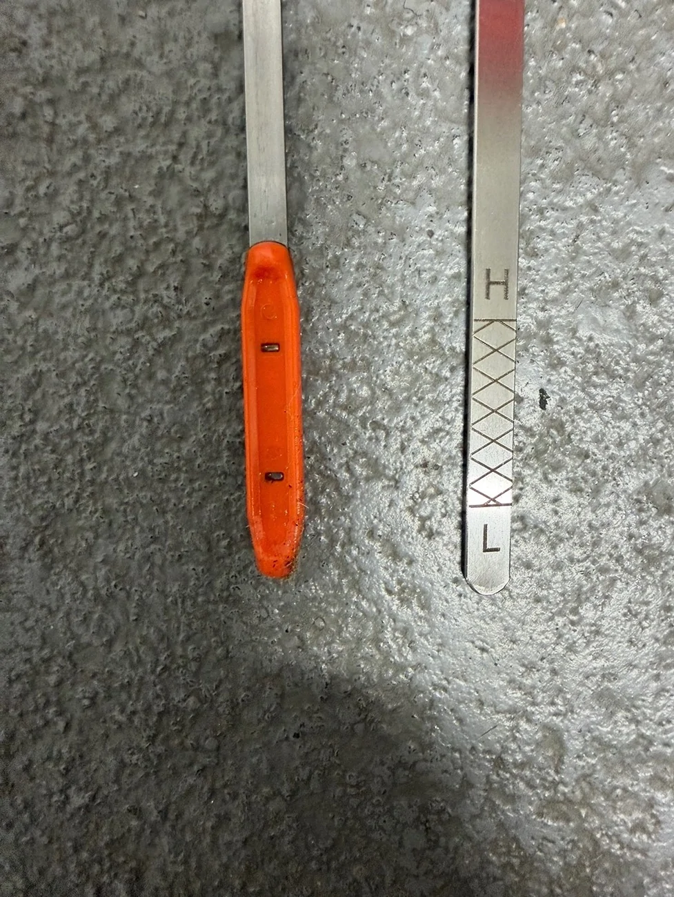

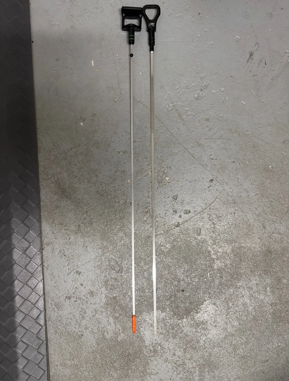

As @TypeRD mentions if the markings don't match its not accurate. They can say the Honda stick is not correct for some reason or there is a leaway but the H and L are very far apart from OEM.
Also yes I could just keep it in the middle but I don't like that, its a $70 dip stick I bought to solve something and now appears to introduce another issue. I understand maybe they make the stick for different cars but this is a type R specific stick, it should have the same markings as the OEM.
As it stands if there is not a good explanation I will be returning it
@Austin@Wunderladen Racing any thoughts?

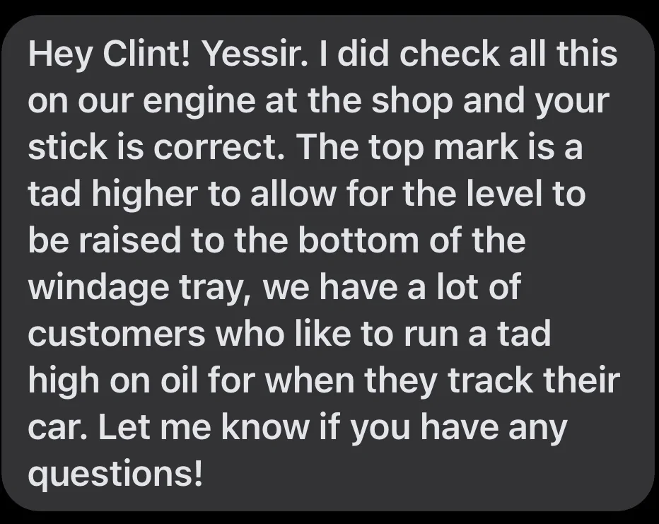

This is the response i had from Austin. And my dipstick compared to the OE dipstick. It should have been matched to fsctory.

slightly higher? thats substantially higher if you line up the bottom mark. Or is the bottom mark also lower?
Honestly this is a huge miss. If you want a mark for the customers that like to run higher oil then you can add a dot or another marking in there.
The low level is too low as well. I match the dipsticks up exactly in the photo. High mark was higher than OEM, low mark was lower than OEM. Im still disappointed buying this.
I wouldnt recommend buying it due to its accuracy.
I am as well.
The options will be return or just mark the High Low with a dot but I just think its crazy that this was not matched to stock, not even close

In case you guys have not seen it yet, Wunderladen did add more detail about the markings on the website's product page:
Note for Type R/S sticks: The high and low markings on our Type R and S stick are spread a bit further to give a wider reading range. The high mark on our stick is set to where the factory windage tray so you are able to run more oil in your Type R/S while keeping it under the windage tray (allows for oil to last longer and maintain pressure better during hard driving) and be able to read that extra oil. We recommend always keeping the oil at least above the halfway point, we have the low mark set a bit lower so you can tell where it is if it's low.​
Note for 1.5T sticks: If you are using our 10th gen 1.5T oil pan baffle and would like to take advantage of the greater oil capacity it allows, the top of the H on our stick is your new full mark for the extra capacity fill. This only applies to this baffle and no others.​
I can understand why this may have been confusing if you did not know their reasoning, but I would definitely consider this a beneficial feature and not a product issue.

Got the same answer as Two Step Performance posted.
I am sorry but this is laughable
" we have the low mark set a bit lower so you can tell where it is if it's low. "
what the fuck does this even mean? we put an arbritrary low mark that does not match what honda is so you know its low.
So the high mark there is a BS reason and for the low mark there is not even a reason, its just yeah its low so you know its low, we made it lower so you know its even lower.
This is just poor product engineering, what is the deal here? A stick that works for multiple cars so you don't have to manufacture more than one?
Like just give us the real reason and stop making us look like we are clueless fools.
