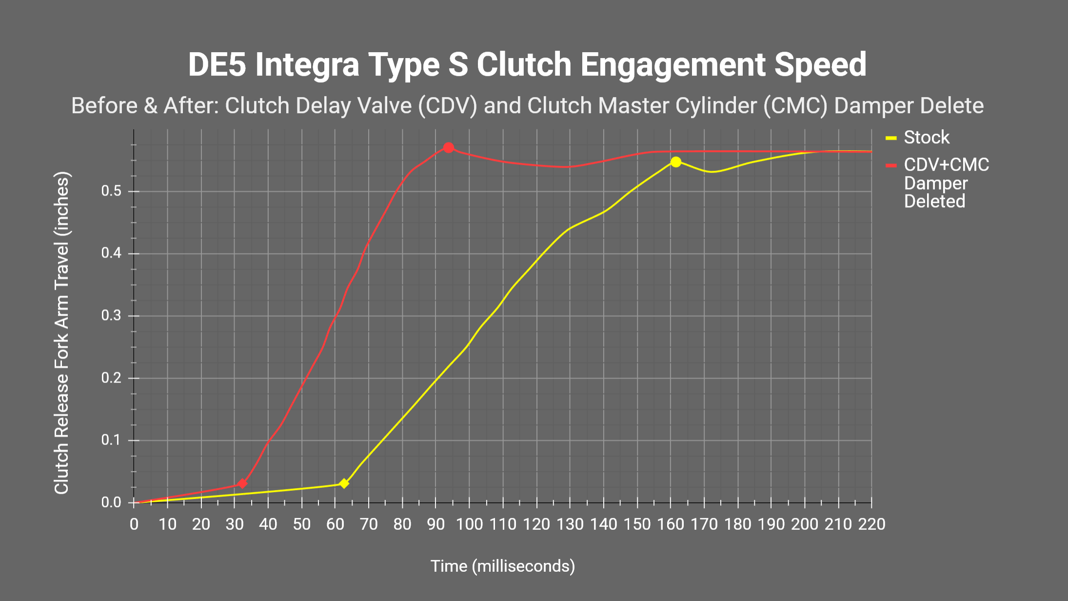

On the X or horizontal axis we have time in milliseconds. On the Y or vertical axis, we have clutch fork travel in inches. In yellow is the data for the stock setup, and red shows the deleted data. This slope of the lines conveys a rate of travel - the steeper the line, the faster the rate.
Just like the video, the difference is quite drastic. The deleted setup is actually 58% engaged by the time the stock setup begins to move at full speed.

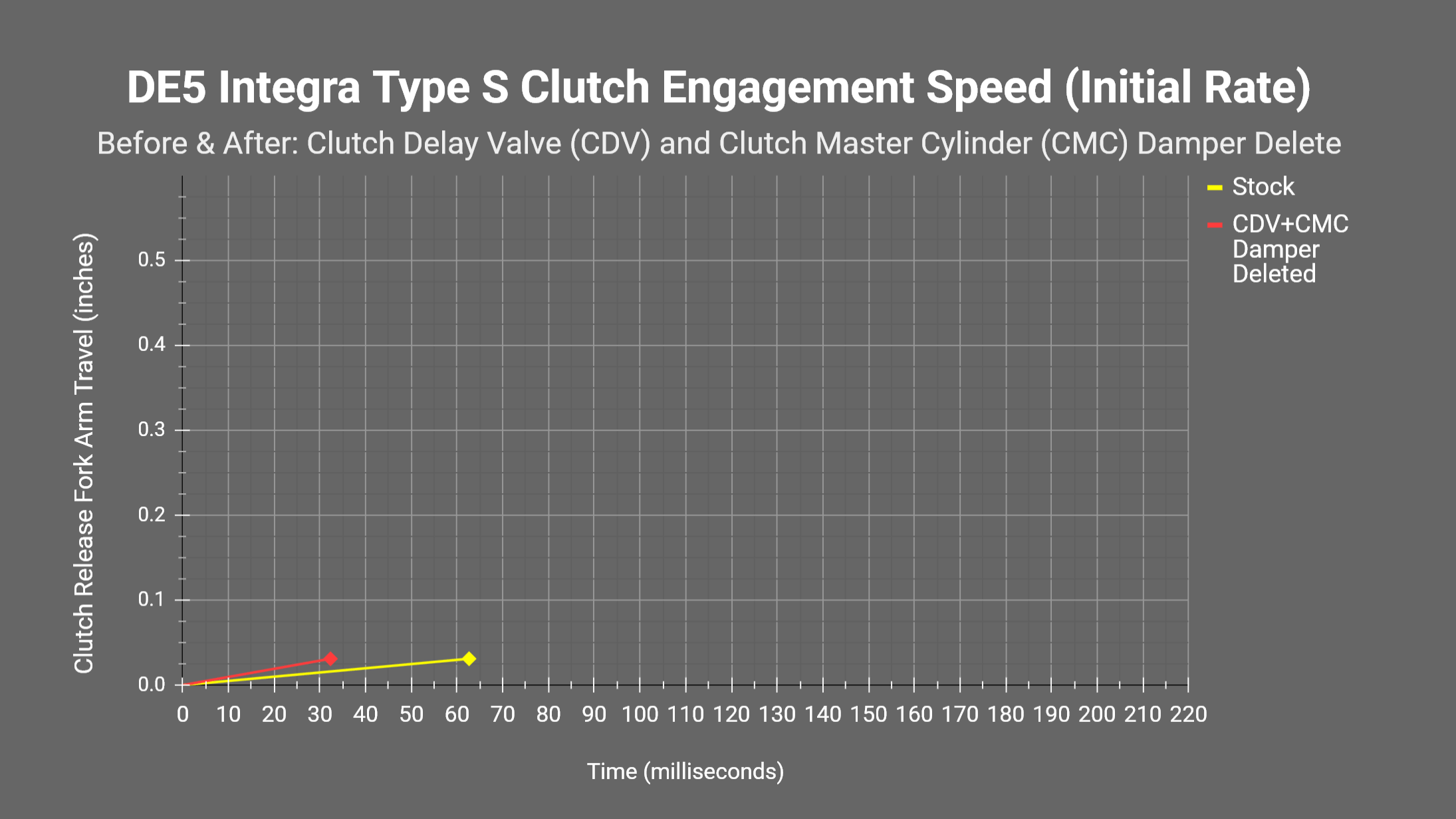

There are three obvious components to the rate of travel and I want to address the first two separately, because I think further testing would isolate each component to one of the two deleted parts. On the left side of the chart you see a diamond for both lines, and this diamond separates the first, slower rate of travel with the second, faster rate of travel. Let's focus on that first component of travel with this view:
11th Gen Honda Civic Clutch delay valve delete analysis and how-to de5-clutch-engagement-speed-initial
Because the rate of travel is so slow in the first part, I don’t believe the CDV is actually what’s exerting influence here. Instead I think what is happening is that you’re seeing pressure equalize throughout the clutch hydraulic system once one end of it, the master cylinder, has lost pressure. My hypothesis is that during this event, the CMC damper is inducing delay. By the nature of how it works, the volume of fluid inside of the damper will evacuate towards the port with the lowest pressure, in this case in the direction of the master cylinder. Only once the pressure in the damper has equalized will fluid begin to flow through the damper from the slave cylinder. This would explain why the stock setup is slower to start moving at full speed, even though the clutch delay valve should only affect higher speed operation, not lower speed operation.
Numbers-wise, the fully deleted setup is nearly twice as responsive, taking only 32 milliseconds to begin full-speed travel versus 63 milliseconds stock. I want to assert here that I believe it would make sense that this 31 millisecond difference happens both when you press the pedal and when you release it, since the CMC damper works in both directions. So for each shift, I believe this delay happens twice for a total of 62 milliseconds of delay.

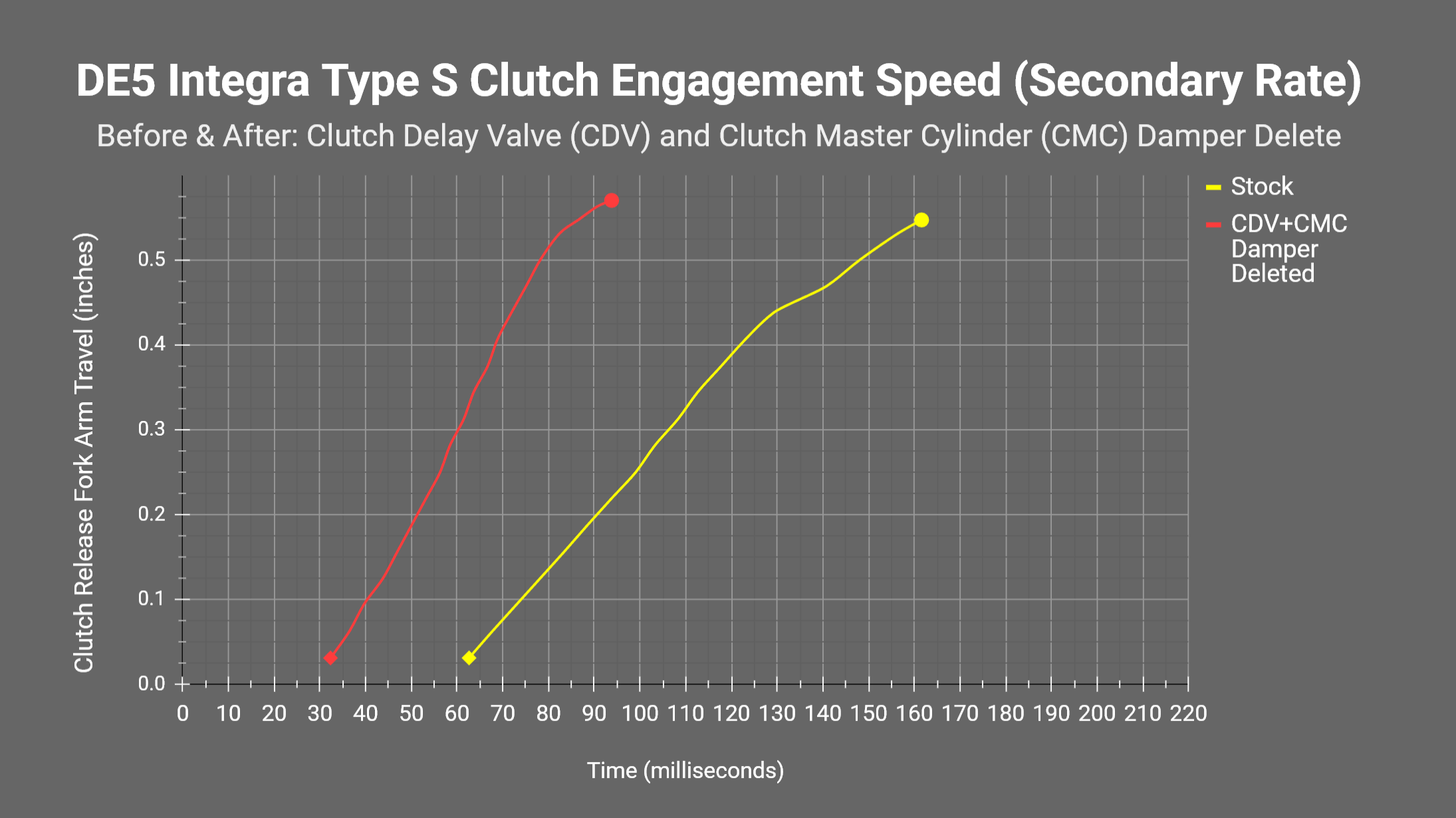

So now let's focus on the second component of the rate of travel, which is between the diamond and the circle marks on each line:
11th Gen Honda Civic Clutch delay valve delete analysis and how-to de5-clutch-engagement-speed-secondary
This seems to be the regime where we have stable hydraulic flow and the CMC damper is not in play. I believe the difference maker here is the clutch delay valve. Because the CDV acts as a flow restrictor, there is a limit on how fast the fluid can flow, and what you’re seeing is the maximum speed. Ignoring the first component of the rate of travel, the clutch fork finishes its travel in 99 milliseconds stock, and 62 milliseconds deleted. So by deleting the CDV, we have increased the rate of travel in this regime by about 37%.
Of course there is a third component to the rate of travel, and in that first chart above, you’ll notice the lines dip back down towards the X axis after the circle mark on the lines. That’s because there’s a bit of rebound. The rebound is actually stronger on the deleted setup, which makes sense because it’s engaging the clutch faster. I don’t believe this rebound is actually disengaging the clutch - I think it’s just the whole chain of components settling into place. The stock setup actually starts to rebound after about two hundredths of an inch less travel than the deleted one, and you can see this on the chart where the circle for the deleted setup is higher on the Y axis than the stock setup. They both eventually come to rest at the exact same 0.563 inches of travel.
Conclusion
So what does the sum of this all mean? Well in theory, the time penalty from the CDV only happens once per shift, only on the clutch pedal release. And in theory, the time penalty from the CMC damper happens twice per shift, both on the press and release of the clutch pedal. So if we put these numbers together - 62 total milliseconds of delay from the CMC damper, and 37 milliseconds of delay from the CDV, we get a total of 99 milliseconds of delay per shift. This is substantial - an extra tenth of a second of delay can result in quite a bit of clutch slip and be disorienting for the driver. One modern technology we can compare this to would be virtual reality headsets. With those, latency between input and visual movement over 20 milliseconds can cause motion sickness, and Honda’s gadgets here add five times that amount of latency. I think what’s worse is that this delay varies with speed of operation, making it harder to predict. So you can try to drive around them, but you’ll get different results using different speeds. That is definitionally unintuitive behavior from the car. It should also be noted that the effect is not binary, this isn’t something that only affects you when you operate the clutch at maximum speed. If you’re moving slower than maximum speed, the effect you will feel manifests as variable pedal pressure.
