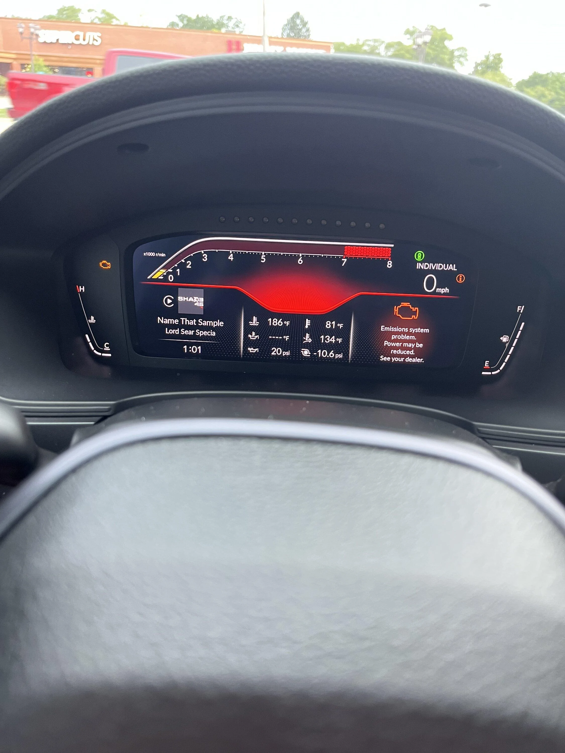

Got the Emissions CEL today when starting the car the 3rd time (while running a couple of errands). About 1675 miles on the car. I always use premium gas. Initially the brake error light was lit as well, so I turned the car off and back on and the brake error light disappeared. I drove it home and didn’t accelerate hard (as the warning advises). It seems to drive fine. Boost seems normal. It likely has the old solenoid which Honda has apparently updated. Guess I’ll be taking it to the dealership soon. Hopefully, like others here, it’ll be simple :
1. Clear CEL and wait to see if it comes back.
2. If it comes back, get the faulty solenoid replaced with the updated part
11th Gen Honda Civic FL5 Emission and Rev-matching System Problem (P0011) IMG_1847
