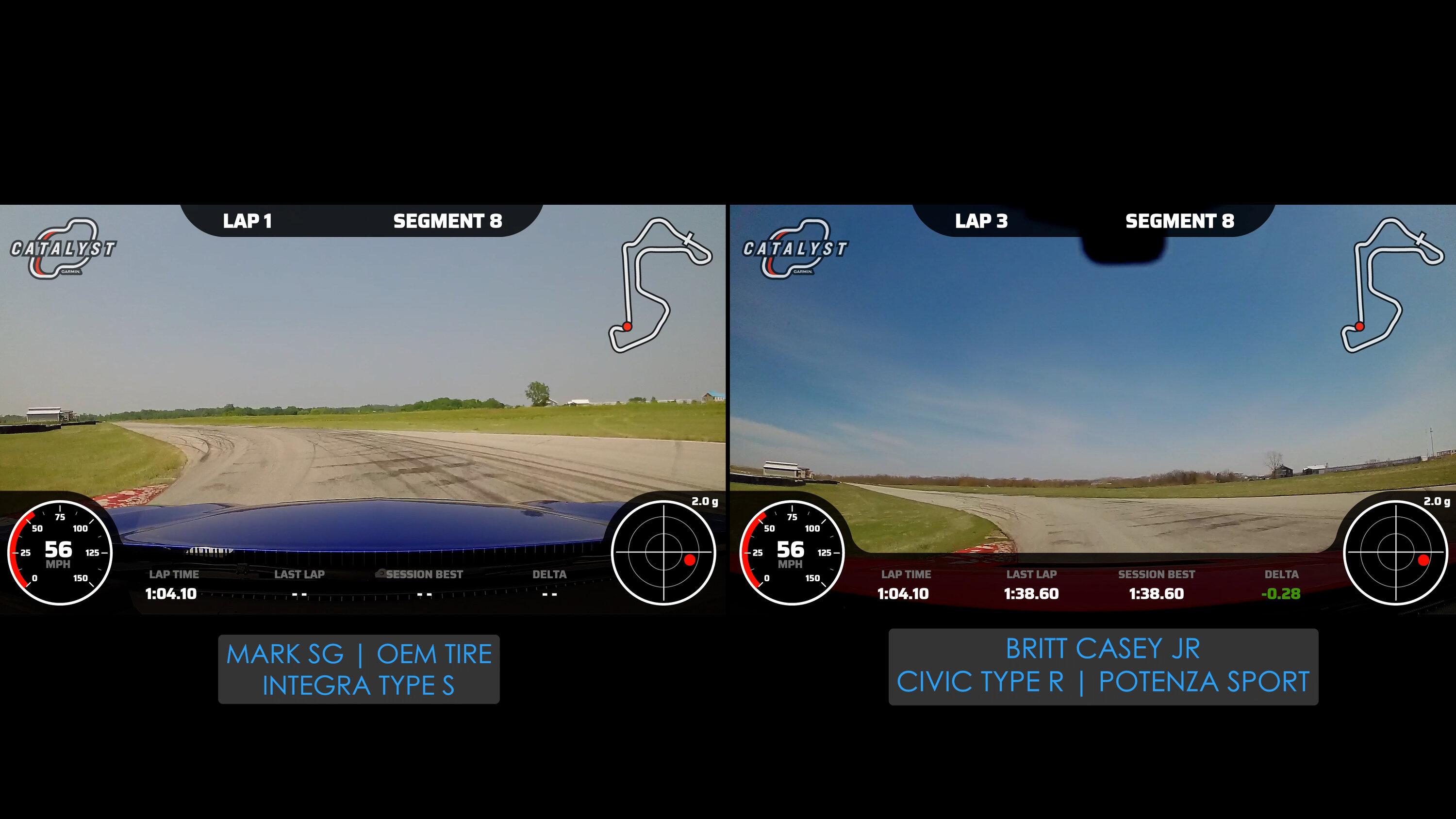

I want to preface this by saying I will be able to post the lap times next week however I can give you a brief run down and answer any questions after driving both cars back to back, street and track.
The video released today focusing on the ITS but many comparisons were made with CTR.
Lap Video (Different Days, 82F vs 76F)
Autobahn South
FL5 CTR Stock +R VSA Off(Bridgestone Potenza Sport OEM Pressures)
DE5 ITS Stock Sport+ Pedal Dance VSA Off (OEM Tires and Pressures)
CTR Driver - Britt Casey Jr. IMSA TCR National Champion (FWD Class)
ITS Driver - Mark SavageGeese (Drove a HotDog Cart into a Wall)

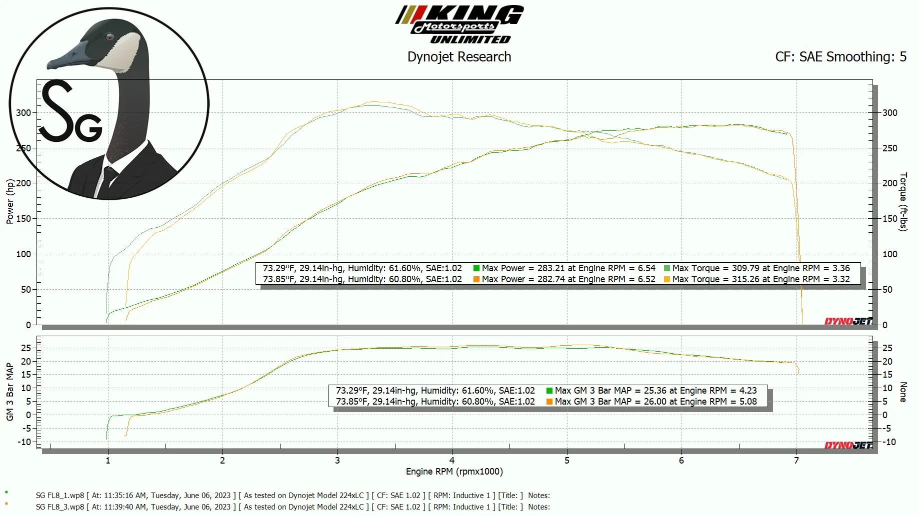

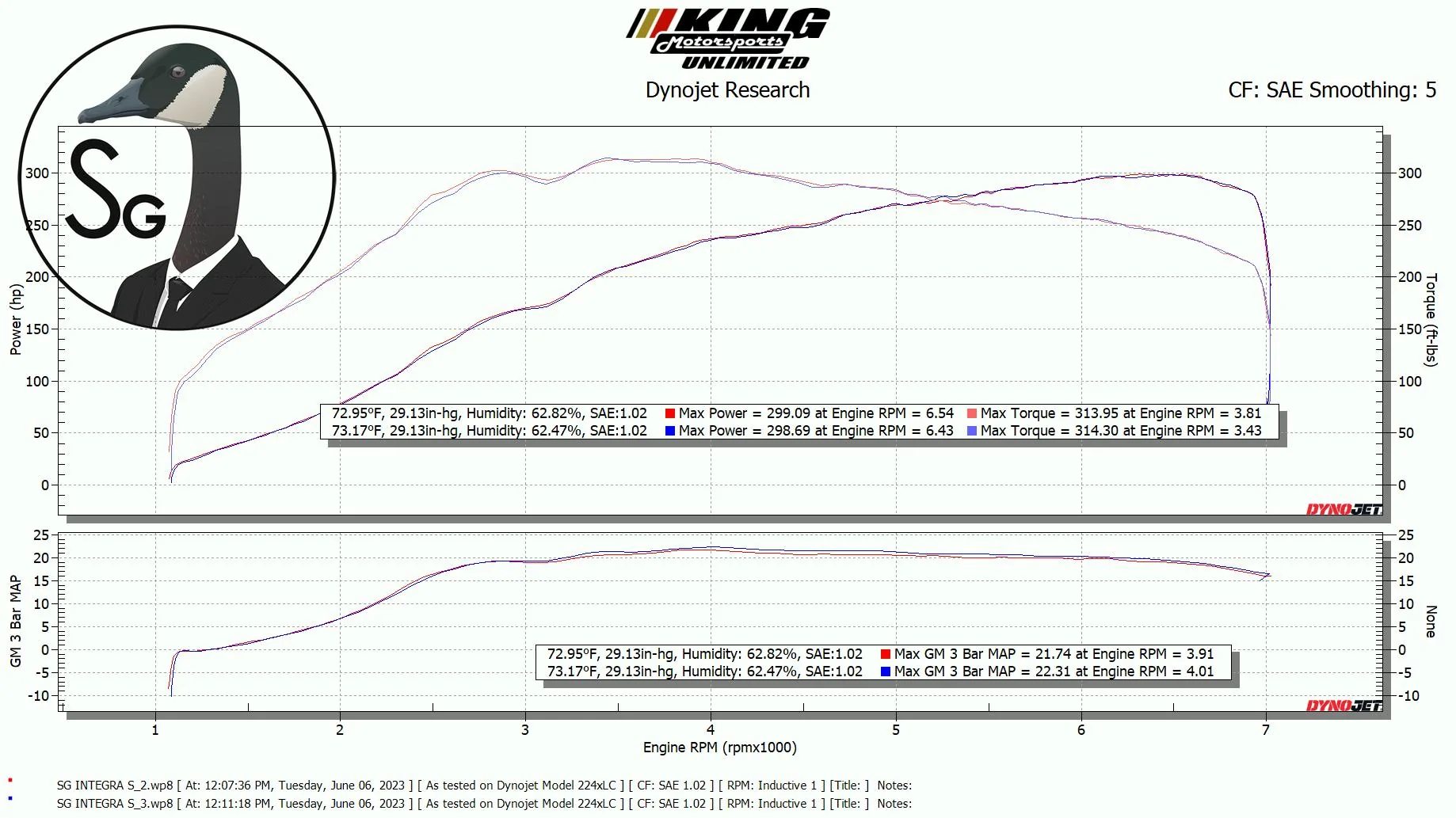

  8. More TQ = Less effort in higher gears at low RPM
  9. More HP = Pulls on CTR in all straight lines until about 95MPH

1) Why does the ITS no longer pull on the CTR above 95 mph? Torque advantage taken away because where the RPM lands in higher gears post upshift?

1. It could be timing being pulled at higher end where HP/TQ advantages are less noticable, and potentially some aero difference. If you pull out of a corner same speed, Integra will pull on the CTR slightly up until 95 or 100. Its basically like a half car length.
