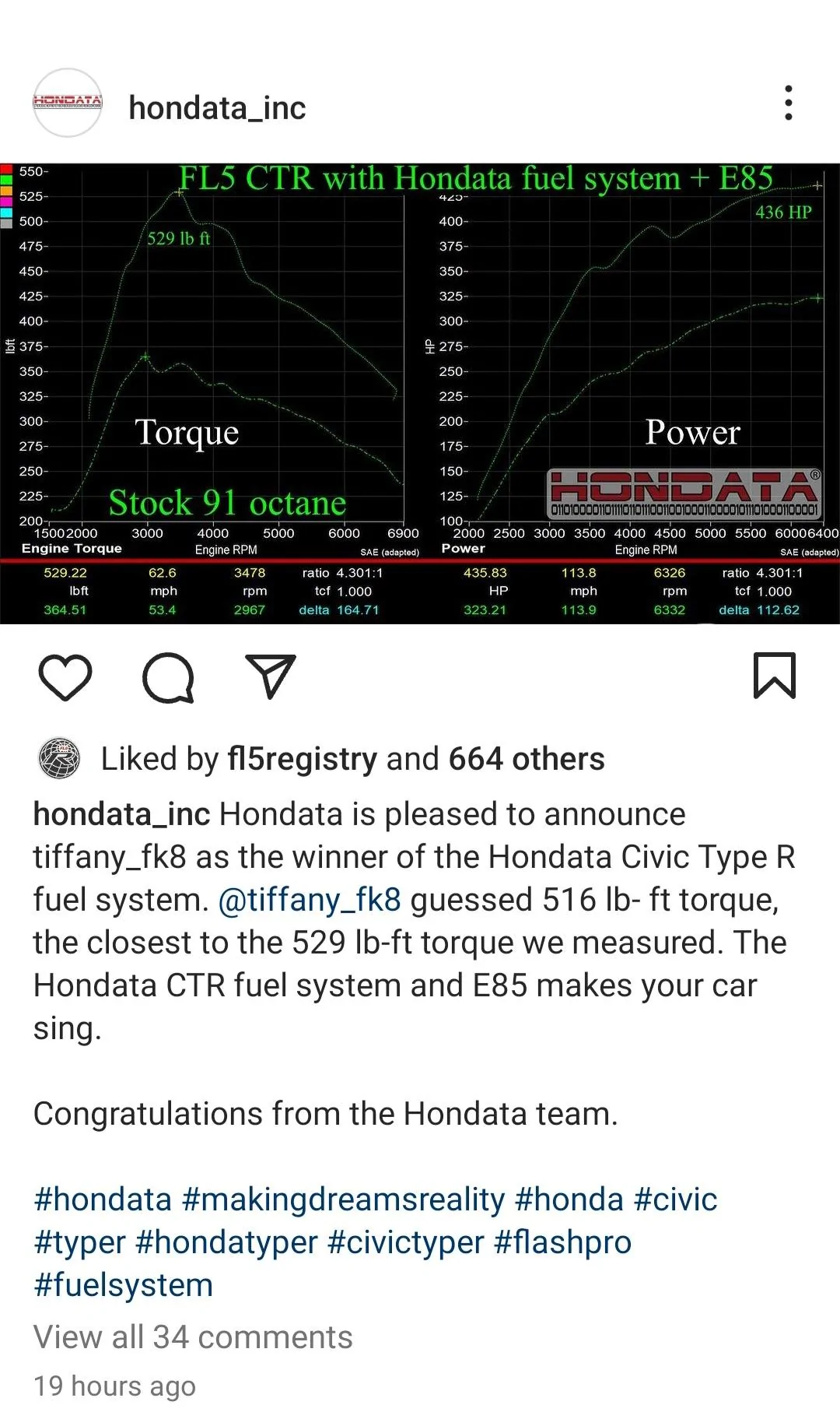

Wow! That's a mountain of torque! I cannot imagine it will be long before connecting rod failure. Sure looks like a lot of fun though.
11th Gen Honda Civic Hondata FL5 FlashPro released Screenshot_20230825_131936_Instagram

Are there any OTS tunes that don't target such a high torque load, especially at low rpm?
It seems all the tunes so far prioritize low-end torque (probably because it is immediately obvious to the end-user), but I'd prefer one that prioritizes high-end hp and doesn't put such a brutal load on the motor at low rpm (and might hopeful be safer re: LSPI, rod integrity).
