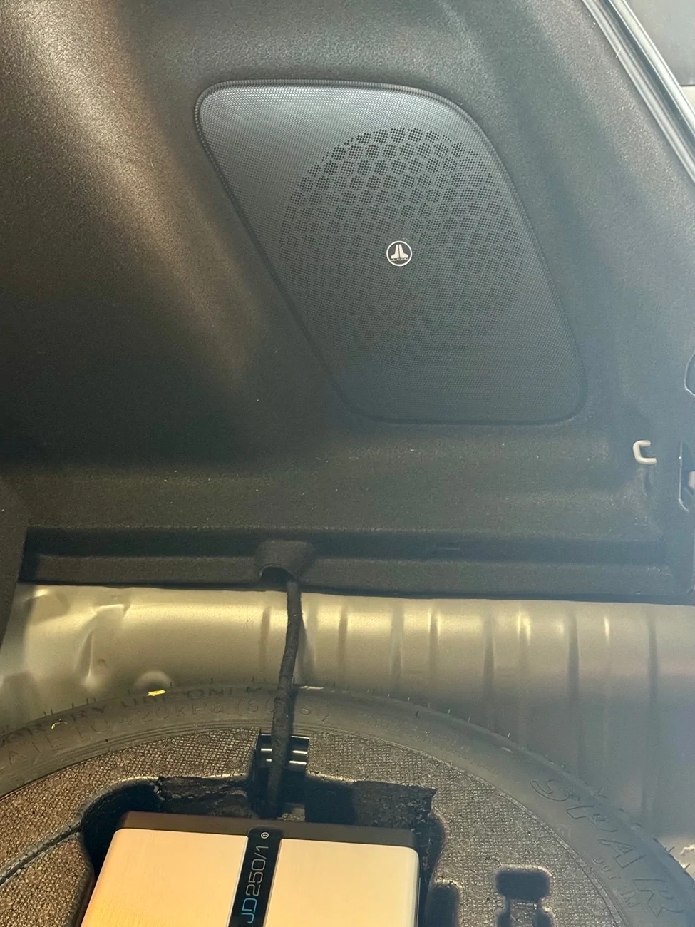

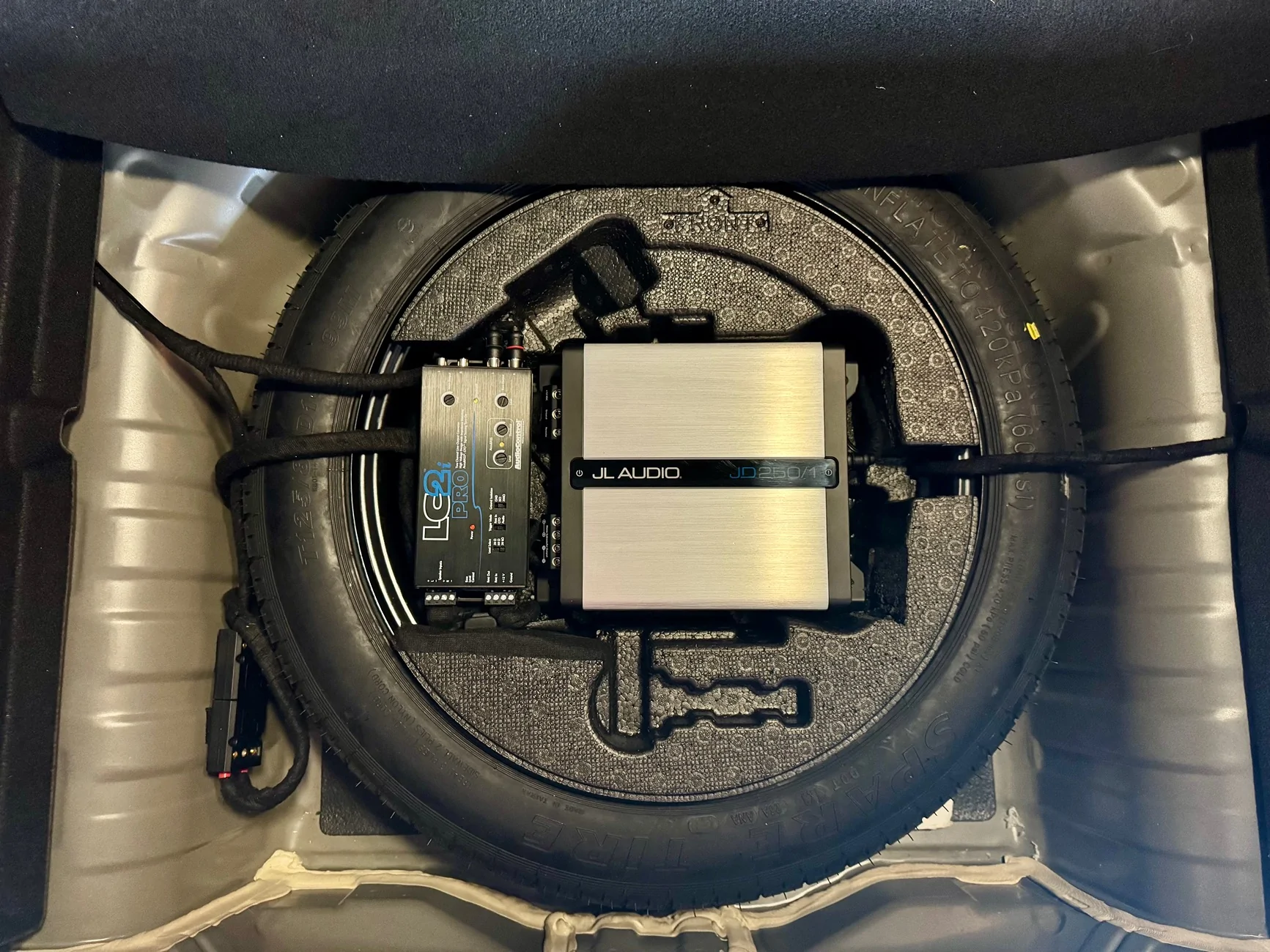

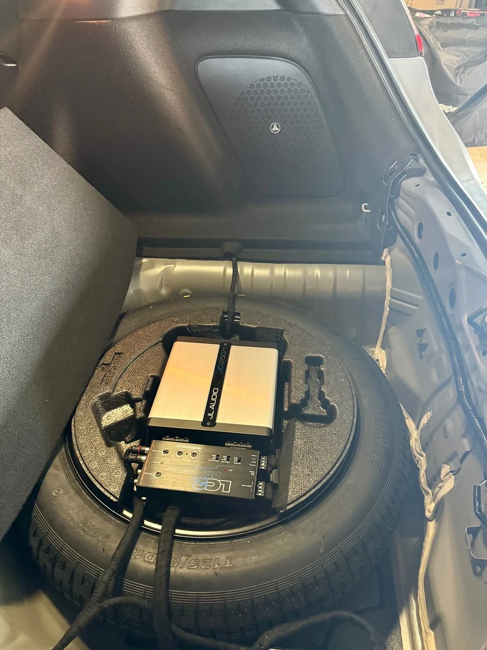

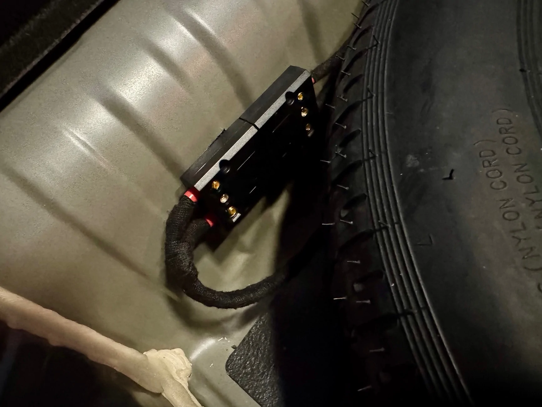

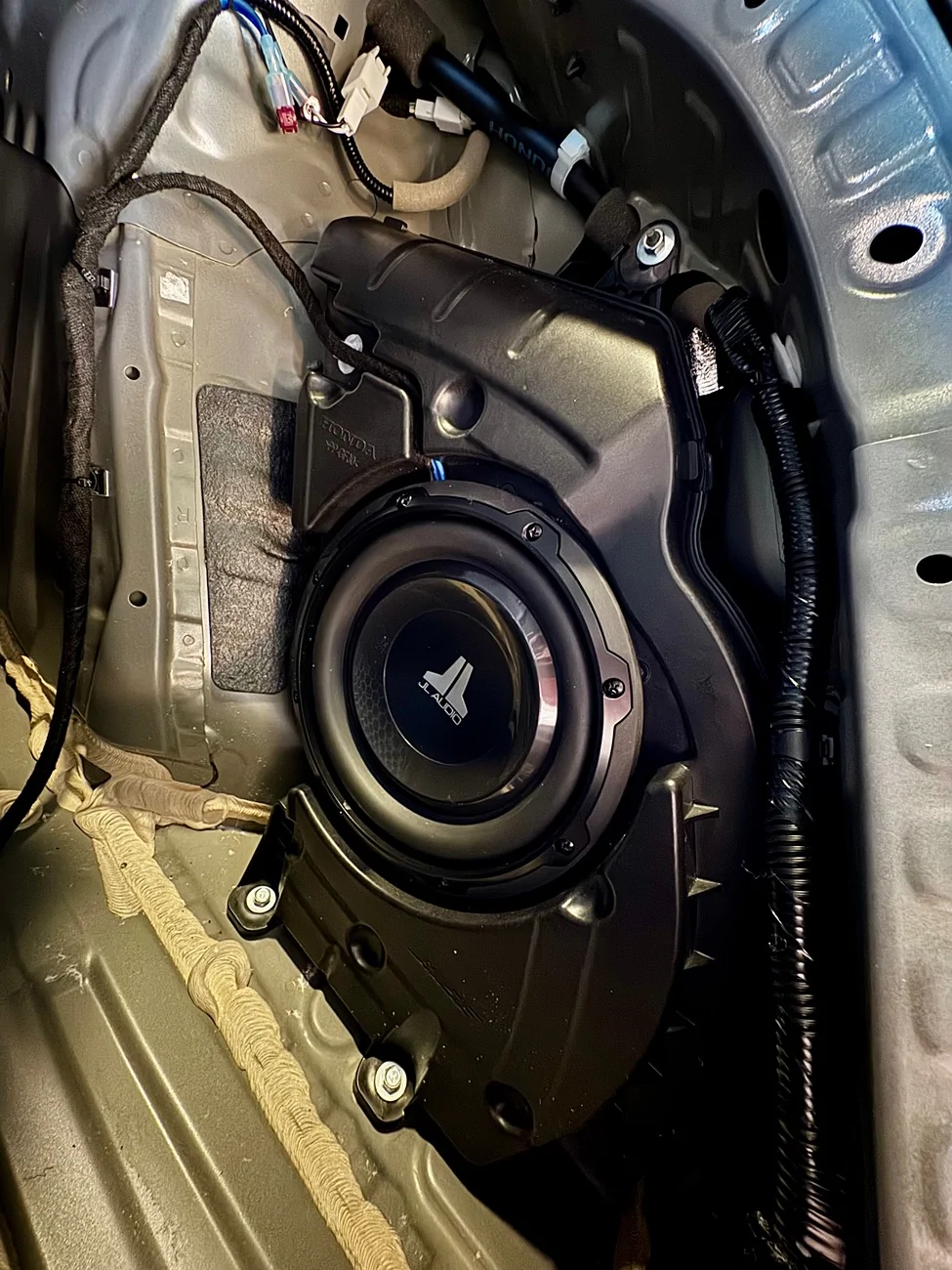

Older thread, but I joined this group just to contribute to this post since it was my main source of information along with a YouTube vid. I ended up going the Amped route along with the LC2i as the LOC specifically to use the AccuBass feature. I’m using a JL Audio JD250/1 amp that has high level inputs but when I installed it without the LOC, it lacked bass. Added the LOC AND after setting my gains, I’m able to keep the bass on the BOSE head unit at about 25% which limits distortion at the door speakers. I installed the remote level controller for the amp so I’m able to adjust bass levels according to what I’m listening to while having little distortion. The subwoofer I went with is the JL 8w1v3. No polyfill, no sound deadening and I’m actually very very impressed with the amount of bass out of the sub. It wiggles the nose and for an entry level 8”, I was not expecting that. Picked up the amp on eBay for $120 and the sub for $150 and the LC2i was picked up for $75 plus about $80 for the amp wiring kit along with miscellaneous accessories such as a quick disconnect in case I actually need to use the spare tire. All in I’m close to $425 for some extraordinary bass. I did have a slight rattle at the rear license plate but was able to place some carpet lining foam in between the plate and the rear hatch. And that eliminated the slight noise. I do plan on upgrading the front and rear speakers with the Memphis Audio since they do offer the 6.5” in both 4 and 2 ohm versions. I’ll make another post with the results of that upgrade in the near future. Thanks Icehawk for the inspiration

Wow nice job, that looks awesome! I was pretty much set on installing a 10" sub in a traditional box and eating up some trunk space, but this gives me a little nudge to keep the stock enclosure.

I’ve had a powered JL Audio ACP110LG with a single 10” in my previous car and this surprisingly hits harder. For about half the price since I did the install myself plus my car is the actual grocery getter so having as much trunk space without having to remove the sub was ideal.

And where did you go through the firewall for your power wire?
Drilled the firewall and used the grommet that was included in the amp wiring kit. If needed I can find the YouTube vid I followed. EDIT* ATTACHED LINK. Seen some people use an existing grommet and just poke a hole through it but seem janky and risky.
