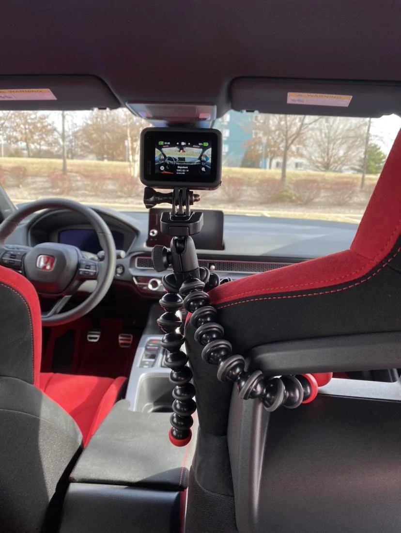

nice driving. the camera is really steady especially considering how much you're bouncing around in the seat, haha!. I'm trying to picture how this is actually mounted. Do you have a pic of it?

This is how it mounts. Seemed fine for track days but in a rough parking lot for autocross it got a little blurry. Ended up ditching that setup to go to a helmet mounted camera. Lose the view of the shifter but I think it makes for a more fun view. The brakes were stock in that video. I’ve since switched to Hawk ER1 up front and they seem to work good. Here is the view from the helmet

Was there something special you did with the gorilla pod? I set mine up like that and the shaking and clicking from the pod and GoPro moving around is horrendous!

I think I had to really pull it around the seat to try to make it as tight as possible. And on the leg that runs down the side of the seat I pushed it way to the right as seen in that pic before I put it on so that as i pulled the legs through the seat hole that one was already pushing on the seat.

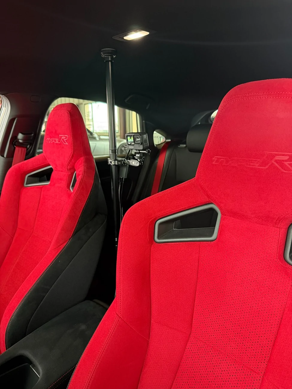

So I ended up buying a shower curtain telescoping rod and a Gopro pole clamp. $38shipped from Amazon!
It was damn stable! I originally tried a generic gorilla pod to the seat and it was too much vibration for the GoPro to handle. I'm happy with this current setup!
