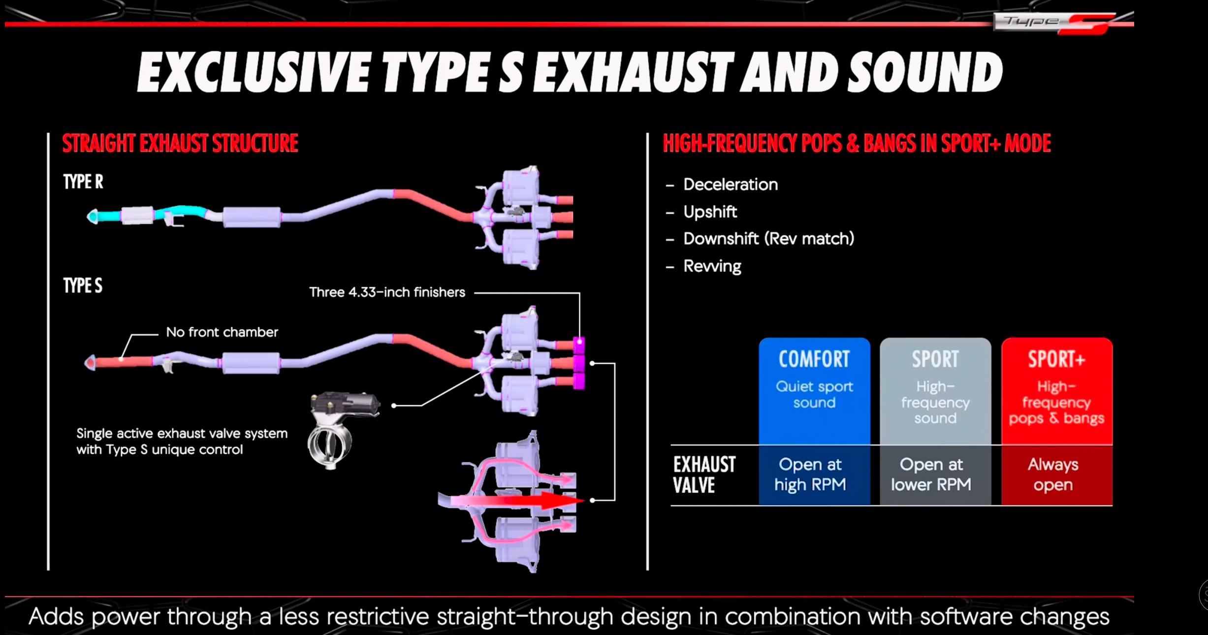

is the exhaust manifold on the ITS the same as the CTR?
probably. but what about the downpipes on both are they identical?
RUNN1N
526
716
Yes to the downpipes, the ITS exhaust has one less resonator resulting in a deeper tone, but is about 5” longer, so modification would be needed to install it on the FL5.
The DE5 exhaust alone will not get you pops and bangs, that’ll require a tune… but it’s also worth keeping in mind that you can get the pops and bangs with the stock FL5 exhaust + tune.
Jester04
2,030
2,641
Correct now with the ecu flash plus a resonator delete you can basically mimic very closely the Type S exhaust note.
