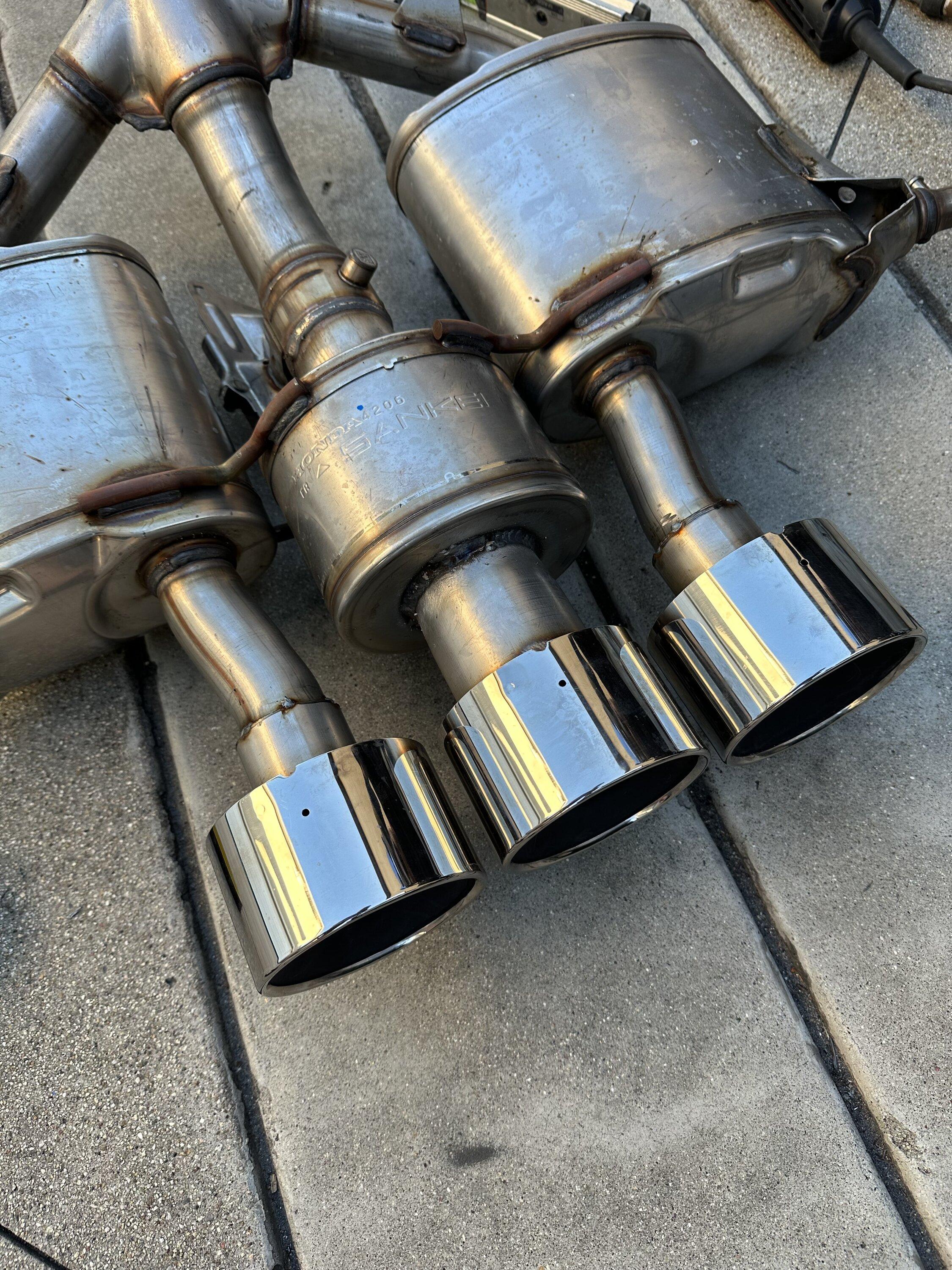

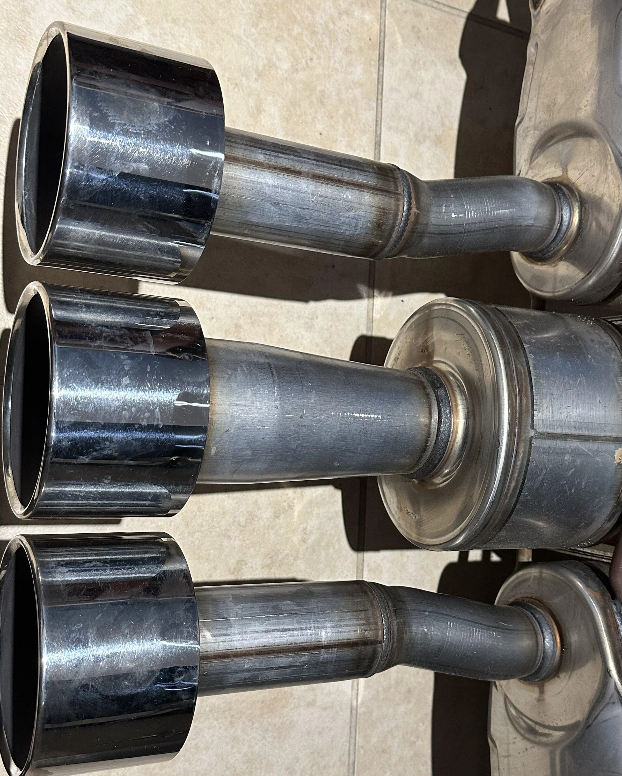

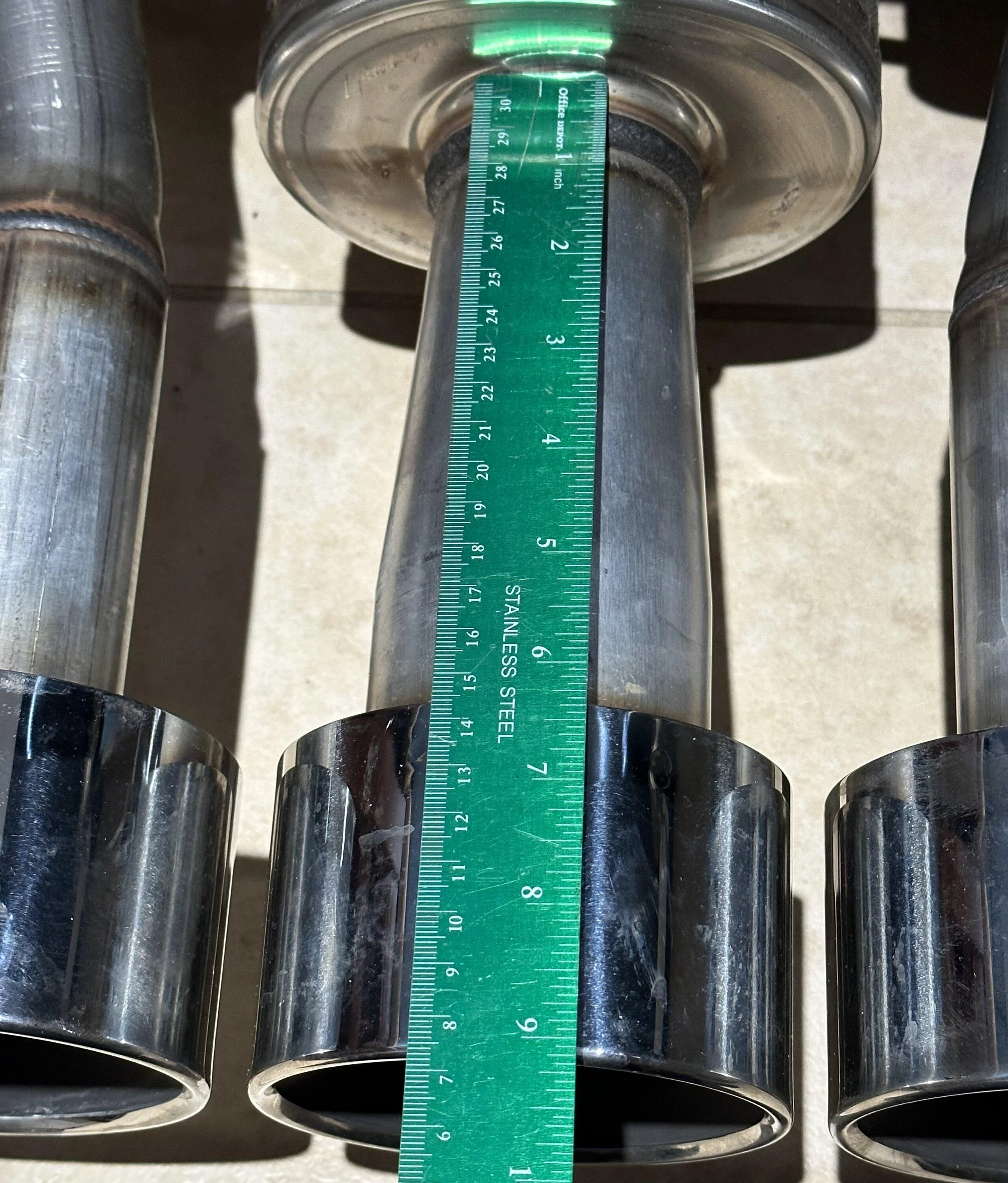

Yes it’s 100% doable…. All the hangers line up perfectly the exhaust tips need to be shortened 5” but the nice part is Honda welded the tips on exhaust where it needs to be cut also another nice benefit of the Type-S exhaust is the the internal Diameter of the muffler piping is larger than the CTR’s by 3-5mm.. I would highly suggest that you get a good welder to tackle this and not some hack at a local exhaust shopAnyone know if the ITS exhaust is a direct swap? Just curious.

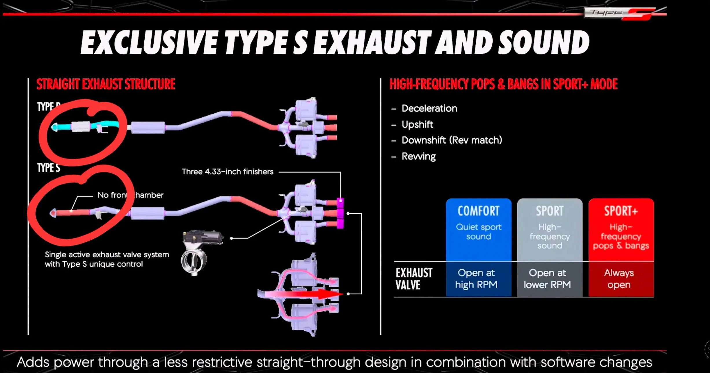

No, the pops and burples is all in the tune the Type S has.Does this get you the magical pops/burbles people like about the type s or is it just a cheap upgrade?
I’m hoping when Hondata adds the pops/burbles tune, this mod will allow it to sound as good as the DE5 does without that extra resonator.Does this get you the magical pops/burbles people like about the type s or is it just a cheap upgrade?

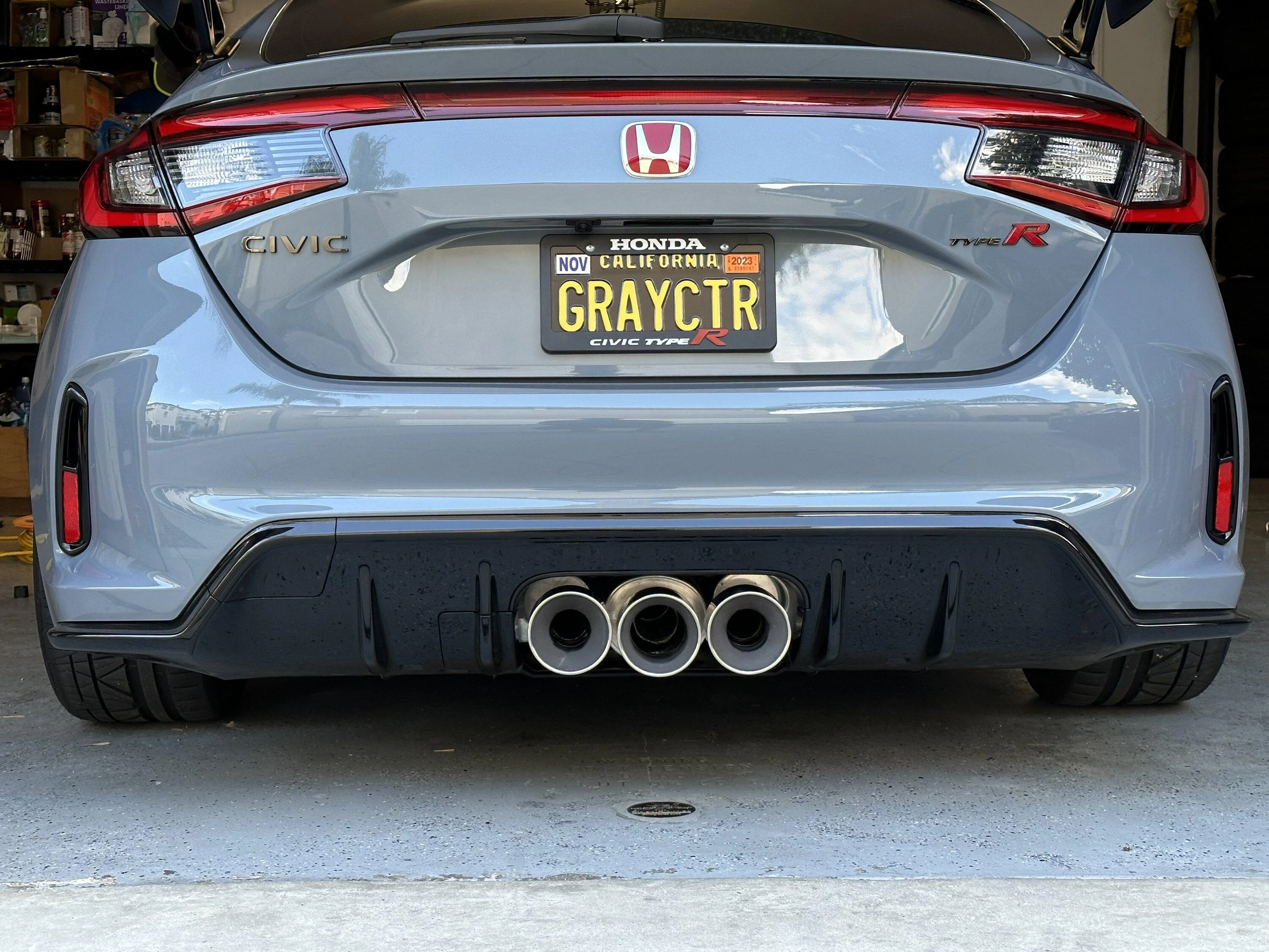

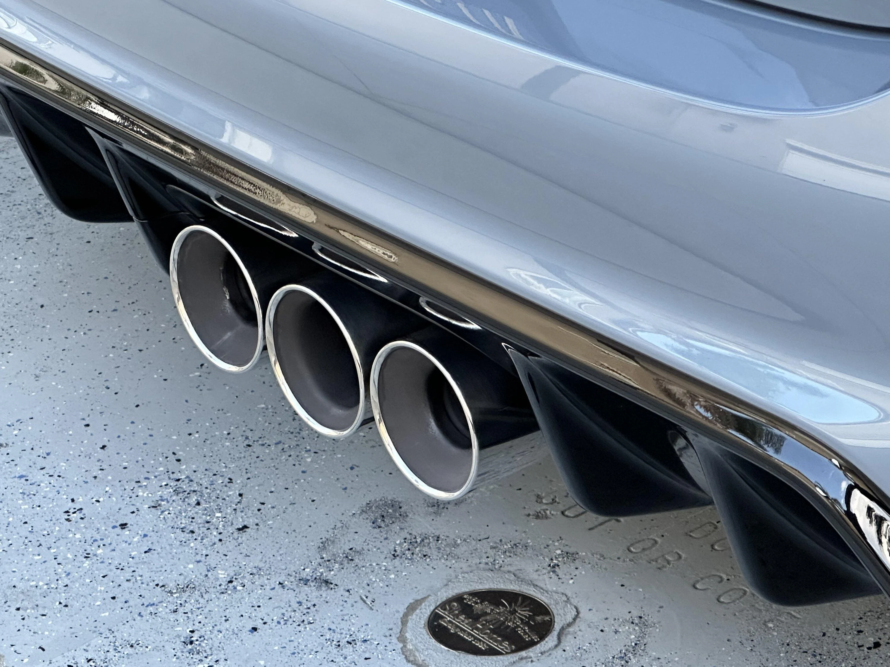

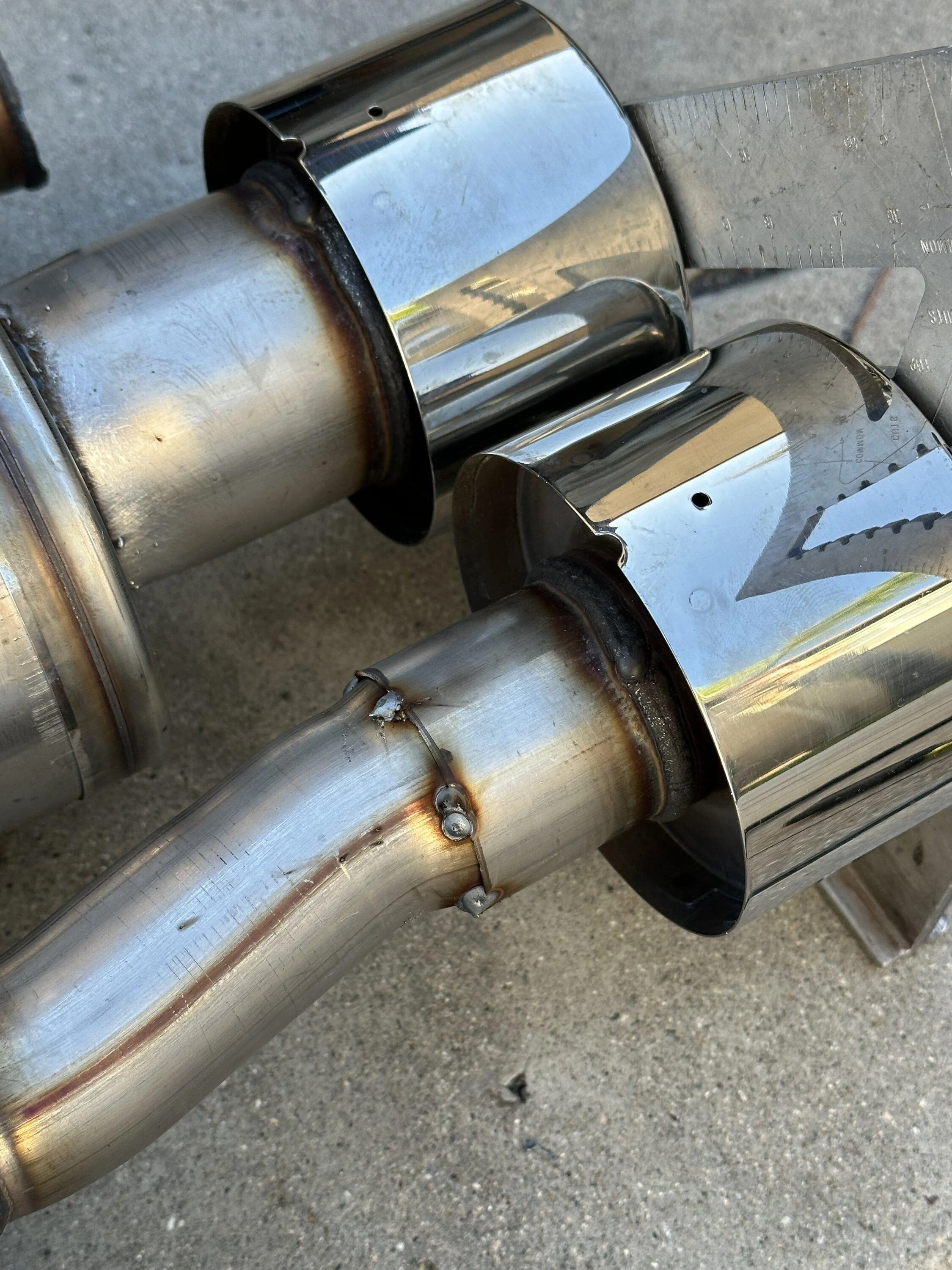

The tubing for the center tip once you cut the 5” off it slips right over the center section for the CTR exhaust perfectly and same with the outer tips as well. In the pictures I tack welded the tips until I was able to get the alignment perfect.. the. I fully welded the tips on.@JDM_DOHC_SiR Pics are super helpful. Thanks. I couldn’t figure out how you dealt with the flared tubing of the center tip. Just cut the flared portion out and weld the larger pipe diamater of the tip to the center can. Nice. Outer tips look like it’s basically slipped over top of the smaller pipe from the outer cans and spot welded. Sound about right?

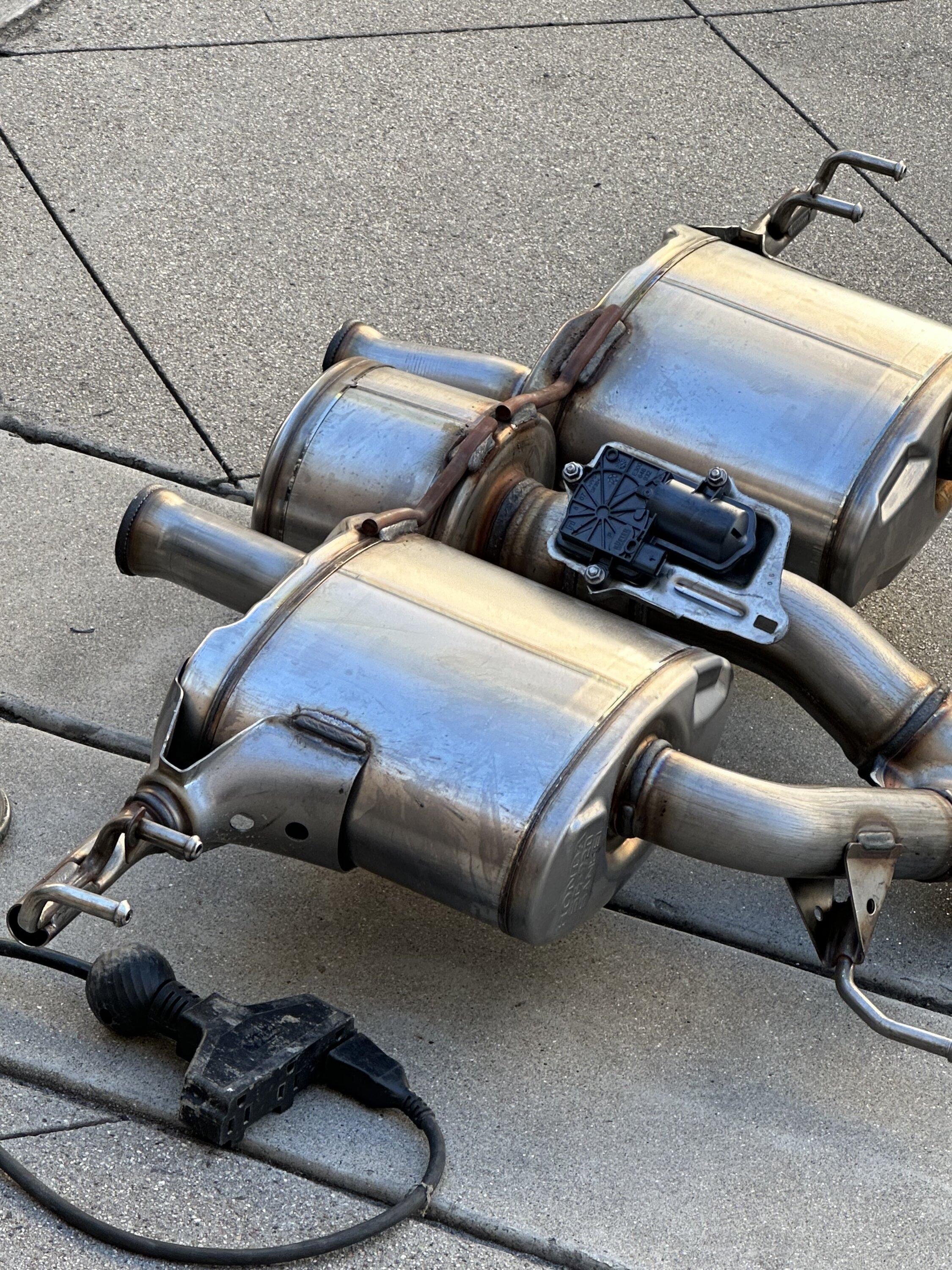

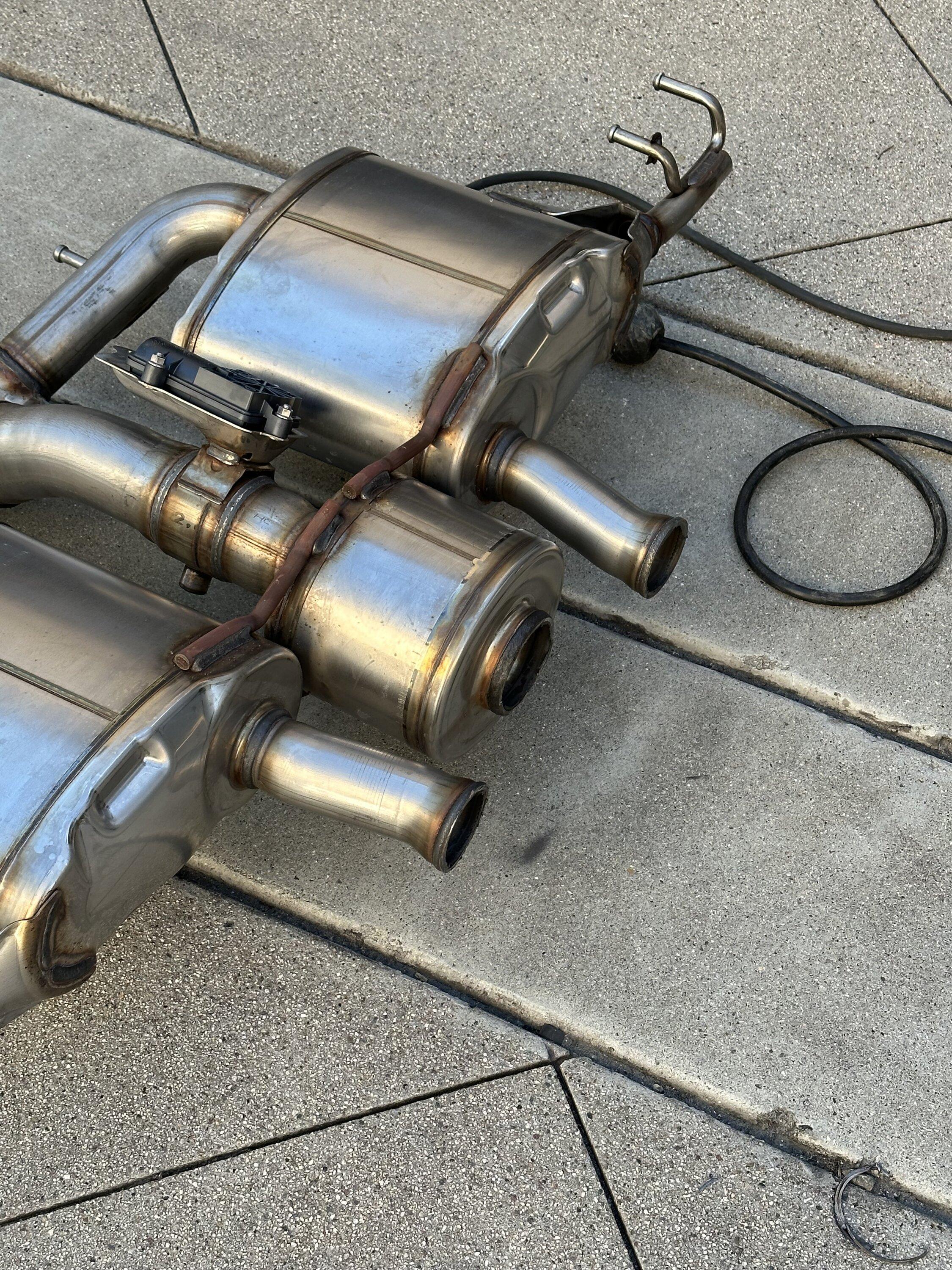

Unfortunately it’s all one piece for the section with both the resonator and the muffler.
Unfortunately yes. Everything in that picture is one piece, no bolted joints.
Shoot for real? We both talkin about the front resonator not the rear right?
