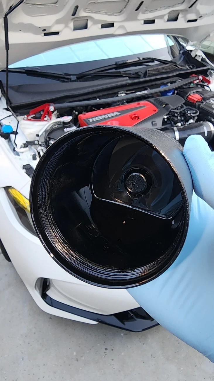

Catch cans still good a preventative mod to valve carbon buildup. I have about 1k miles since last checked and caught not a lot, but it's something that would've gone back into the intake manifold and valves.
11th Gen Honda Civic Question about CRC intake valve cleaner 1000060162
i'm interested how the OEM oil separator works. So, it catches the oil vapors then lets it drip back into the crankcase? Would help to have a diagram to understand what it's doing. I wonder how an aftermarket catchcan compares to the OEM system, long-term.
Would the oil that's caught in the catchcan drip back into the engine normally? or is it just sent through the intake?
