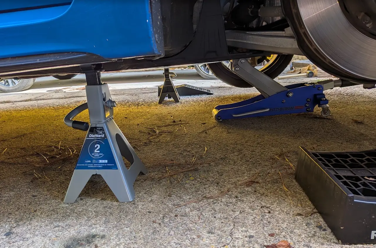

I drove the car up on ramps, then jacked up the front and put the jack stands on each side. Safety first

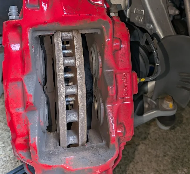

Used the impact wrench to remove the lug nuts because the fucking monkeys at the shop pile drive the nuts on. I had a lot of anxiety about getting the caliper screw off, but this Craftsman impact driver made it super easy. Also the caliper screw was in surprisingly great shape, no rust at all, so I guess I was lucky it wasn't seized up. I didn't have to use WD40 or PB blaster or anything.

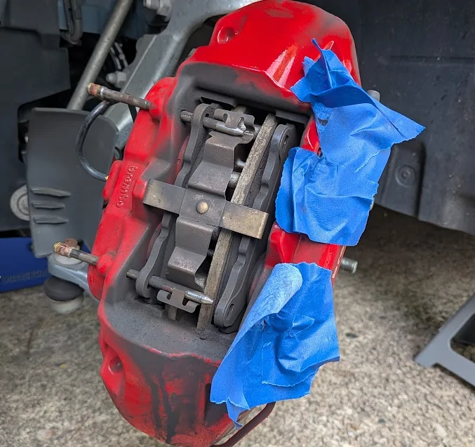

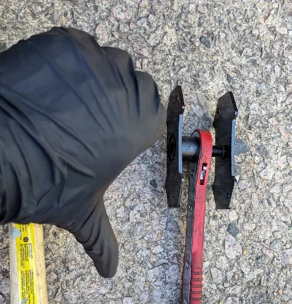

Punching out the pin and bracket was a little bit of a pain, but not the worst thing in the world. Once I got the pins punched out to a certain point I used pliers to get them out. Once the first one is out the other one is also out. Getting the old brake pads out was straight up brute force. I used a flat head screwdriver to separate the pad from rotor and compress the pistons. I got a piston compression tool but it was useless because it wouldn't fit in there. So don't get this thing, get another one. I used the old pads to compress the pistons. When you compress the piston, the other side pops out, so better to have the pad on both sides while doing the compressing.

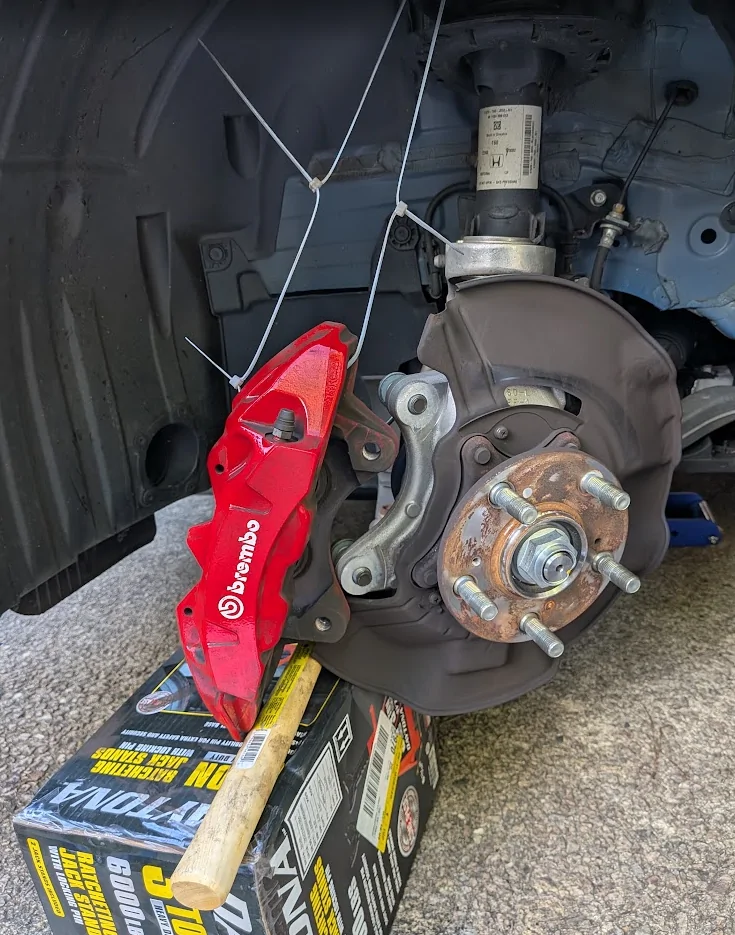

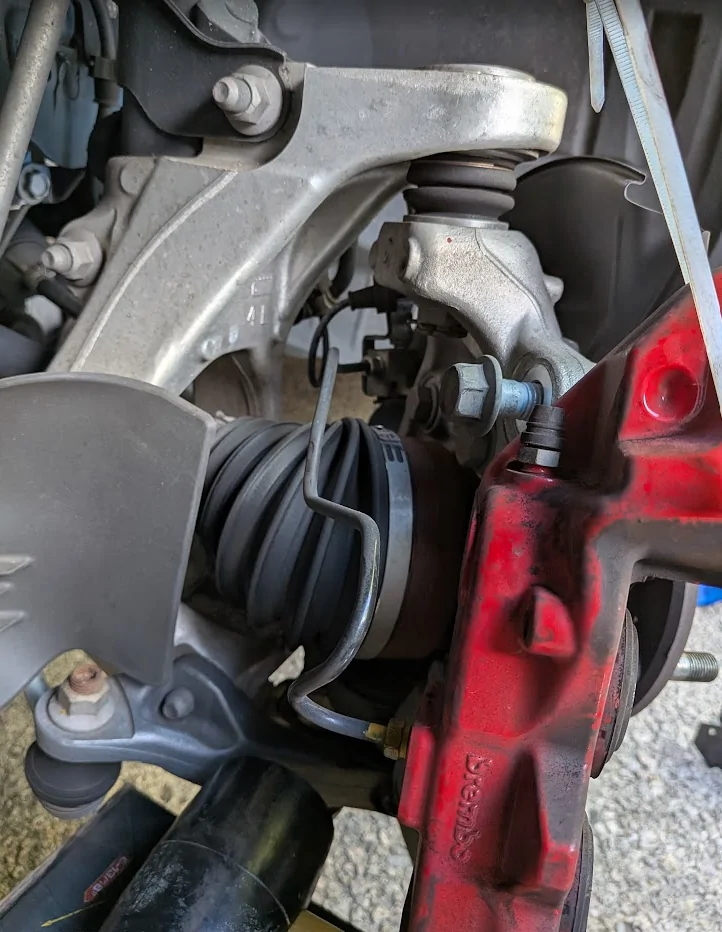

Used a 19mm socket and impact wrench to take out the caliper bolts. I considered removing the 12mm bolts to give the hardline some more play, but I didn't need to so I left them. I ziptied the caliper to the springs and set them on a box for extra support. Removed the old rotor.

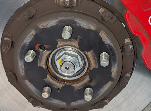

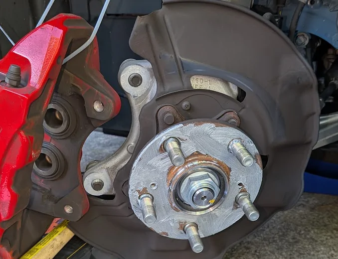

With the rotor off I slathered some anti-seize on the hub face to make life easier next time.

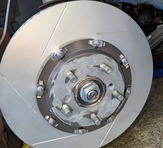

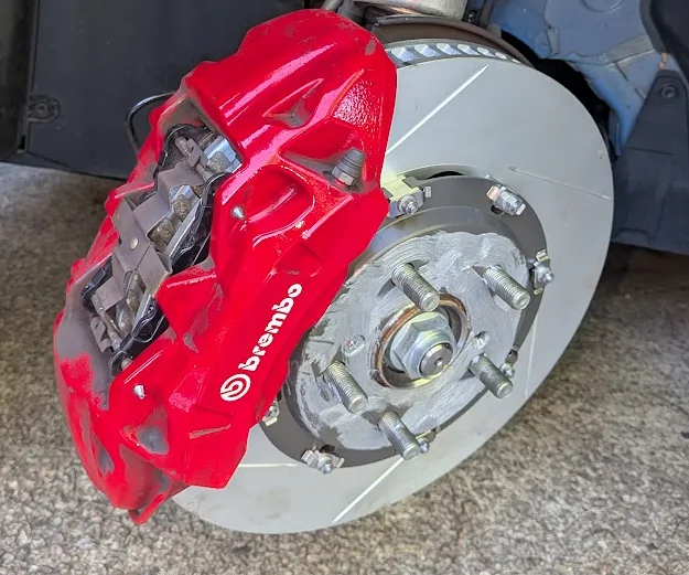

Put the new rotors on and replaced the screw, slathering anti seize on the screw thread and the rotor hat. For the first rotor I left the screw off because I figured it was useless, but it ended up being a pain trying to make sure the rotor was flush while replacing everything. So for the second rotor I put the screw on and slathered the thread with anti-seize so that next time it's easy to remove. I recommend reusing the caliper screw to make reassembly easier.

Put the caliper back, torqued it to 103 ft-lb. Put in the new pads, put back the pins and bracket.

Great writeup, but a suggestion for next time (mostly for your own sanity) would be to use a brake/high heat grease instead of anti seize on most things you're greasing that don't explicitly require a certain type of lubricant. Not because it actually makes a difference, but just because anti seize is the devil and ruins anything it touches that isn't metal. Me and the guys I do car work with all changed from anti seize to high heat grease and have had great results despite living in the north - again, only where appropriate.
jtlctr
Jake
May 12, 2024
714
883
My advice for the future would be to use a lot less anti seize. A little goes a long way. The more you use, the more it gets all over everything. You can end up looking like the Tin Man if you’re not careful.
Also, it’s good to have a little bit on the part of the hub that centers the wheel, that’s where corrosion can be most problematic.
Just a tip. Were you using the Brembo brake punch? Its a little pricy, I think it was like $20 or something but it shouldn't give you want problems. I was debating about getting it because of the cost when I first did my brakes and went with it, might make it easier for you next time.
