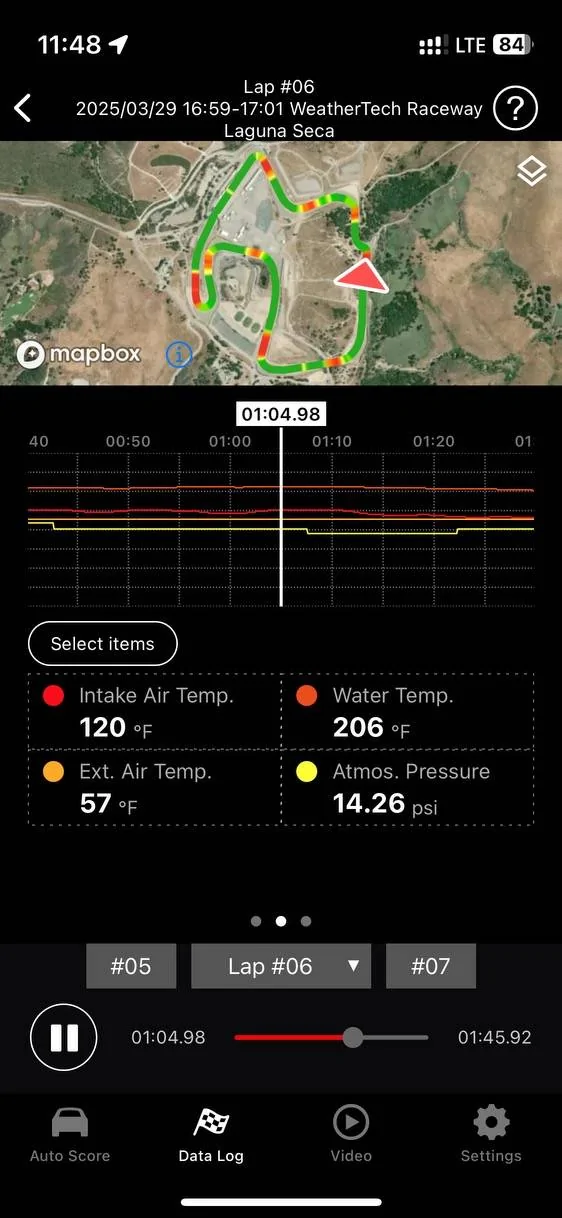

0W-20 vs 5W-30 on Track – Real World FL5 Data
There’s always debate about whether to stick with Honda’s recommended 0W-20 or go thicker with a 5W-30 for track use. We do know generally a 5w-30 can provide more protection, if it's the right formulation, but not always according to Lake Speed Junior who analyzes 1000's of oils. After testing and comparing notes with other drivers, here’s what I’ve seen:
11th Gen Honda Civic 🔴💊 Engine Oil Red Pill Thread: Only Post If You Have UOA - Official Honda Civic Type R K20C1 Engine Oil Analysis Screenshot 2025-09-15 at 9.26.16 AM

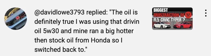

Heat & Viscosity
  • Thicker oil (like 5W-30) seems to retain more heat. Several people have noticed their cars actually ran hotter on track after switching away from 0W-20.
  • It also takes longer to warm up, which isn’t ideal for those who mainly drive short trips. This can accelerate oil shear and reduce protection sooner.
  • Journalist Zygrene and my buddy Eric (running dual intercoolers) both confirmed their cars ran hotter on 5W-30, and they eventually needed hardware upgrades to manage temps.

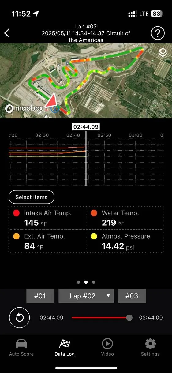

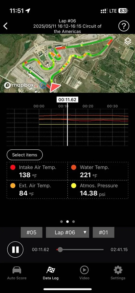

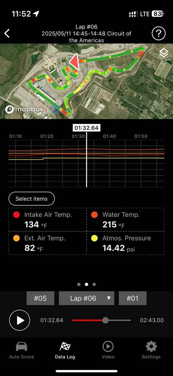

Track Data with Honda 0W-20 Ultimate
  • Personally, I’ve never had overheating issues running 20-minute full-send sessions on Honda’s 0W-20.
  • Before a track session, I’ll run the heater, set it to max a/c off, recirculating on ( avoid brake dust into vents ) which drops coolant temps by ~3–5°F, but even without it the temps stay stable. I usually have it set to zero fan, and then push fan on during a session if temps get high, and sometimes forget to hit the fan on button and it seems to still be working as heat does come into the cabin.
  • Jason from WOT reviewed my water temperature logs and track logs — he confirmed the stock car runs very healthy on 0W-20 at both Laguna Seca and COTA (one of the hottest, hardest tracks). He said look at the water temps, that's accurate, and it looks very very good.
My Recorded Temps (FL5 CTR, Stock Cooling, Honda 0W-20 Ultimate):
  • Water Temp (max): 221°F
  • Oil Temp (max): 257°F (ECU calculated, but consistent)
11th Gen Honda Civic 🔴💊 Engine Oil Red Pill Thread: Only Post If You Have UOA - Official Honda Civic Type R K20C1 Engine Oil Analysis 257211-04c6af80b7f1f1f61b30cddd1bee975
11th Gen Honda Civic 🔴💊 Engine Oil Red Pill Thread: Only Post If You Have UOA - Official Honda Civic Type R K20C1 Engine Oil Analysis 257210-10fe9ac9fe6bd569b5ea561eca600493
11th Gen Honda Civic 🔴💊 Engine Oil Red Pill Thread: Only Post If You Have UOA - Official Honda Civic Type R K20C1 Engine Oil Analysis 257209-c25a84ffdcc09e521009f484616d3b35
11th Gen Honda Civic 🔴💊 Engine Oil Red Pill Thread: Only Post If You Have UOA - Official Honda Civic Type R K20C1 Engine Oil Analysis 257208-a6b6181200c9c1d1f47289152f43018
11th Gen Honda Civic 🔴💊 Engine Oil Red Pill Thread: Only Post If You Have UOA - Official Honda Civic Type R K20C1 Engine Oil Analysis 257207-1097faae7facef5d6b90412e6192ac50
11th Gen Honda Civic 🔴💊 Engine Oil Red Pill Thread: Only Post If You Have UOA - Official Honda Civic Type R K20C1 Engine Oil Analysis 257206-8d9164f47211213c2223a95eca5f8de6
Takeaway
  • With Honda 0W-20, the FL5 is running cool and stable in stock form, even on tough tracks.
  • What’s universally agreed on: the most important factor is frequent oil changes. Best practice is around 2,000 miles / every 2–3 track days API SP OIl's. That’s proven to work very well.
  • Oils can sheer faster also when they run too hot.
  • I’m curious to see just how much hotter the stock setup runs with 5W-30 — but so far, 0W-20 has given me the best balance of temps and reliability.
    Let's bust this myth with data
    Does anyone have their Log R Water temperature data on stock car running 0W-20 vs 5w-30?

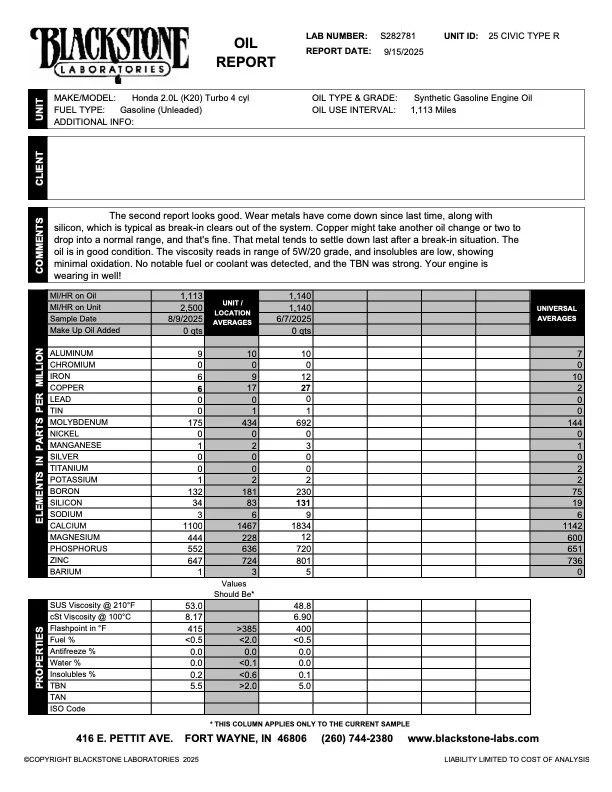

Here's my oil analysis:
- first test is oem Honda fill - driven about 1000 miles and drained for fresh oil ahead of my first track day
- second test is Mobil 1 5w30 with about 1100 miles mixed driving and 1 track day (Streets of Willow) - I would consider the track day to be a conservative/gentle track day since it was the cars first outing.
I was not surprised to see them say the M1 5w30 sheered to "5w20" with only one track day. It was a relatively hot track day at around 90 degrees, in Southern California.

Excellent - Did you Run Log R - do have the Log R data? - water temps when you ran that oil on track, that would be excellent to understand what temps you are hitting with thicker oils on stock car! Many thanks! Keep the data coming!

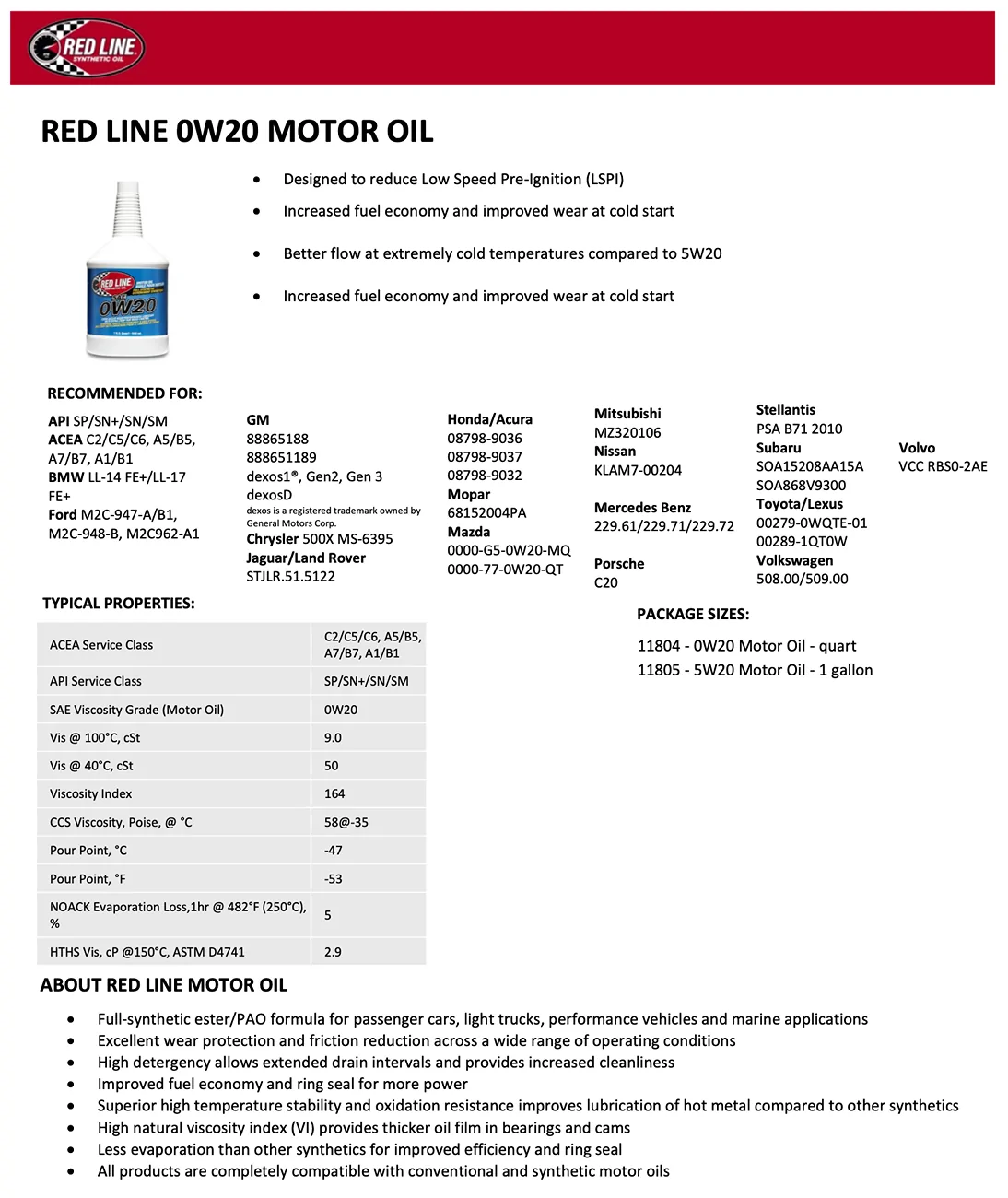

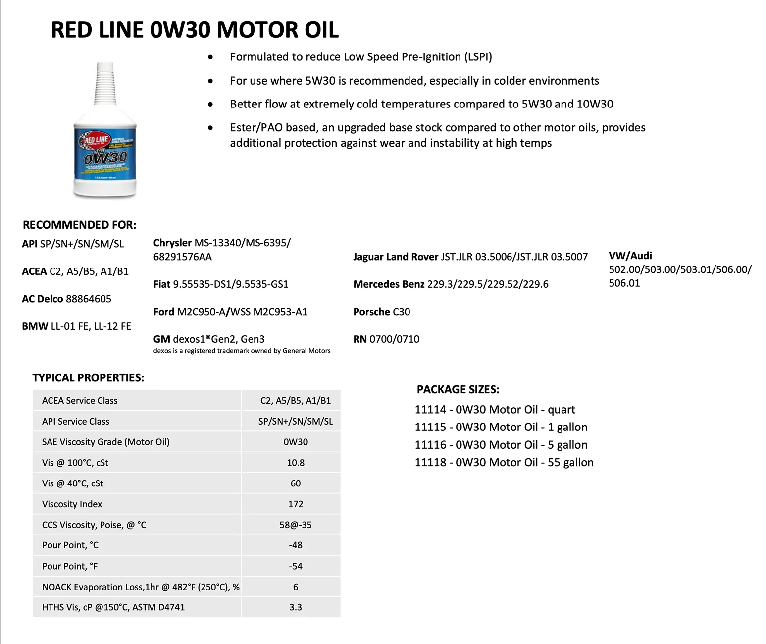

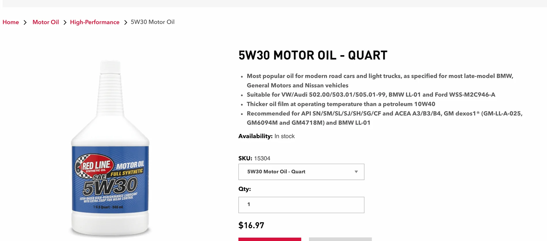

Watch out with redline 5w-30 - it's not formulated to API SP specs - no LSPI protection for direct injection - only redline 0w-20 ( thickest 0W20 available at 9cst at 100c ) and 0w-30 is API SP formulated - check the stats - I talked to redline - they didn't have an API SP spec 5w-30 yet.

I've very interested in the 0w20 redline, as it's at the highest CST for a 0W-20 and it theoretically should run cooler with the PAO Ester blend, and it last longer vs a pure race oil like Motul 300V - stays in grade way better. Motul Power 8100 maybe compatible to the Redline. It was proven to stay in grade longer and had very good results from the lab reports.

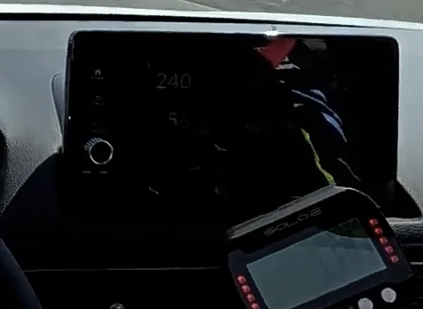

I'm not sure if I do, sadly. Unless it logged automatically - I'll double check if it's still saved in the car.
With PUP 5w40 euro in the car, I don't recall letting water temps go above 250 - water temps recovered pretty fast - when I saw water/oil drop down to ~220ish and I'd send it for another lap.
When "oil temp" got to ~ 275 degrees I would let off for cool down lap - it was "oil temp" that made me want to give it a cool down before water temp
Here's a couple of laps during the hottest part of the day where you can see temps in view:
ambient 100
"oil temp" 275
water temp 240

The highest water temperature I logged was 221°F — you hit 240°F? Was that while running Mobil 1 5W-30?
From what I understand, oil temperature readings can be misleading. The computer’s flow estimator often gets confused with thicker oil, and I’ve seen some reports of readings as high as 300°F. One thing I noticed, though, was after doing several oil changes with 0W-20, once the break-in oil was fully flushed out, my temps actually dropped.
We do know that thicker oil = more friction, so there’s a balance to strike. Interestingly, going thicker also showed a measurable drop on the dyno — about 3–5 horsepower. Not huge, but still noticeable.

it was with PUP 5w40
It went up to 240 water / 275 oil
11th Gen Honda Civic 🔴💊 Engine Oil Red Pill Thread: Only Post If You Have UOA - Official Honda Civic Type R K20C1 Engine Oil Analysis Screenshot 2025-09-16 at 9.53.13 AM
yep I understand LogR oil temp is a calculated temp - I hope to install an oil temp sensor along with oil coolers in the future
from everything I've seen in this thread, it seems clear that 5w40 isn't necessary... I may still stick with a 5w30 for my own peace of mind
Your cooler temps with 0w20 is also really interesting... it makes me tempted to try a 5w20 in the future
