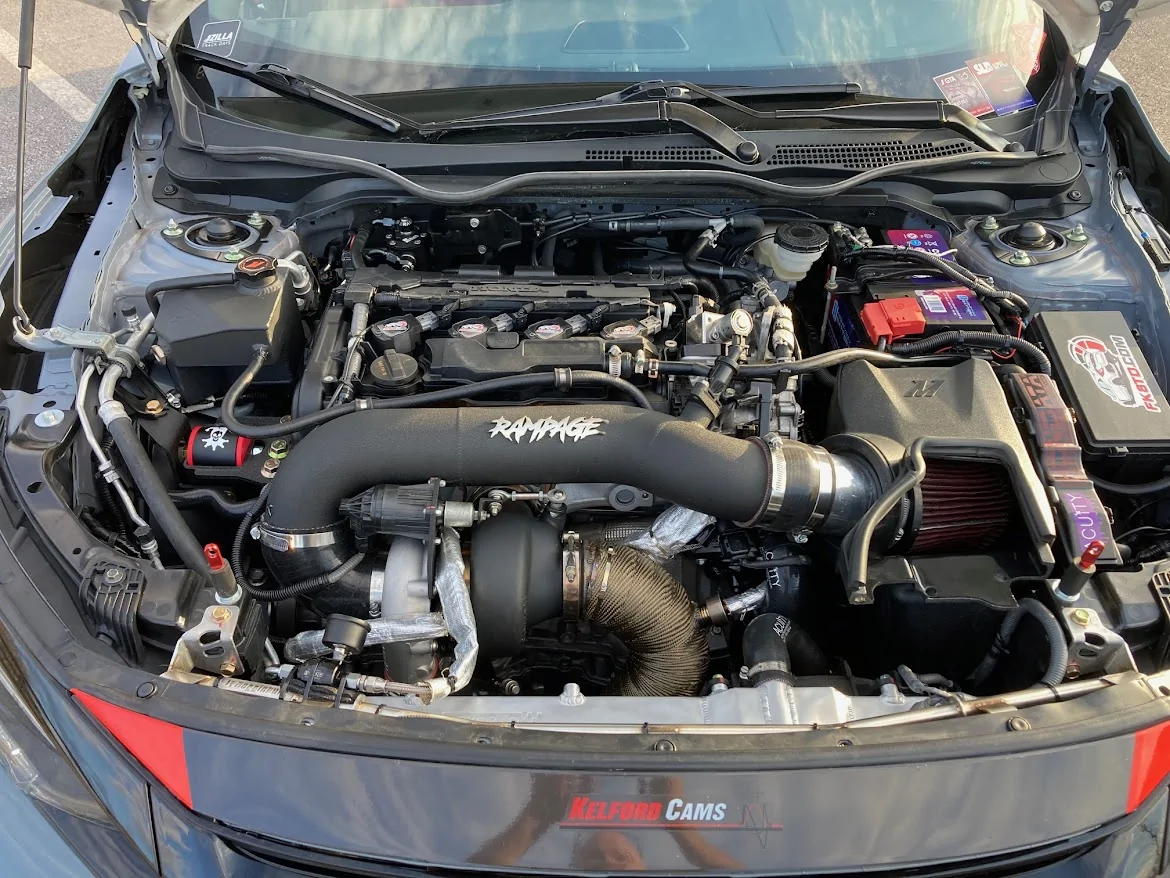

IIRC, youre running a 4piston engine too. Have you had similar issues with increased blow by? Do you vent to atmosphere?
I vent the "to turbo inlet" to atmosphere...long black silicone hose from valve cover going behind airbox in pic. I run the Radium PCV catch can.
11th Gen Honda Civic EVS BALL JOINTS OR WHITELINE BALL JOINTS FOR CAMBER? IMG_1617
I really never have had much blowby at all. But plenty of other issues :p

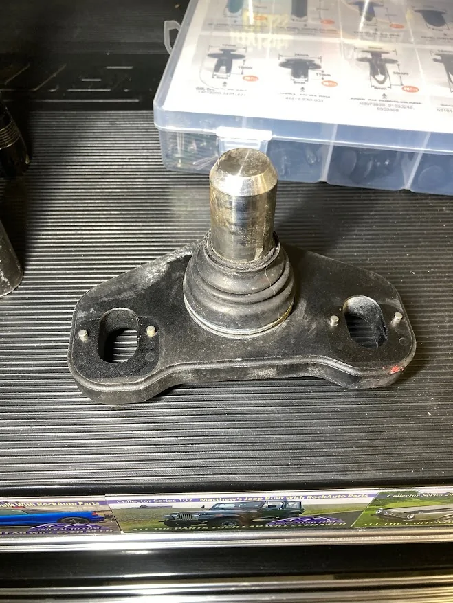

Ball joint pic for relevance. Installed Feb 11th and Failed June 15th after 2 TA races and 1 track weekend. But zero issues in the last 2 years!

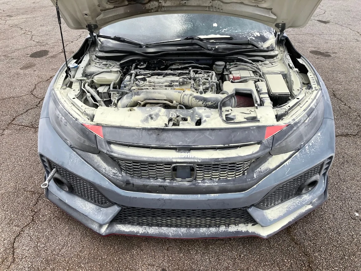

And one small fire in between...

Holy fire! glad you're safe! This is my biggest fear on all my project cars.

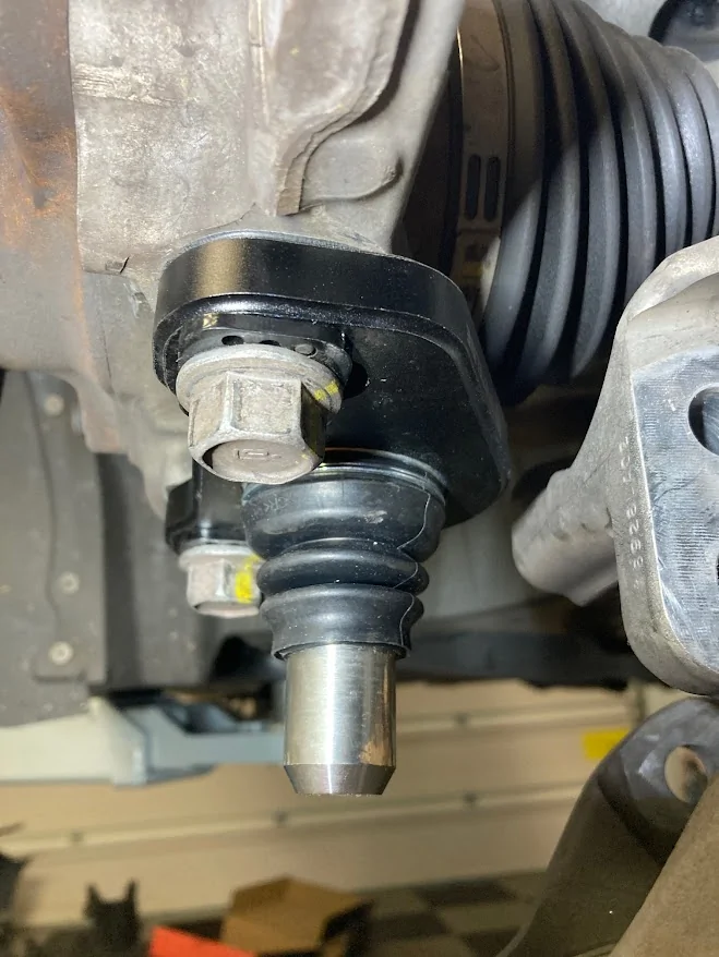

Fellas, I’ve seen written answers, but I’m hoping one of you that may do this often could post up a video of how you adjust the plates with pins after installation. I’ve got an alignment guy that was having a devil of a time with my type R. He’s a solid BMW track/ race suspension guy, but I don’t think he’s ever done a Type R with the Whiteline Performance ball joints with the camber shims. He essentially took it down to the knuckle to get the shim plates moved. I know there’s simpler way to make this adjustment from messaging with our Type R club, and I’m understanding that I/he should be able to just loosen the bolts below the shims and move them over, but I’m thinking there’s some sequence, pry bar, other bolt loosening action that I’m missing in translation that a video would illustrate. Appreciate anything I can share with him the next time around. Thx!
