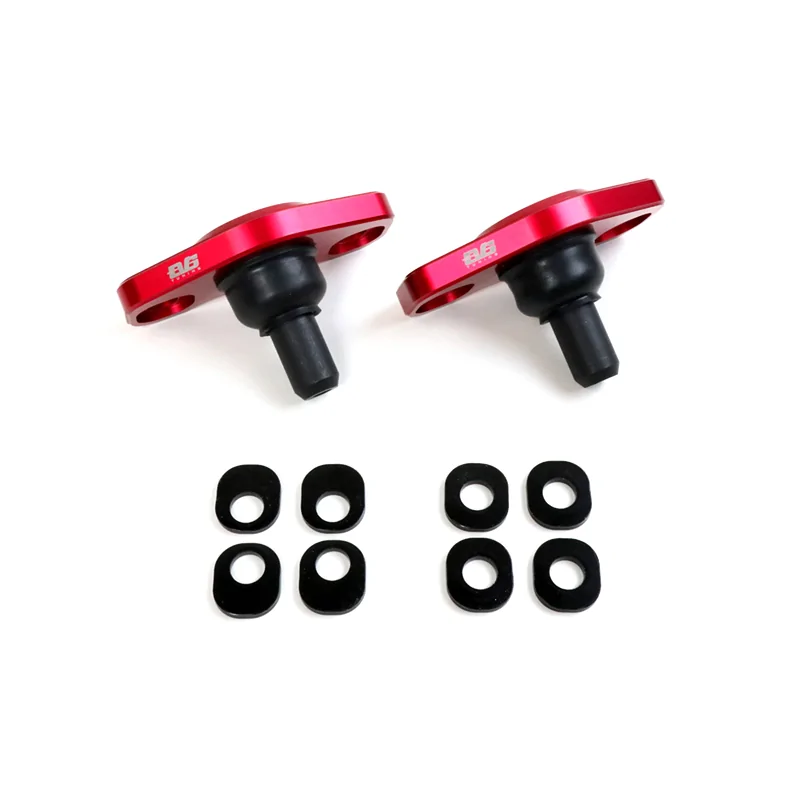

EVS:
11th Gen Honda Civic EVS BALL JOINTS OR WHITELINE BALL JOINTS FOR CAMBER? 1770314914701-m7
Also here's a quick reference point from Evasive Motorsports, who sell 4 different ball joints (i.e., 4 different vendors). It looks like J's Racing are virtually identical to the EVS, and Hardrace is the same design as Whiteline.
All are significantly more expensive than the EVS. I can't imagine this is a "get what you pay for" situation. Kind of interesting though.

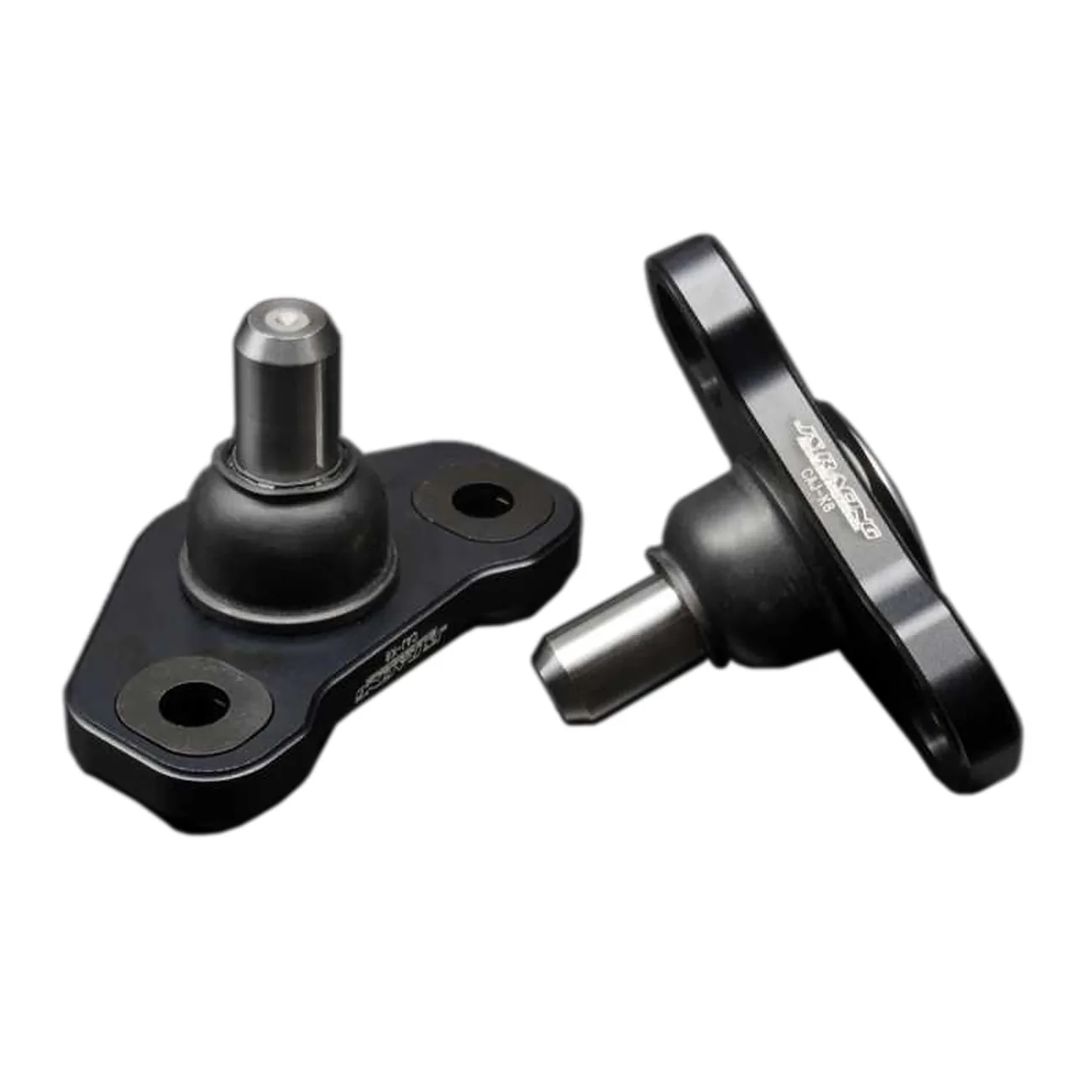

Js Racing which cost $400 - A company that doesn't make crap and just gets stuff made and adds $$$ to the price
11th Gen Honda Civic EVS BALL JOINTS OR WHITELINE BALL JOINTS FOR CAMBER? 1770316817476-hz

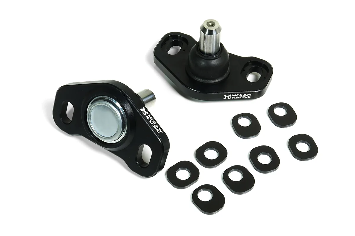

Megan racing (which are $50 cheaper usually than the hard race, a vendor told me made by hard race) - they are $250
11th Gen Honda Civic EVS BALL JOINTS OR WHITELINE BALL JOINTS FOR CAMBER? 1770316922641-8k
Thats why i say, but the cheapest ones as they are probably all made by hard race lol

thats a lot of good input and yea I understood what you meant. I went with the EVS options just due to price and getting the same end result when its all set and done. I love Whiteline and have their whole catalog on my sti. Great brand, great quality. I only went with EVS for due to price point and it giving the same result
