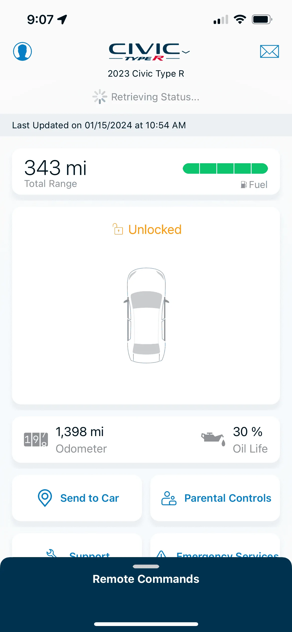

I’m surprised some people have like 7k miles without the maintenance minder screaming. I’m at 1,400 miles with only 30% oil life left. I’ll have to change it by 2,000 miles at this rate. Was hoping the minder would wait until like 4,000 or 5,000 miles, but it definitely won’t.
How long have you had your car? The MM takes time into factor and will usually suggest an oil change independent of mileage at about a year.
