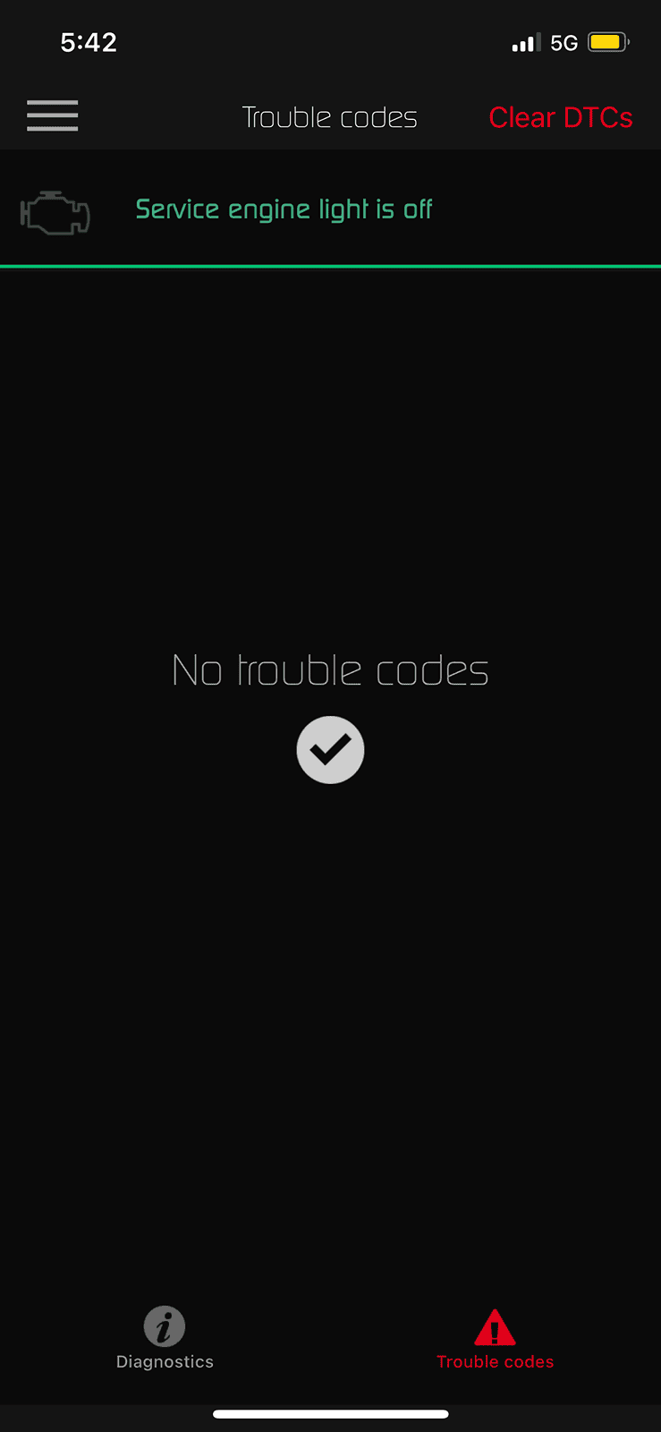

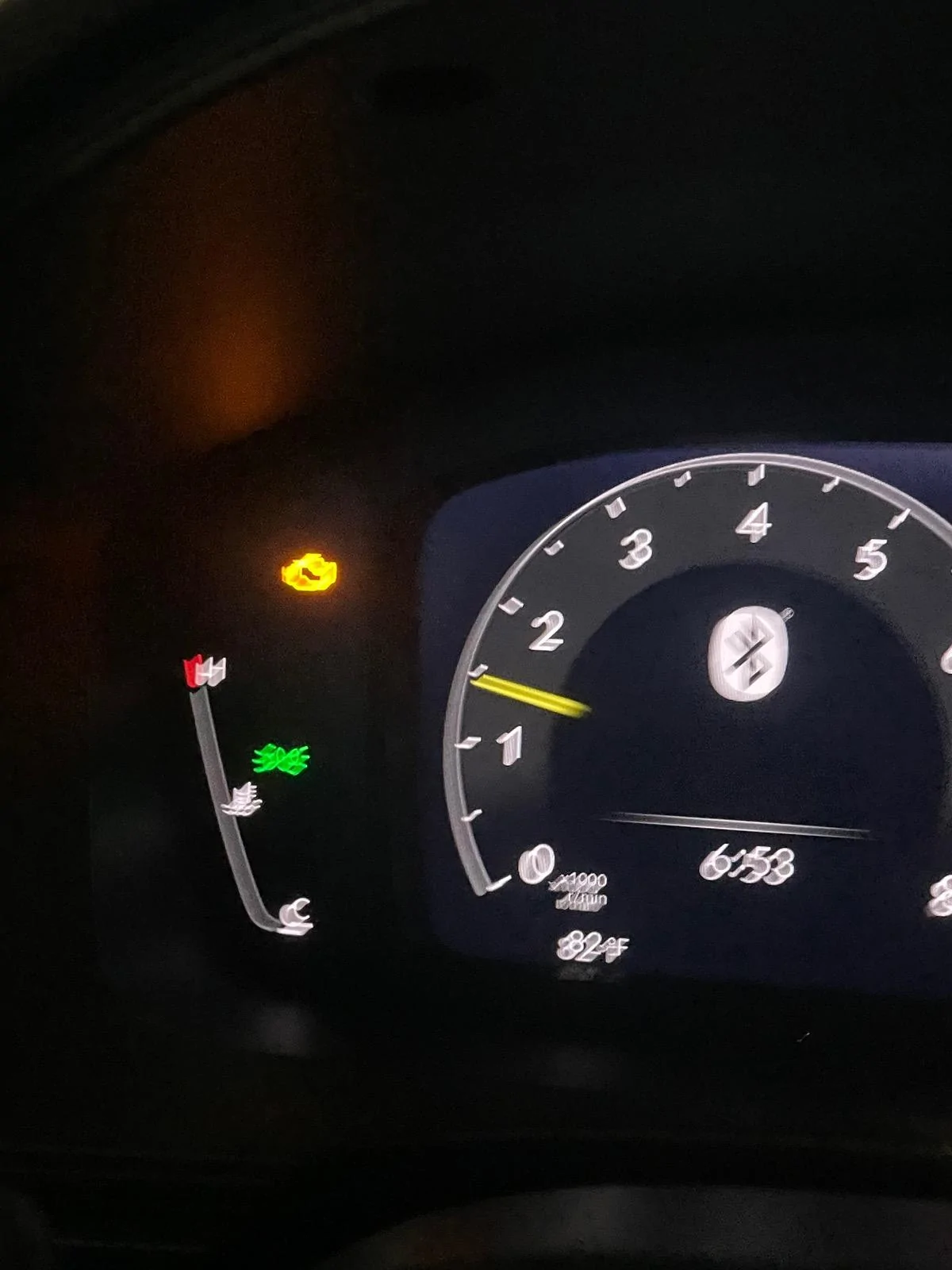

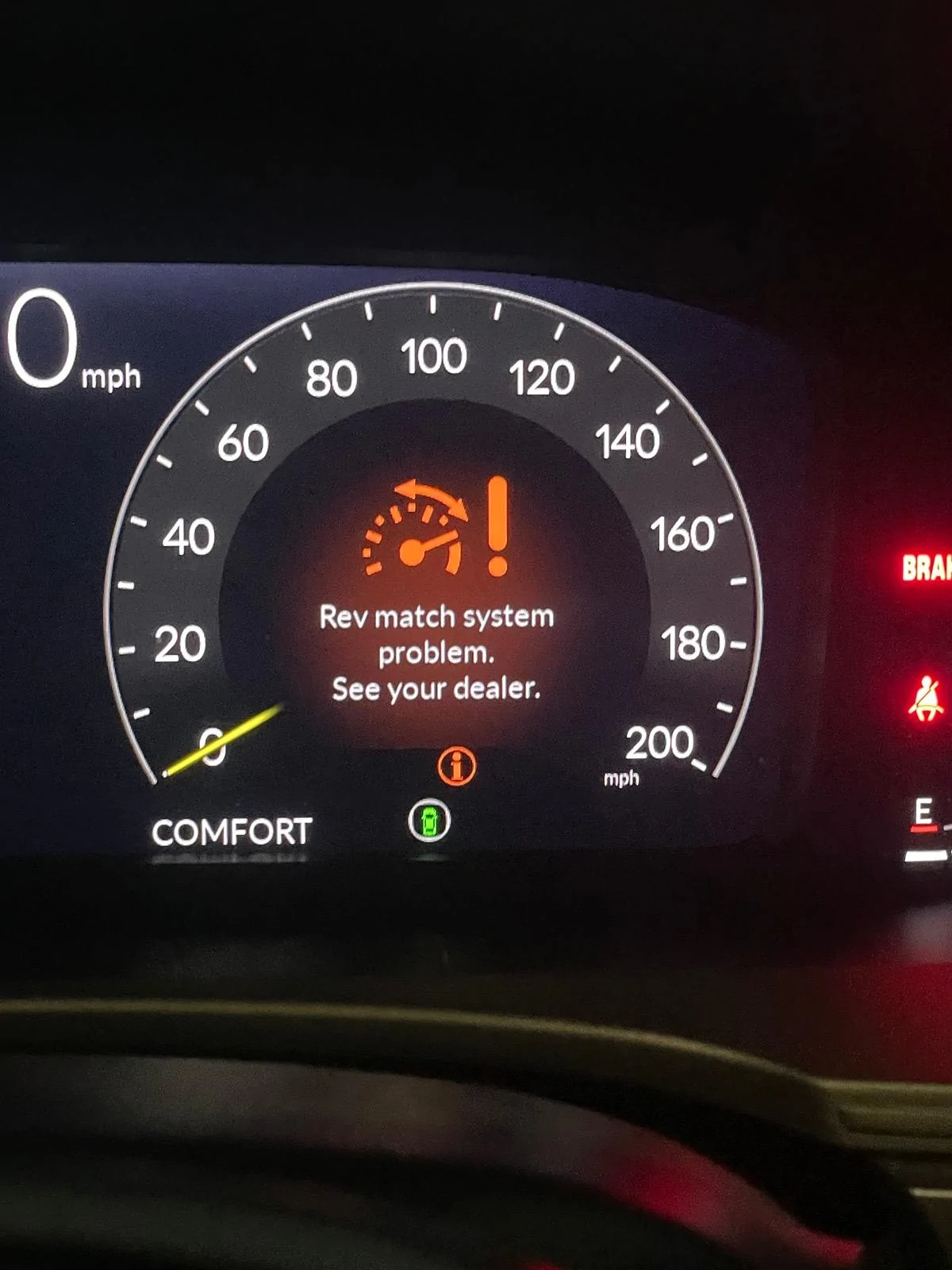

After trying to diagnose the cause of misfire codes in my car, my tuner adjusted the fuel trims, and the issue seems to be resolved. However, I recently noticed a flashing CEL without any trouble codes. What could be the cause? Is it just a random occurrence? My car is FBO/upgraded turbo with an Xdi hpfp and 1400cc injectors.

A blinking CEL signifies a misfire, even if there’s no code showing. It could have been a temporary misfire and didn’t register the P0300. If it doesn’t happen again, maybe it was a fluke.
It's happened twice before and no codes but prior it happened to P0300-P0304 codes would pop up.
