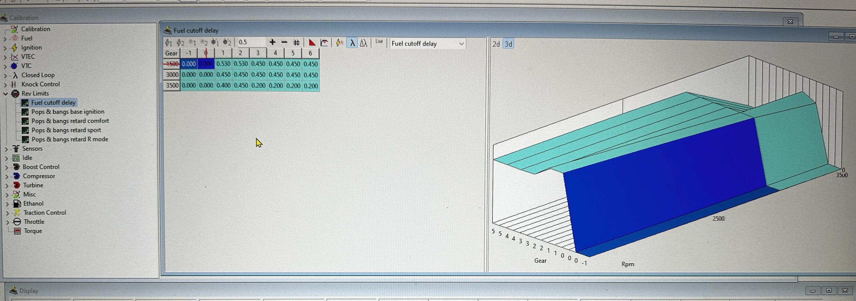

Hondata just released an update with Pops and Bangs for the FL5. 3 levels: DE5 style, Stage 1, and Stage 2. I'm not a fan of obnoxious pops and bangs tunes, but I uploaded their DE5 equivalent. I don't hear anything reving while parked. While head out on the road later.
edit: took it out and they are definitely there now lol
A quick adjustment will take care of that. The tables are zeroed out in neutral.
11th Gen Honda Civic Hondata FL5 FlashPro released IMG_3060

Also please when updating the software take the flashpro with you so the firmware can be updated on that too. It needs to be unplugged from the car.
Also on the software now you can control the exhaust valve at will no need to remove the fuse anymore.

Got it to work in neutral. By adjusting some parameters.

I tested this out this evening, I uploaded the “Stage 1” as I’m currently running AWE’s exhaust system with an aftermarket DP, and man! sounds like gunshots lol. Will test out the Factory Type S mod tomorrow, since this is quite loud and annoying for a daily driver. I’m hoping that downgrading to the Type S mod will be more of a consistent burble with less aggressive pops. Stage 1 literally has pops/bangs everytime I decelerate or rev match! So I can’t imagine how “Stage 2” would sound like with my exhaust setup.. I love how they mention “Please be responsible” in the description too haha.
Also can confirm, given that you don’t do any adjustments to the calibration and simply upload with the new mod, that Pops and Bangs only work when you are in +R mode, or if you’re in Individual mode, engine needs to be set to +R.
It will be less agressive with the type S version but you might still need to reduce the amount of timing retardation to not get it to pop as loud.
Definitely agree! I’m just trying to see how much of a difference it would be before editing any of the parameters.
But given my aftermarket DP and exhaust setup, I'm expecting it to still be loud. Adjustments will definitely be needed to further polish the sound.
Sorta out of topic, but very interesting to see “Added wastegate position and flow tables”. I would assume this would benefit Big turbo upgrades.
On your car it will be a must it will be loud either way.
Yes, on stock turbo applications they are already dialed in. But the wastegate tables look interesting as well as the compressor side tables.

Are burble tunes still bad for the cat, or is that a thing of the past? I still hate them, btw. Just curious if they’re still harmful.
Too agressive they will be, but an oem version that is mild will not be harmful. I’m doing a even more tame version for my car. Just want a very slight burble on decel.
